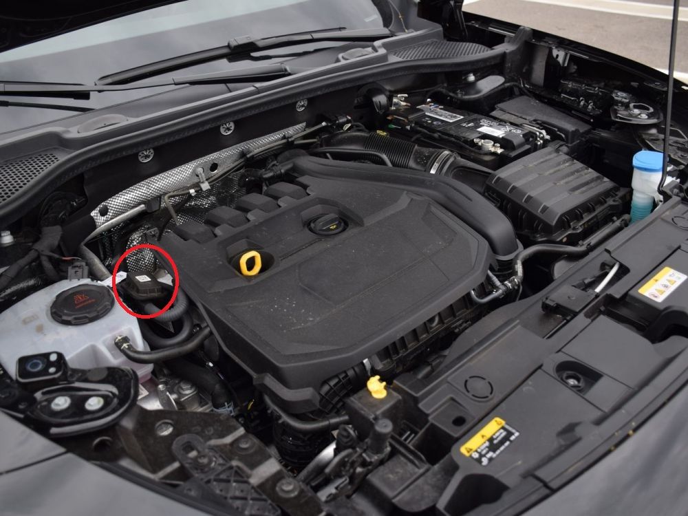

I went to my garage yesterday.
Appently they know this issue. They think it's this box (I don't know what it's for) who create some "static electricity" and make some noise in the cabin.
They will change it and i will tell you if they were right.
