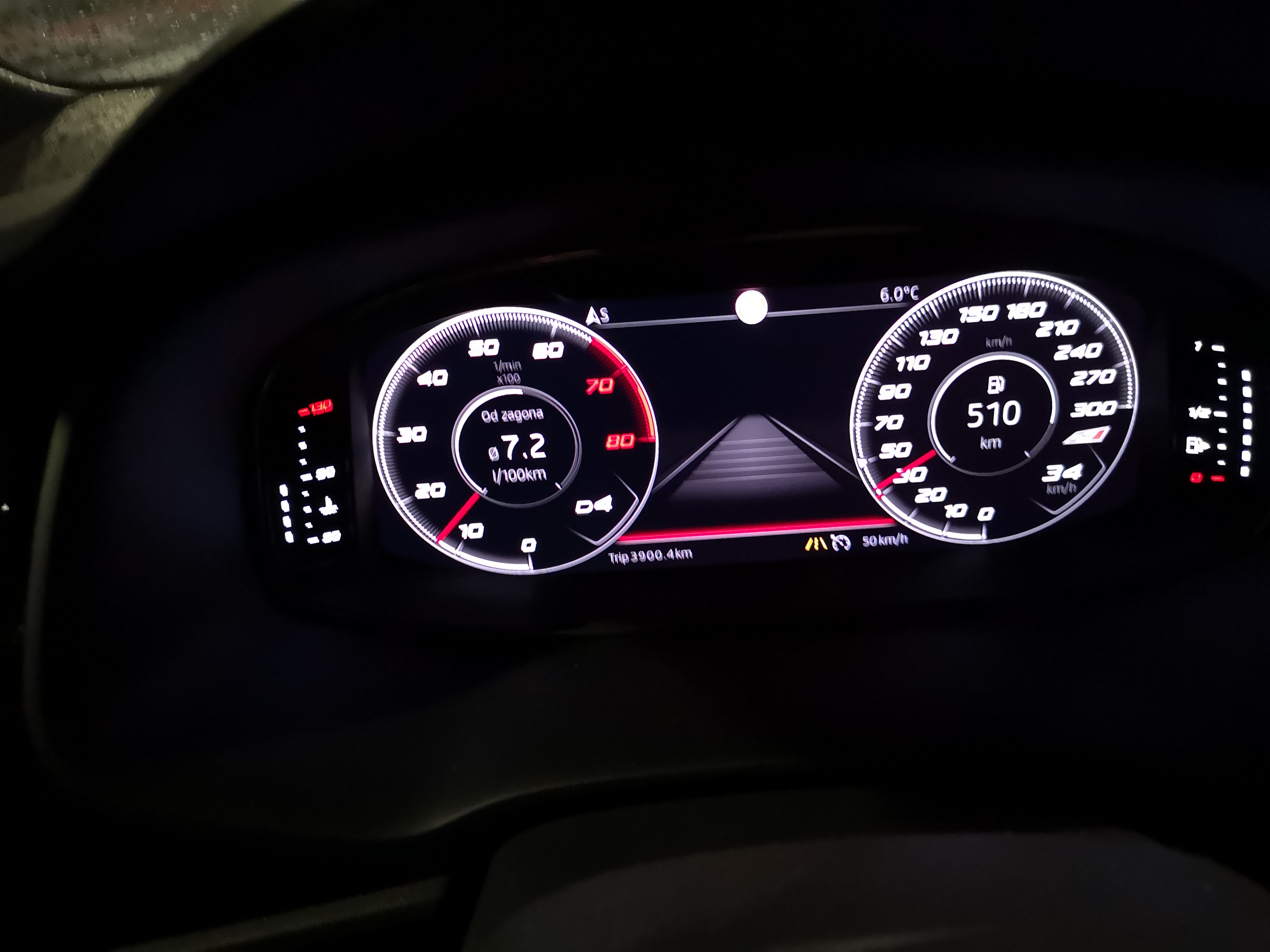

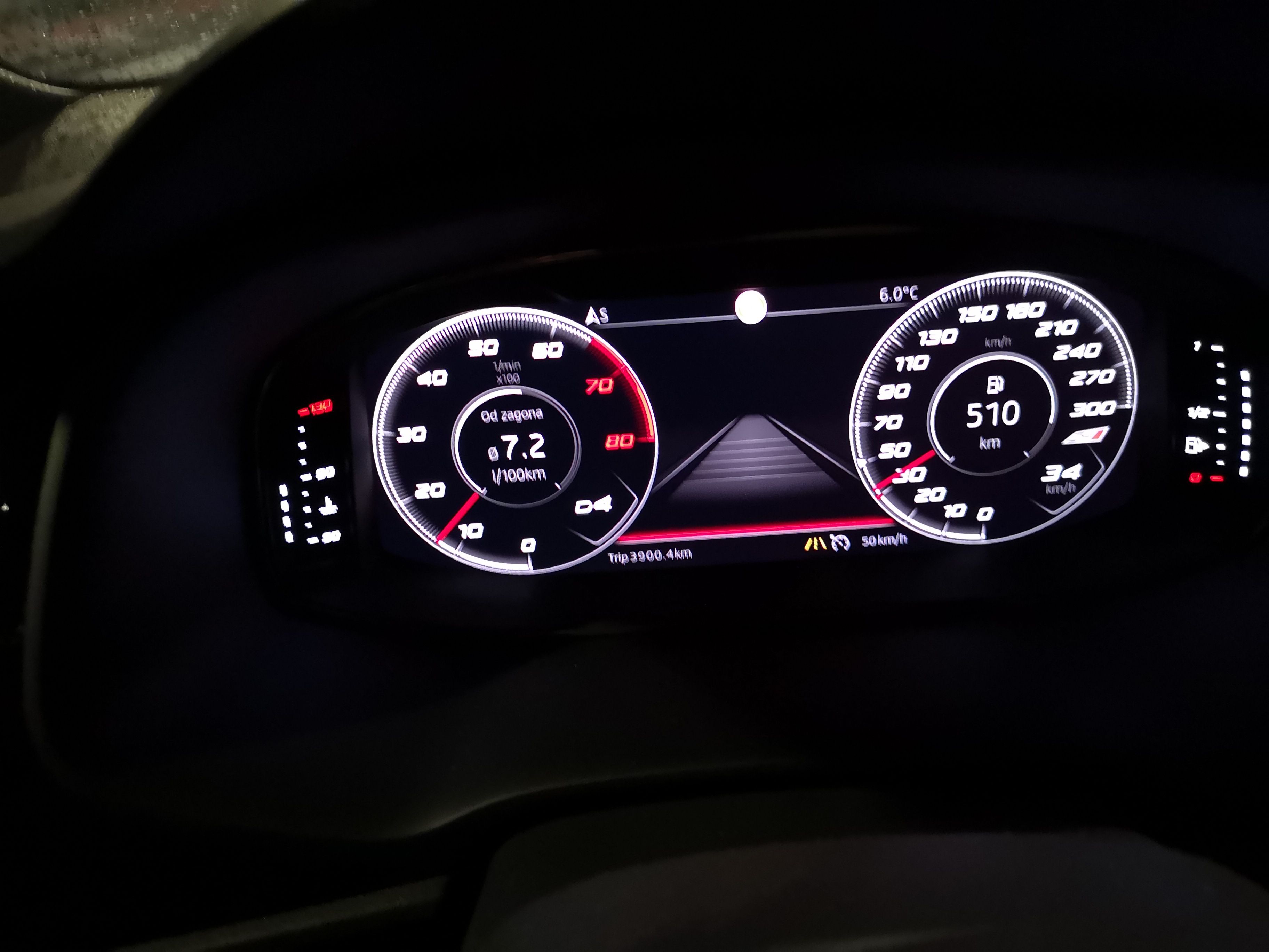

I have on left side setup average consumption from car startup and on right side range until empty gasoline:
You can setup this in vehicle settings on page where you switch between performance view ,offroad view and one of them is for dashboard settings and you can switch what will show you on centre of dials...
That's exactly how I have mine set up.
On the left where you have 7.2/100
Is this since car was new or since refill of tank?
I have long term showing on mine but would like per tank, but I can't find in the options how to change it.
Bring your central section of the screen to the same information, same place you can see oil temp and speed etc.
Once you have that up it will show 'long term'. Press your scroll wheel and it will cycle through, long term, since start and since fill up. As you change that the one to the left and/or right will change accordingly too.
Once you have that up it will show 'long term'. Press your scroll wheel and it will cycle through, long term, since start and since fill up. As you change that the one to the left and/or right rill change accordingly too.
That did the trick,
