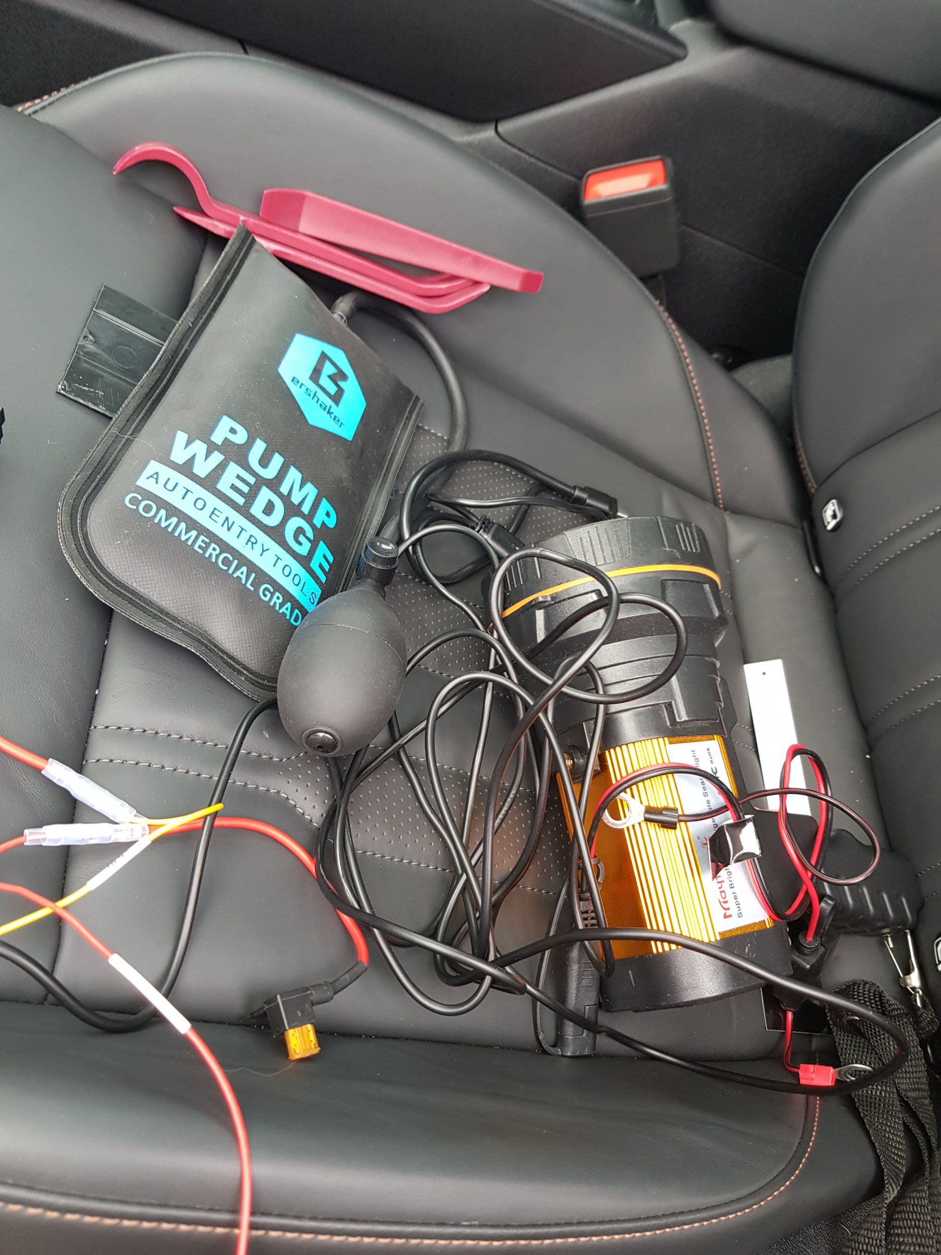

Did a dash cam install yesterday - well the front camera is in and the rear cable is installed up to the parcel shelf. Going through the boot umbilical is an adventure for another weekend.
I have found a hard earned few tips, which I shall divulge in the near future.
Yes Ive got a rear cam still in the box to fit. Was wondering the best route to get across to the rear hatch.
Will be interested to see how you get on!
