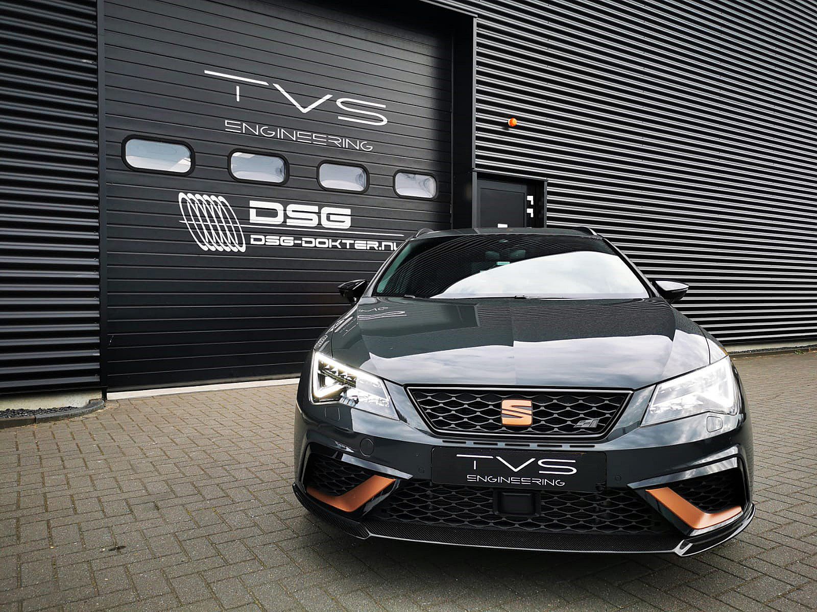

Making the appointment, they told me that for all I wanted they would need one full day and so it was: I arrived just before 9:00 and my car was ready at 18:15, after a full day work. Although everything was already spoken through, all choices in options were checked and confirmed again. I enjoyed following the whole process and was informed about every step. There were drinks and snacks and of course I wasn’t the only customer that day, so there was a lot to talk about.

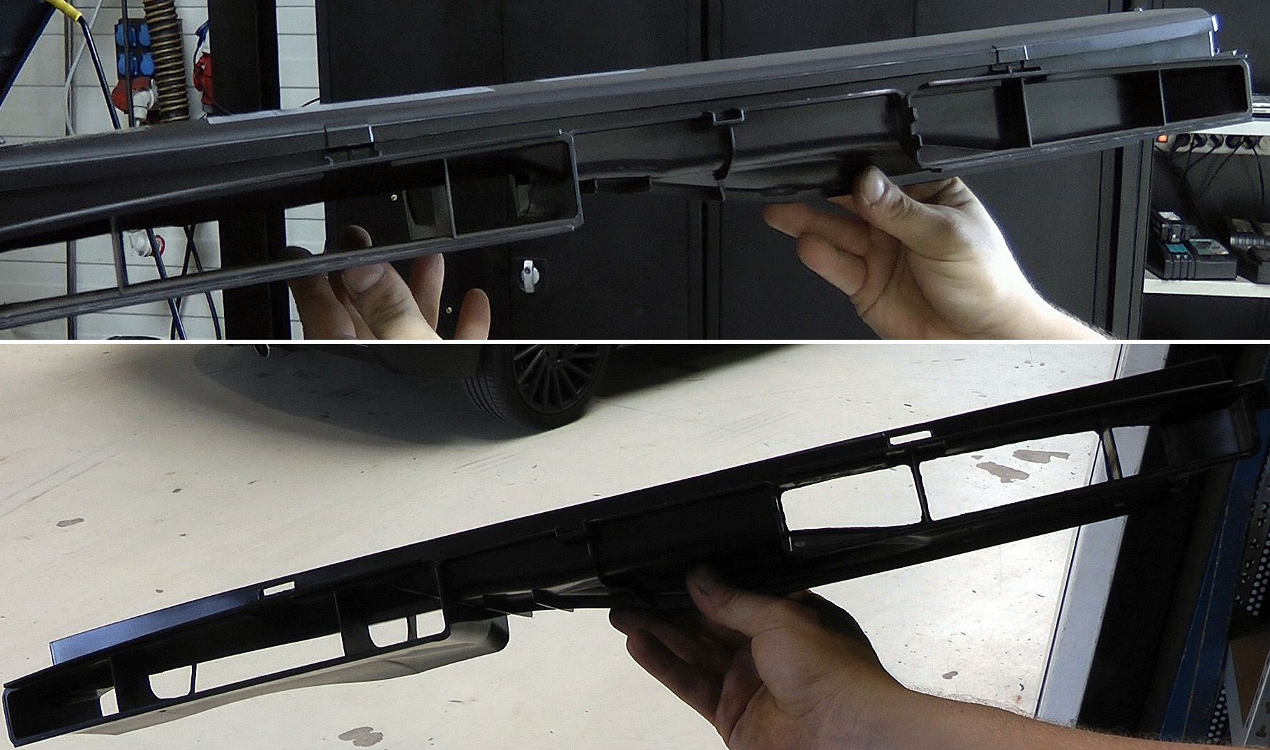

Let’s follow the inlet air stream, we start with the air intake: Seen from the front of the car it has some open sections, open at the front (cold air comes in) and open on the engine side (warm air comes in). From the engine side the openings will be closed with the blinding plate. On the right side are similar sections, but they are closed and will be opened now to let cold air in from the front. Holes were drilled and the middle sections were cut out. The sides were nicely smoothened. (See pic: on top the stock air intake, below after the modification, the engine side on the left will be blinded to make it a cold air intake.)
From the now cold air intake the incoming air enters the filter housing and is partly blocked by the snow grate, that covers a big part of the filter panel surface. That snow grate is removed.
Then the air goes through the OEM paper flat panel filter, that is now replaced by a K&N filter with oiled cotton in multiple layers.
From there the air flows through the OEM plastic pipe with flexible harmonica sections. This is replaced by the Racingline hose, made of silicone. I’s a bit wider and much smoother, without harmonica sections.
Then, just before the turbo, the air enters the plastic OEM turbo inlet elbow. This is replaced by the aluminum Racingline elbow, which is again a bit wider and smoother than the original one.
While working there, at the same time the OEM diverter valve (again made from plastic) is replaced by a aluminum made Forge recirculating valve. Not for more power, but for a more reliant working on the long run. I could have wait for when replacement was needed, but I choose for doing it together with the tune.

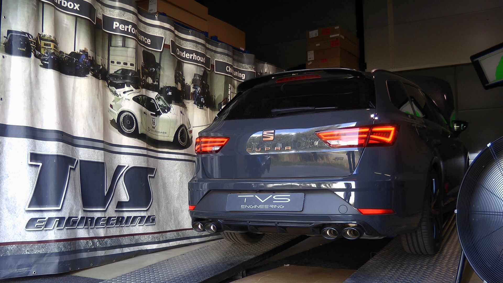

After all this was done and after warming up the car, it was moved onto the dyno again. I was very curious what these changes would bring. I was not disappointed at all, on the whole rev range there was more power and torque. Measured was 327 PK (+23 PK) and 421 Nm (+13 Nm). This is 322,5 HP (+22,5 HP) and 310,5 lbft (+9,5 lbft). Plus, above 5800 RPM both graphs kept on going before dipping at 6400 RPM now. A nice result I think, without any remap till now.
At the same time all the above was done, both custom remaps for ECU and TCU were built. Based on the original maps, their huge experience with these engines and DSG’s, plus my wishes in options. The re-flash was done and the car could be tested, both on the road and on the dyno. The read outs were inspected and adjustments were made in their computers, because results are close, but never perfect the first time. For fine tuning this whole process was repeated a couple of times, making little improvements.

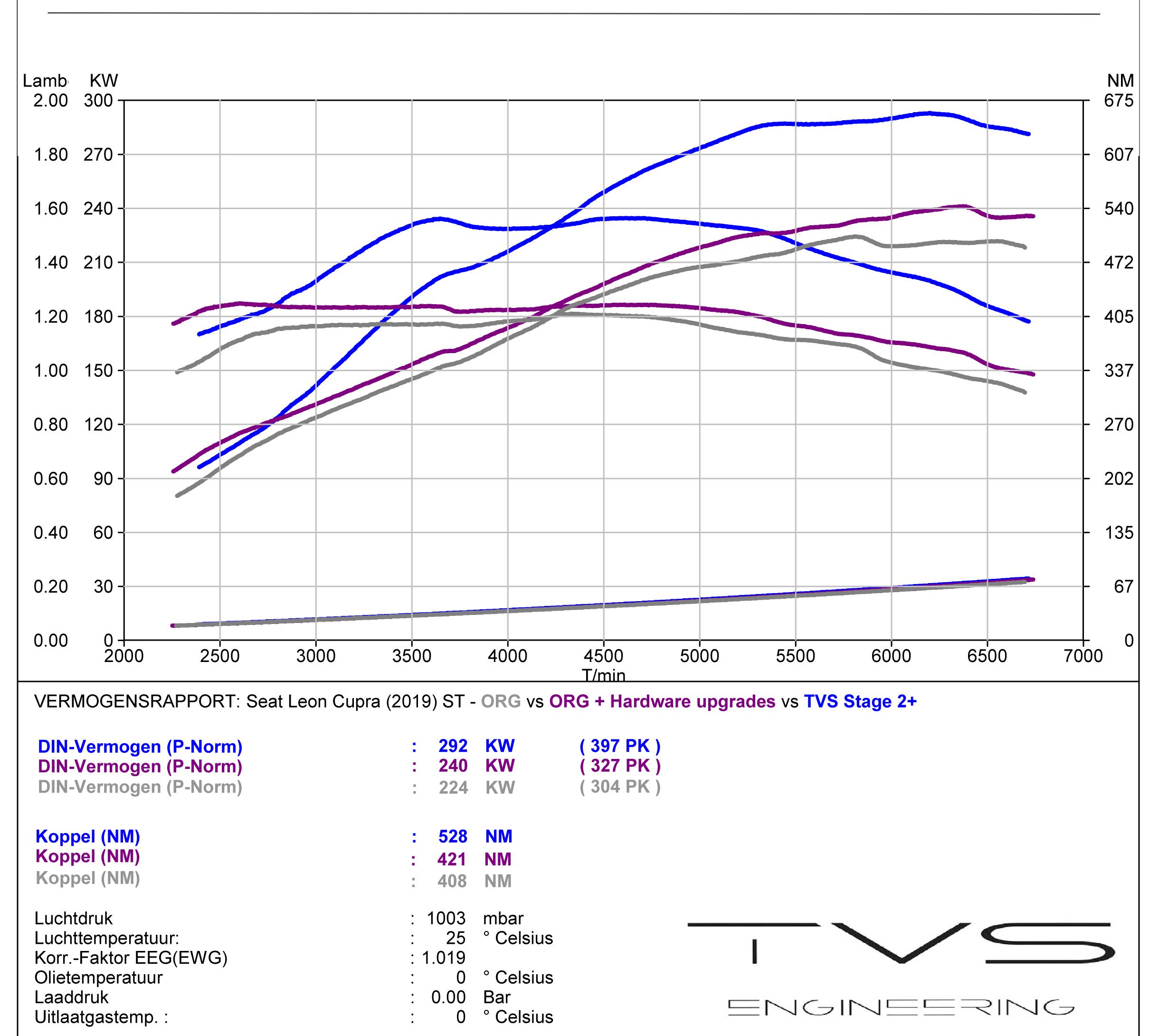

In the dyno graph above you see three situations compared: the grey lines and values are from the stock engine, the purple lines and values for the stock maps with hardware upgrades, the blue lines and values for stock engine with hardware upgrades and custom remaps for engine and DSG.
The final dyno results showed an impressive 397 PK (391 HP) and 528 Nm (389,5 lbft)!
Which is a gain of +93 PK (+92 HP) and +120 Nm (+88,5 lbft). This was measured with 98 RON petrol (BP Ultimate), which I always use.
And this result is without bigger downpipe, de-cat, GPF delete, other exhaust, or bigger intercooler. That’s all still stock. Looks like a very good result to me, what do you think?
How does it feel after this tune? Cruising around in traffic goes just as easy (maybe even easier and smoother) than before, but powering up with so much extra power makes me smile and grin every time. This tune makes my already very fast car even faster, a lot faster. It makes it feel much more alive. The difference is even bigger than I thought.
