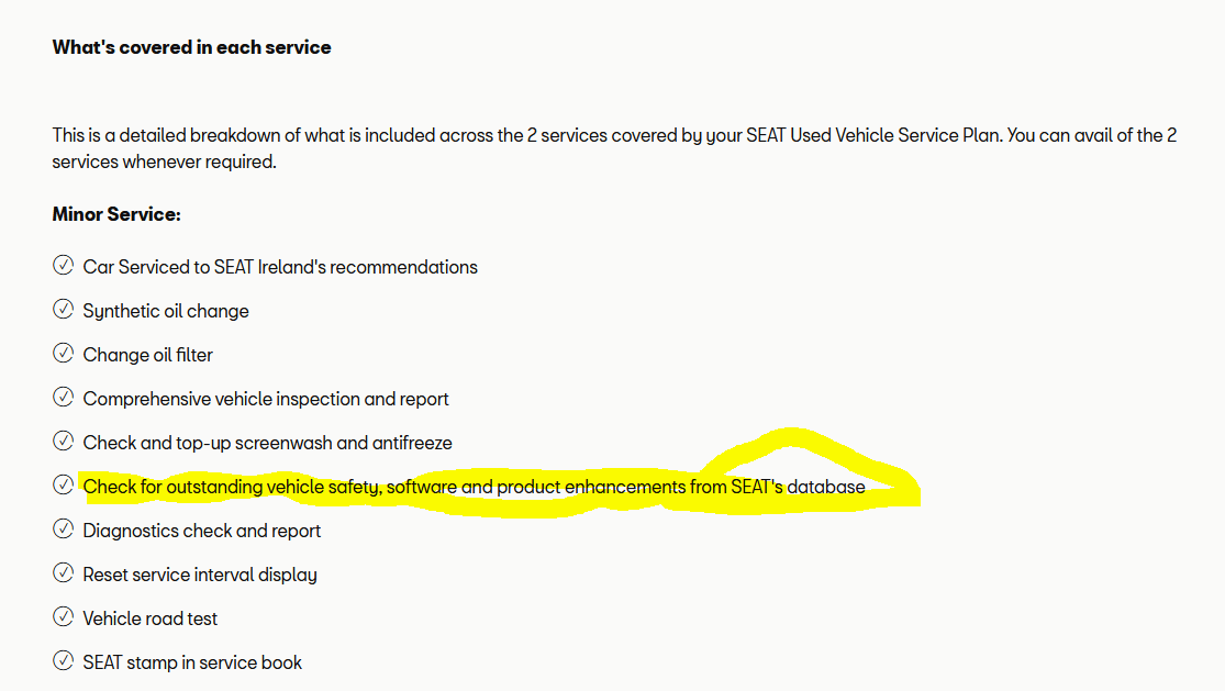

After talking to the dealer where I did the last service, they don´t check for updates in every service they do because, and this were her words, because "it could take up to 3 hours to do the update". Even though in the service plan is included to check (not sure if is just check or install too) and they never told me there is a new update. So when I asked her if it could be updated she started asking if I had any issues with the car, So I basically told her I had the "yellow light for the fog light a couple of times", so now I´m booked for updating the car and have to pay 70€. All this is in Ireland.
I sent the car back to the dealer to have a leaking rear screen washer fixed - I emphasised that I wanted the software updated to benefit from bug fixes and enhancements, even if there was no fault. The dealer is helpful and honest, and he told me their system does not show software updates as being available unless there is a fault code present - so they created a fault to trigger the software update.
You're 100% right that it should happen during service (or better still, OTA) - all customers should benefit from VAG's ongoing bug-fixing and enhancement of MIB, not to mention any improvements to engine & battery management or stability / braking systems etc.!
