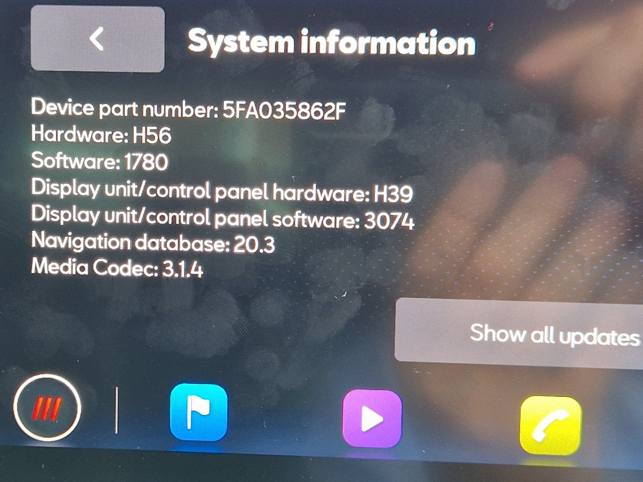

Totally agree with software, mines two weeks old and came with 1900 but still has infotainment random crashes. It's booked in next week for an update.
