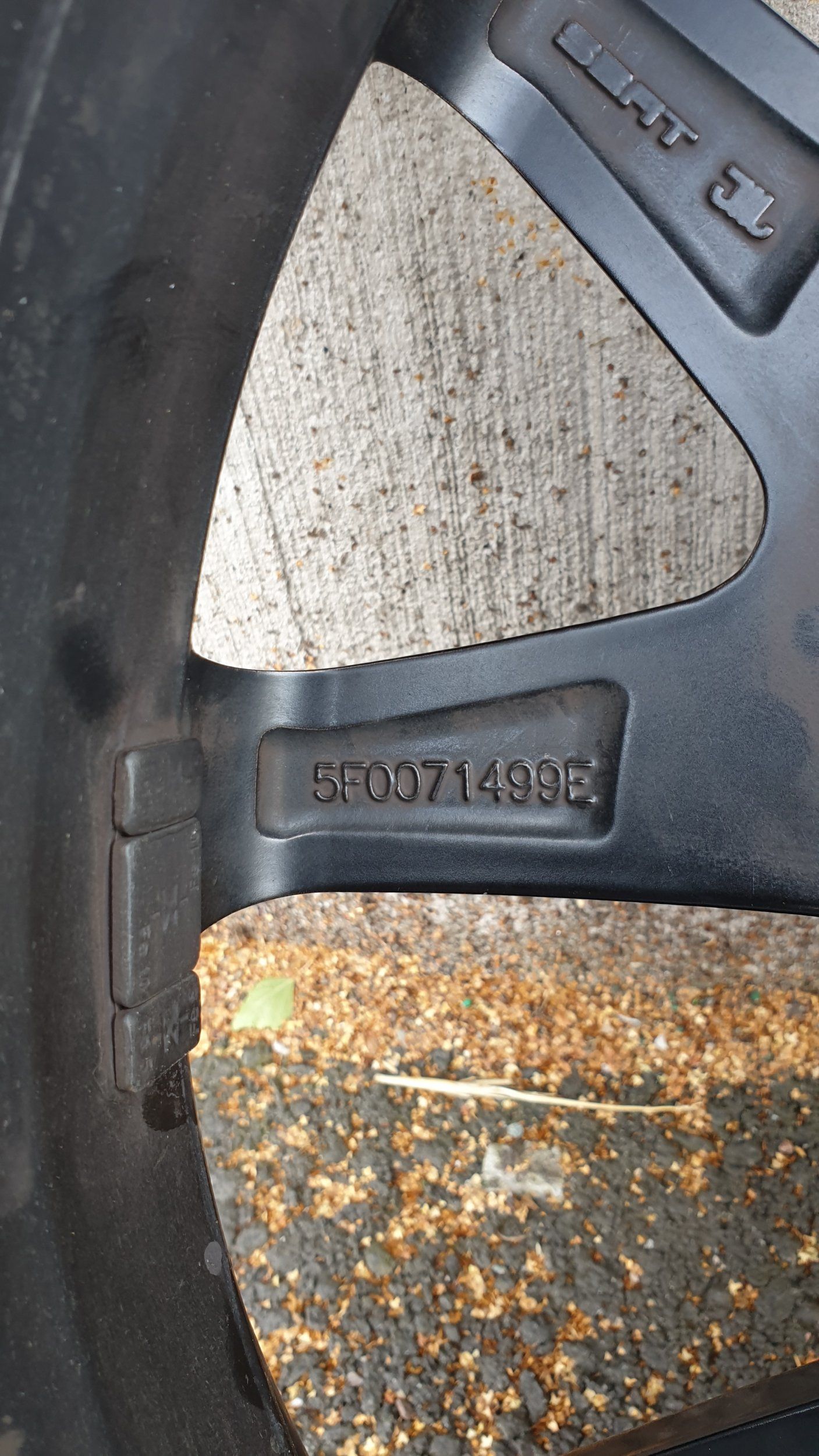

You have another OEM alternative with ET40, also from Cupra R, not ST but the 2018 hatchback. Just a suggestion :).
As you can see from the backside it’s ET40 and the item no 5F0071499E. Then you can skip the spacers. I have bought two of them and used this Item no as a spare part when I scratched them a couple of years ago.
