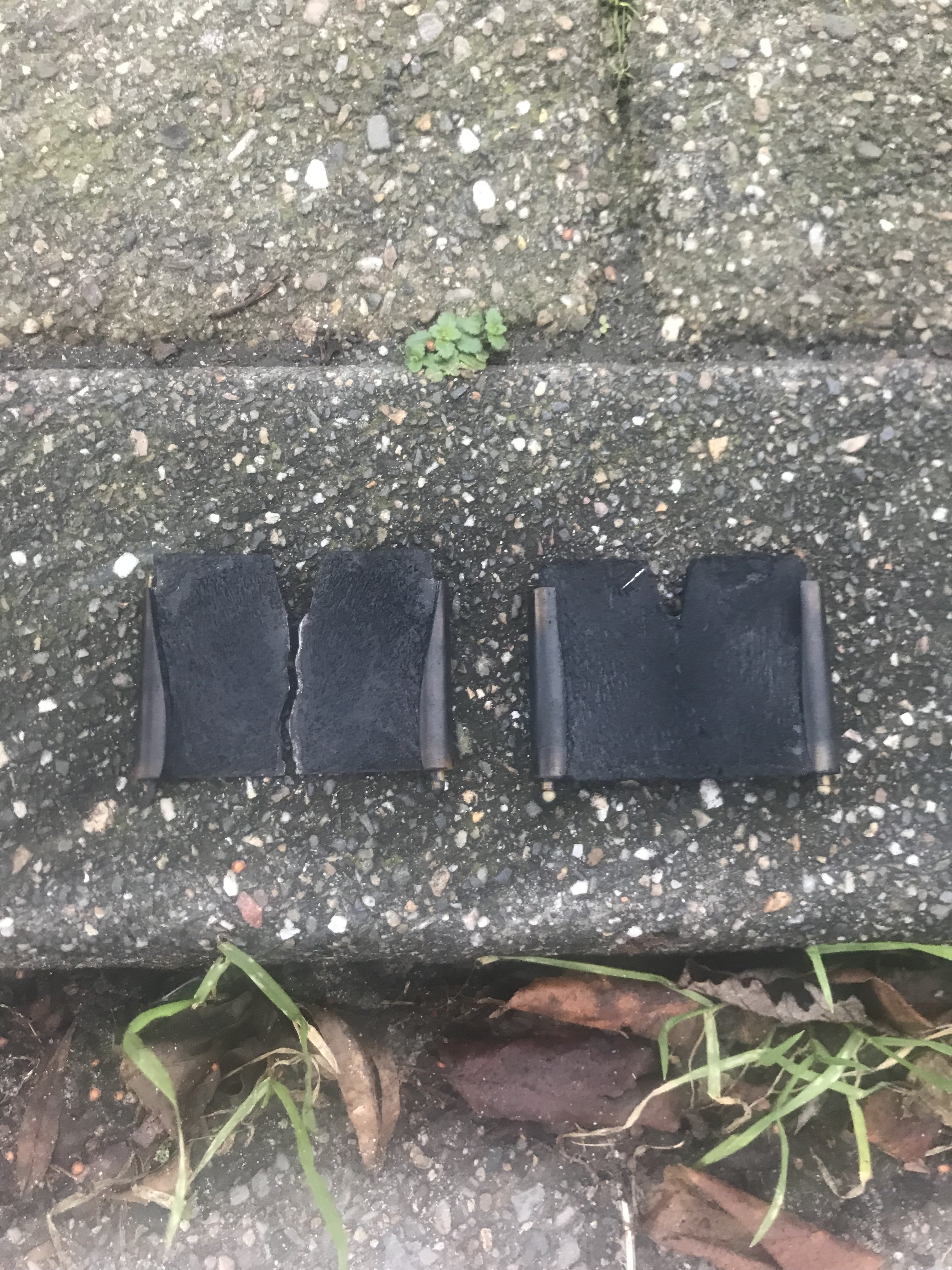

Oh and i removed the metal inserts from inside the head as one of them had snapped in half from excessive carbon build up!
Must of been very lucky tbh!
