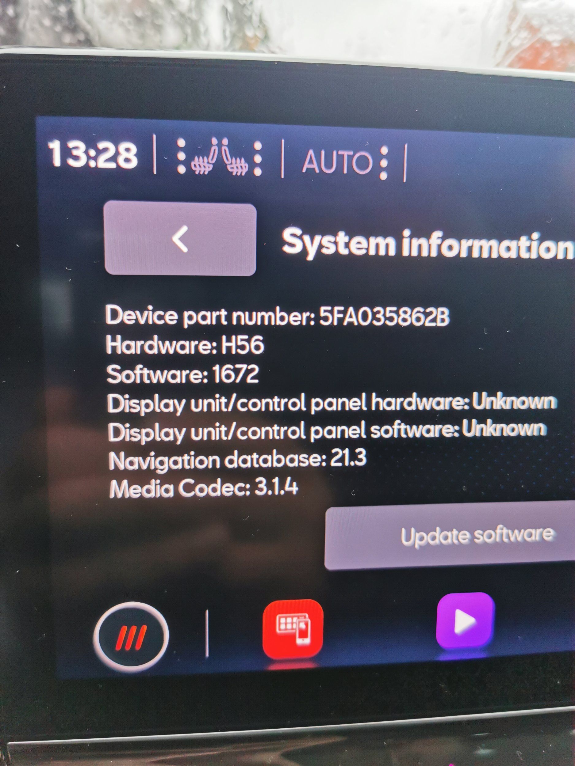

Am I behind the times with 1672? This is after getting it back from the dealer with all updates applied?
My (limited) understanding is that the latest OTA version available is 1790, and that 1803 is available at dealers only, but for a limited VIN range (mine is outside this).
As you have a revision B unit v1672 is the highest software you can get.
Ive got this on mine and there currently is no further upgrade.
The v17xx and v18xx upgrades are for later revision units.
