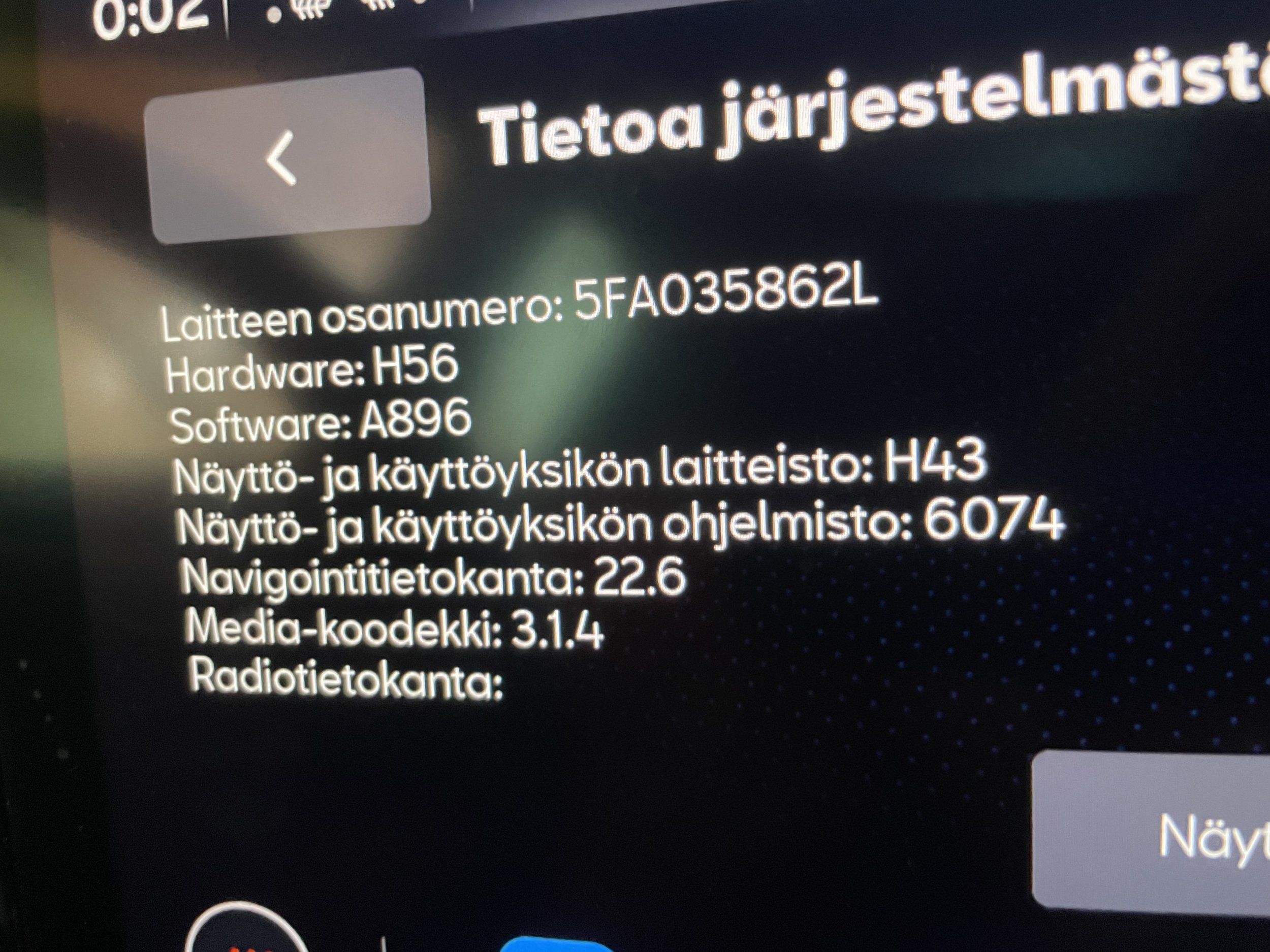

No ties to Cupra can be established. I take the car to the dealer again for charging and get a temporary car. When they started the car, I managed to see the version of my software, why such a strange number?

Hi, that software A896 is an OTA (over the air) update that came out last year. I had 1896 installed by the dealer last year in May. A896 & 1886 are basically the same. I think Cupra stopped pushing the large OTA updates due to problems.
The dealer said they don't see any new updates for my car. The only thing I can try when I pick up the car is to check if there are OTA updates. 🤷‍♂️
Sounds like you're being told some untrue info, unless things are different in your country 🤔.
After 1896 (A896) there is 1899 (not available OTA). Then the big fix is 1940.
In the UK this is available to all Formentor models.
