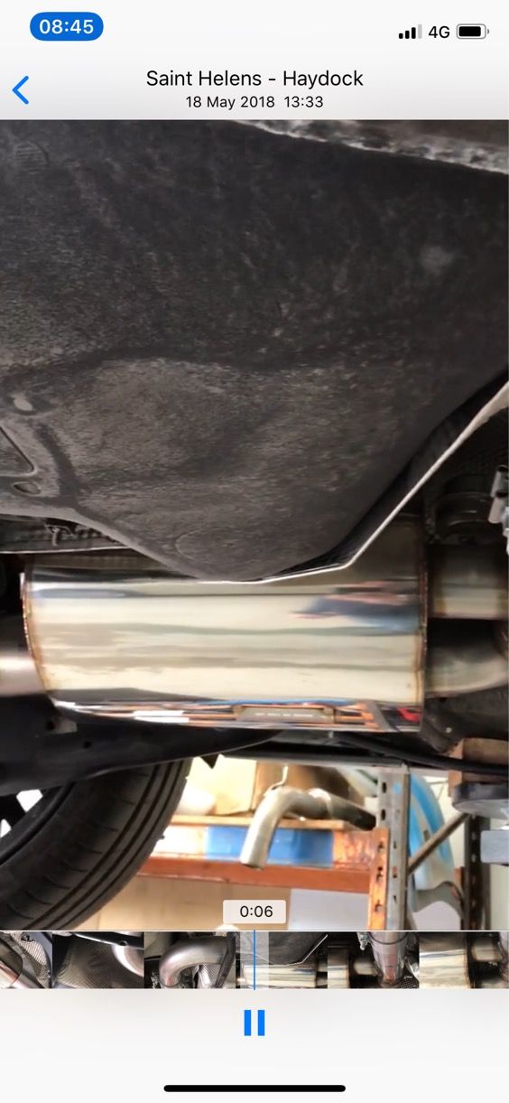

First impression it sounds a lot more refined and defo louder than stock, however, not louder than the original res delete I had. Tbf it will need bedding in a bit as it’s from a water damaged golf r estate. Just need to go for a drive now see whether I get dsg upshifts.
Couple of pics for reference.
Next to each other
Cutting of diffuser required.
Part number for reference
It appears the resonators are the same.
Videos to follow shortly.

So yes this was the 4 drive version however I should think from the t piece backwards it should be the same. Now I asked Ross @ RPS what the part numbers are for just the twin exit back boxes, which are
5G9253609BB - £212.06 inc VAT
5G9253609BC - £212.06
I think the price is bloody good, close to the miltek cat back price. However I like keeping things OEM.

That’s the MQB Chassis for you, they are the same between the golf r estate and the Cupra st. It is strange how it’s offset though. Been out driving it the last few days, and WOW the dsg pops are so loud. Not much overrun noise. Can’t have it all though.... they are drony at idle more than stock. So I can see why @Damoh removed his res delete. The drone would be stupid.

Diffuser after cutting, not brilliant ended up cutting it to work out I could heat it up and bend the plastic to match the old style.
Fitted

First video of interior sound. Due to the absolutey abismal weather I haven’t had a chance to do external videos.
Enjoy for the min will get some uploaded when the rain dies down.

The golf R/4drive exhaust will fit a FWD. it just doesn’t take as direct route as the none 4drive.
The resonator is further back (and a different shape) as the FWD doesn’t have a prop shaft in the way. The hole underneath where the resonator sits is still there. On my 280 ST, the BCS/Powervalve exhaust had it’s only back box where the 4drive resonator sits.
