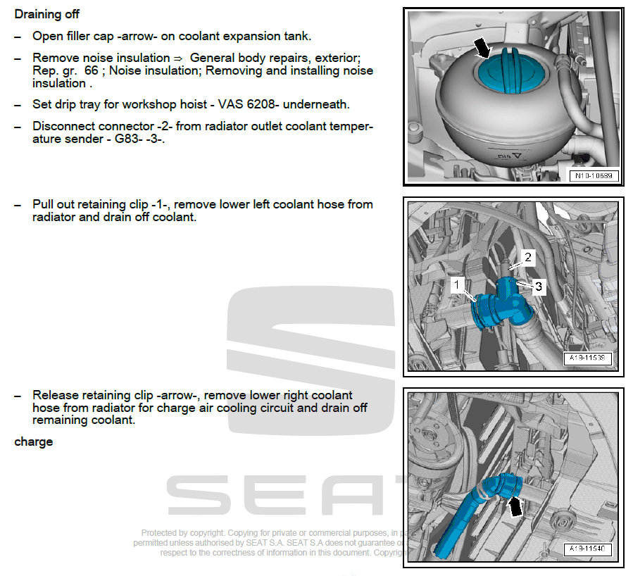

So looking at this manual:
Just remove under-tray, both lower hoses, and the filler cap.
To flush some water through I would connect my hose upto the lower pipe from the header tank.
Thanks so much for your help...I did eventually find those pages prior to you posting but nevertheless I'm grateful for you validating my findings. Couple of questions for you.

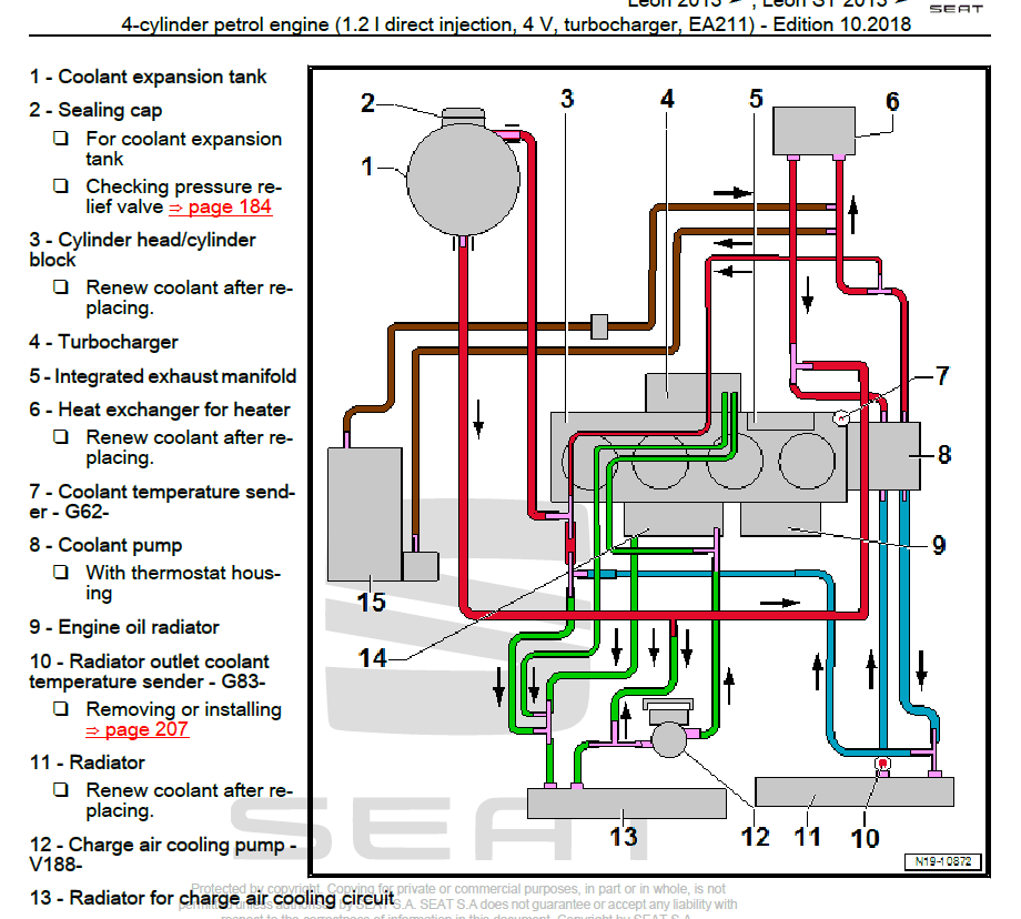

In the first diagram you posted
I assume thats me looking at my bonnet head on? As that is where my expansion bottle would be, ahead of the steering wheel?
If #11 is the actual radiator I need to remove the hoses from, what is #13? Is that to do with AC system?
In the step by step pictures, presumably that's showing item #11 in the diagram? As both item #11 and #13 have two hoses on them.

1# Yes, but bear in mind it's just a schematic showing pipe routing - so actual placement of parts might be off a little.
2# 13 is the charge cooler radiator - also has coolant in it.

4# With to 2x lower radiator connections removed - I would either put your hose gun in the header tank and fill, or like I mentioned previously disconnect the lower hose from the header tank and connect your hose directly to that hose. I would disconnect each of the 2x lower radiator hoses at a time, then reconnect, to try to minimise air getting in the system.

#2...even though #13 the charge cooler radiator has coolant inside it, that's not be flushed? And looking at it head on #13 would be ahead of the steering wheel on the driver side?
What is the difference between the charge cooler radiator and the radiator? Is the charge cooler radiator for the AC only and the radiator for the heater?
#4 you introduced a new term, header tank, do you mean the expansion tank as referred to in the guide you posted? I don't quite understand yet what you mean about how to connect to the hose...hmmm
The charge cooler radiator also uses the same coolant and so should also be flushed. This is just a heat exchanger (radiator) for your inlet air cooler. Nothing to do with your AC.
Yes by header tank = expansion tank - the tank with the cap where you check/fill your coolant.
