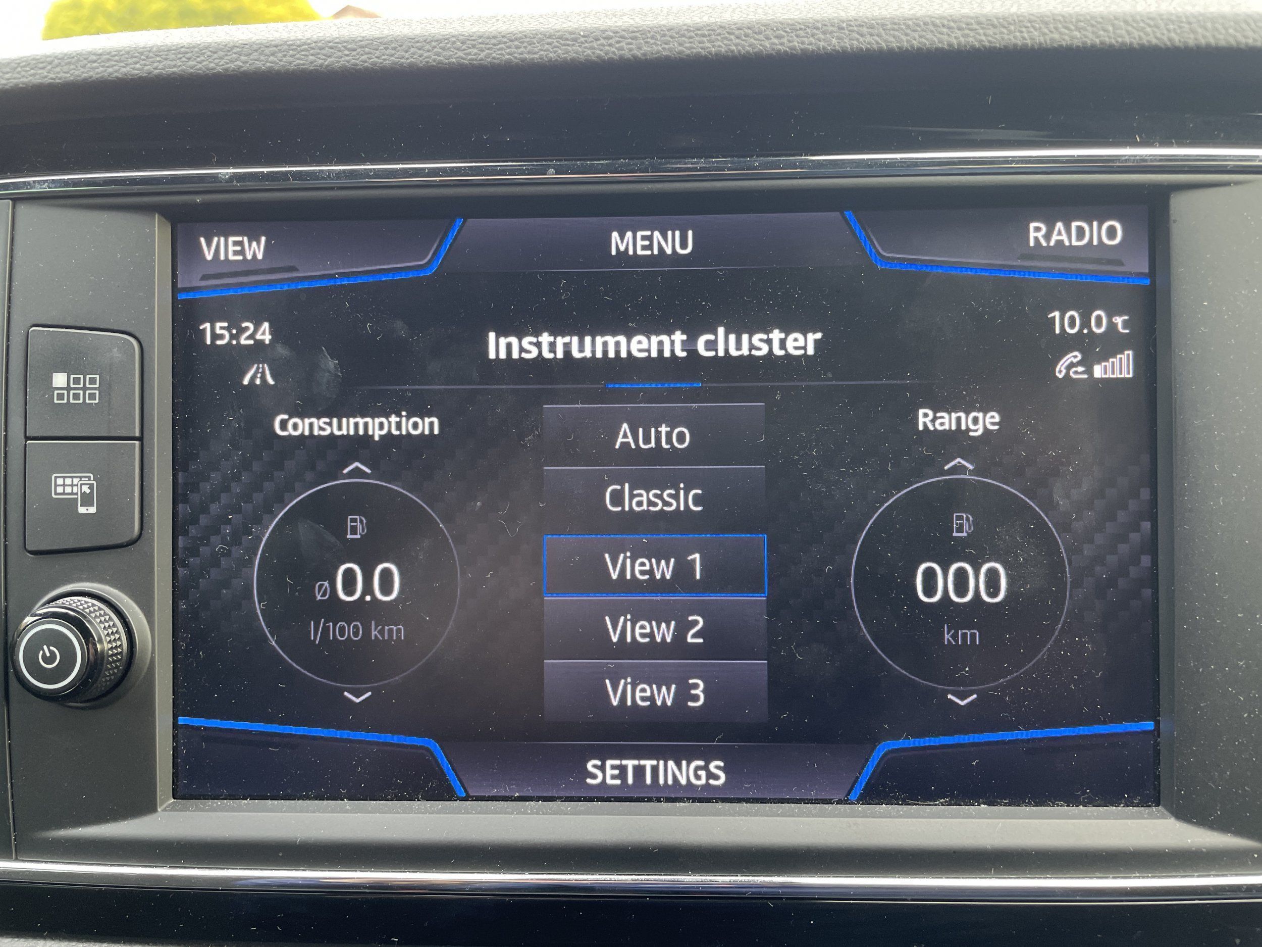

hello guys , i recently retrofited my cupra 280 insto an virtual cokpit dashboard , but now im missing one feauter , how can i activate the dashboard cluster menu on the mib2? like this photo:
You'll need a 3Q0 canbus gateway, and assuming you've installed an MIB2 unit for VC compatibility - you'll need to make sure the retrofitted unit is on new enough software.
yeah i instaled on pro nav mib2 unit to have vc compatibilty, how can i check that 3q0 canbus gateway, idk wht that is , i will check my mib software tomorrow and post it here
So baisicly is just replace it? After that replace i need to config anything? I saw the gateway position is above the drivers feets right? I can use any 3q0 gateway?
Ok. For sure i wont be able to do it , i dont know how to take out the component protection and idk what i will need to code, and also idk wht is the FES
