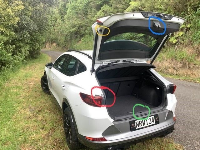

I had some weird noise coming from the back of the car last year when it started to get cold. My wife was driving on the bumpy road and I was checking everything at the back. From the seats to roof and trunk and nothing was working. Then I came to idea to turn that black thingy on the trunk door to make them "stick out" more and it worked 100%. I guess the metal got squeezed from cold or something and trunk door became a little bit loose and it was hitting the chassis of the car on bumpy roads. When you open the trunk door you will find those "screws" on the left and right. The noise coming from that was driving me crazy for like two weeks:)
Found some photo online:
Those rubber bump stops not extending out far enough is a fairly common cause of unwanted rattle noises from the boot / trunk area on VAG cars; if they’re not making good contact with the small black circular pads just above the rear light clusters (circled in red on the picture below), then the tailgate lock assembly (circled in blue) can rattle against the striker pin (circled in green) when the tailgate is shut.

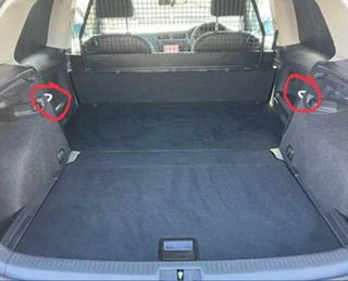

Another common cause of unwanted rattle noises from the rear of the cabin in VAG cars with fold down rear seats is the seat back latching mechanism on the rear seat. The seat back latch can rattle against the metal striker loop when the seat back is in the upright position if there’s any free play between the latch and the striker loop (striker loop is circled in the picture below - the picture is of a mk7 VW Golf estate, but I dare say the Formentor uses the same seat back latching mechanism as the Golf and other VAG cars). A quick and inexpensive fix is to wrap some electrical insulating tape around the striker loop to remove any free play between the latch and striker loop. If the tape does eventually wear away as a result of the seat back being regularly raised and lowered, then it’s easy and cheap to replace.
Thanks @SRGTD & @st4niu!
Unscrewing the little thing has fixed my problem, hopefully this issue doesn’t come back but I at least know how to fix it, thanks a lot!
