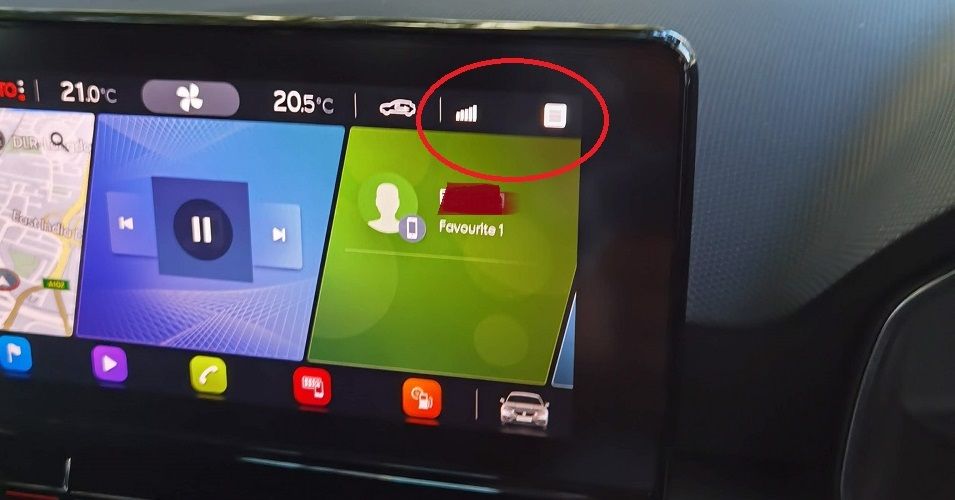

the double clicking noise and SOS error is related to eSIM units some of the car has service campaign for it. My one does it same double clicking sound and you can notice your eSim connection disappear and then you have a SOS error
