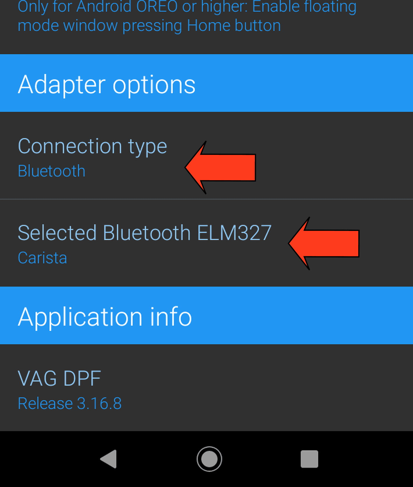

@Brian Gordon-Stables for Vag DPF did you just pair the device up in Bluetooth settings on phone tablet I don't seem to be able to see the Carista in devices but the Crista app works without pairing.

@Sjdickso with VAG DPF you go into settings screen, scroll to the bottom and you should be able then select Carista as the bluetooth adaptor (and make sure it's set to Bluetooth). Just make sure the Carista dongle is plugged in to your OBD port.
