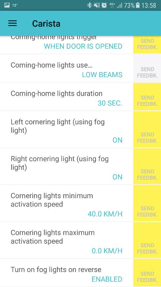

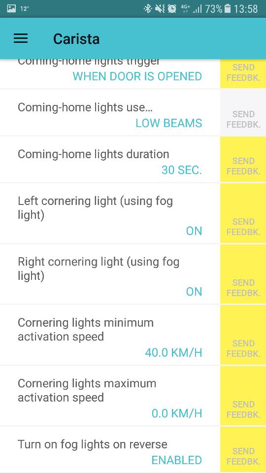

I did screenshots of what i can do and the settings for the cornering lights were...a bit weird as shown below

russbellrfs
Jan 7, 2018
286
26
Forgot to add that i noticed that and put minimum to 0 and max to 50. Do they light up all the time or is it when headlights are on only?
Could the reason its not working be you haven't set a Maximum higher speed than the Minimum one?

I honestly have no clue, its only noticeable inside at night for obvious reasons so I would need to do some investigating to find out xD
Just read manual and it says not activated with full LED headlights and bulb foglights. My fogs are definitely LED as the LED headlight pack includes LED fogs and i checked them when i collected car.

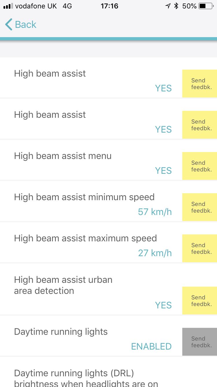

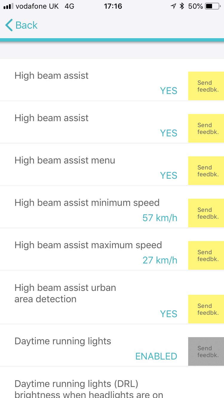

Anybody else has this with High Beam
Assist. I’ve not altered it in anyway, but for me it’s as if the values should be the other way round. The car has it and last time I used it it was working fine at all speeds.
I had this with my cornering fogs where the values looked like they should be other way round too.
