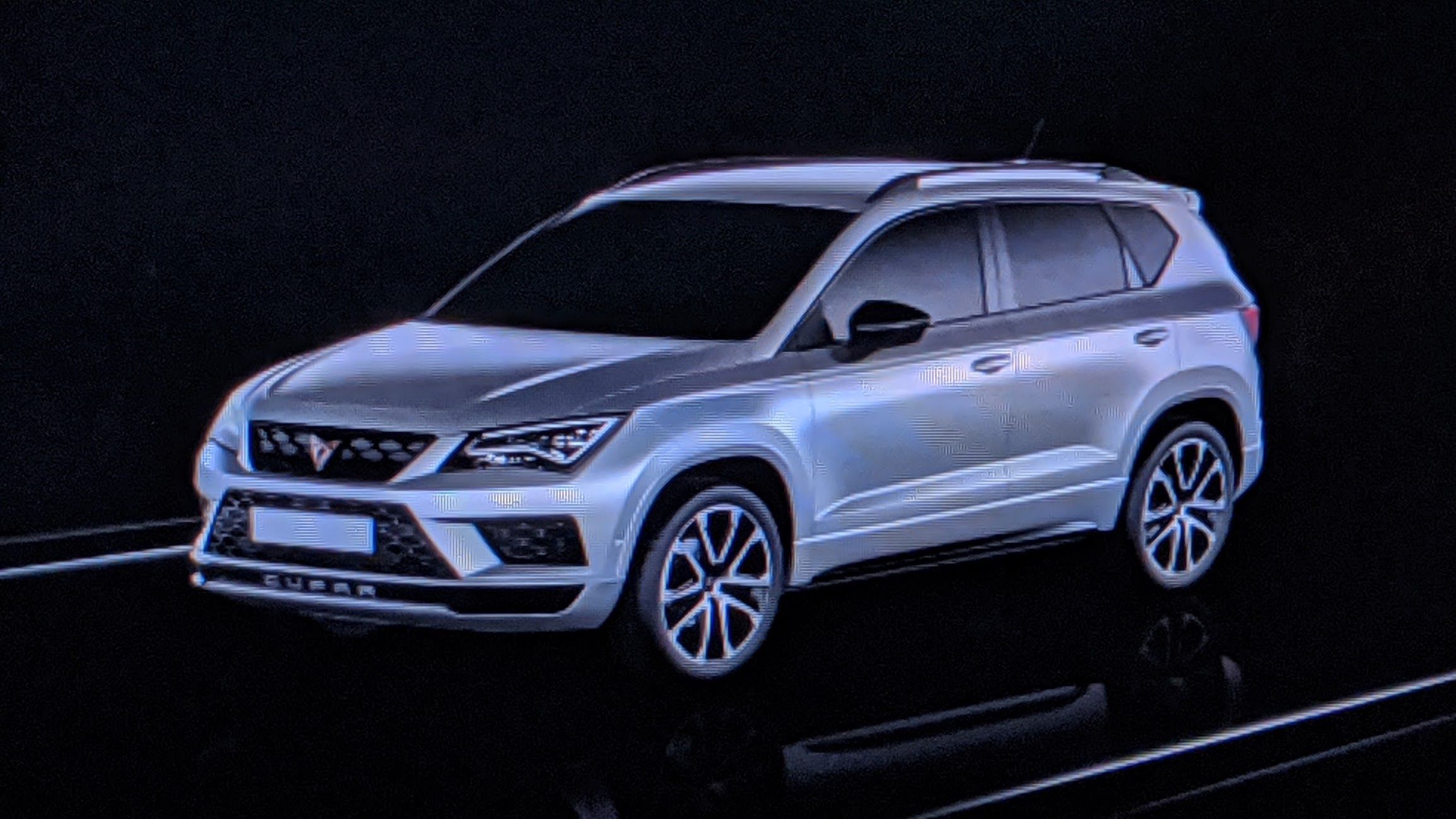

In the infotainment I see that the car image is regular Seat Ateca instead of Cupra Ateca.
Checked the recent coding and adaptation I made, and nothing. All seems to be like from factory except the changes I wanted and intended to make.
Can somebody with a Cupra Ateca can tell me what image do they have & post the long coding and adaptation maps for the following modules: 5F & 17
This is what you should have. ;)
If nobody has supplied the other info you're after then remind me at the weekend and I'll sort it for you.

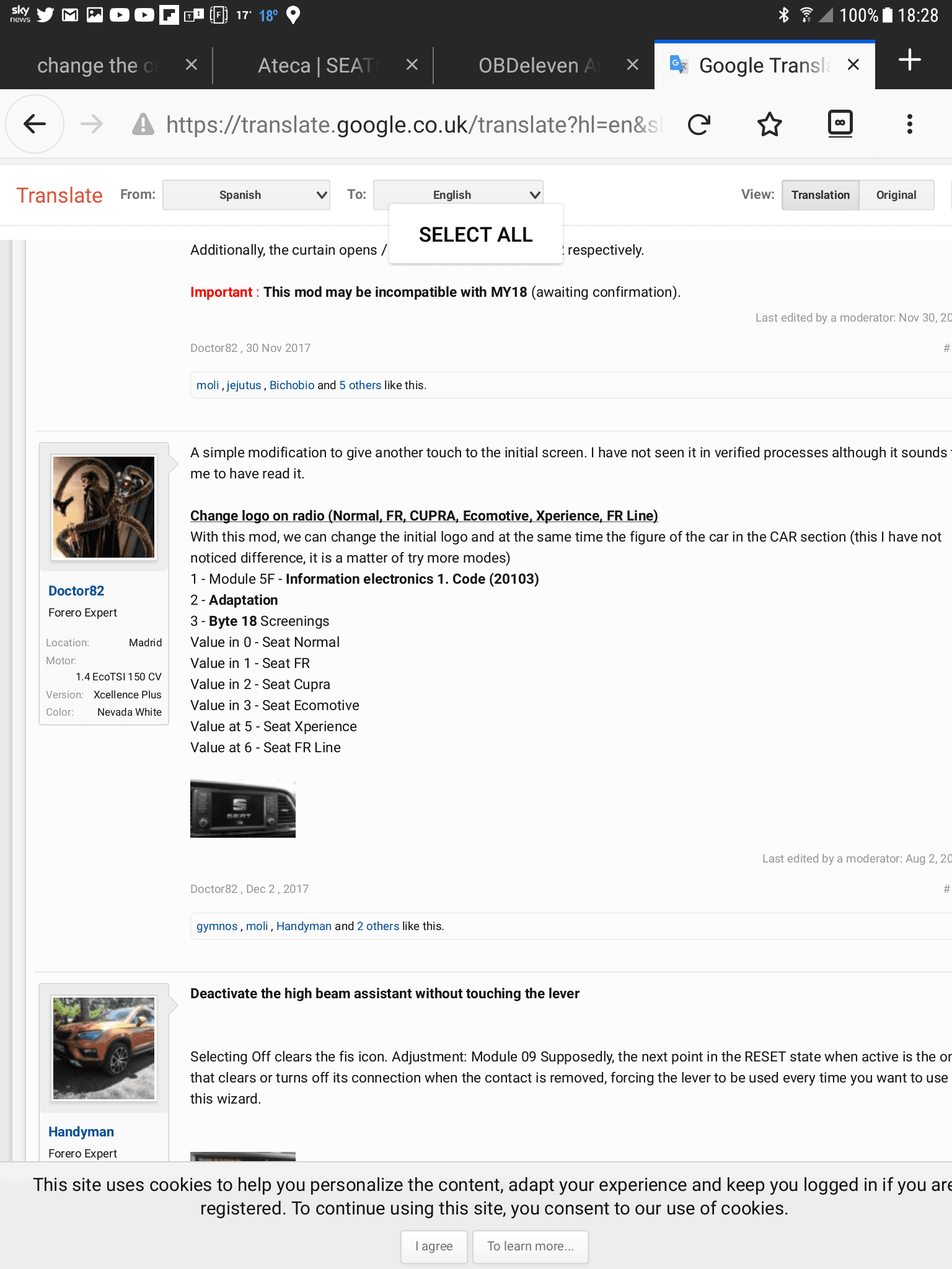

Carried on digging you want this post from the Spanish Ateca site translated... but if the images don't tally then they won't be in sync and it's probably an error. Worth trying to swing thru them. The logo changes plus the car image.
According to an Obdeleven post you dont need to reboot the infotainment system as you change those values. This post
See image below for Ateca ones values... thanks to the Spanish Ateca board. I suspect Boyracer's is set to 2. If you all got 2 but different results then I suspect the image in the standard and high units is different. They run different firmware, different hardware.

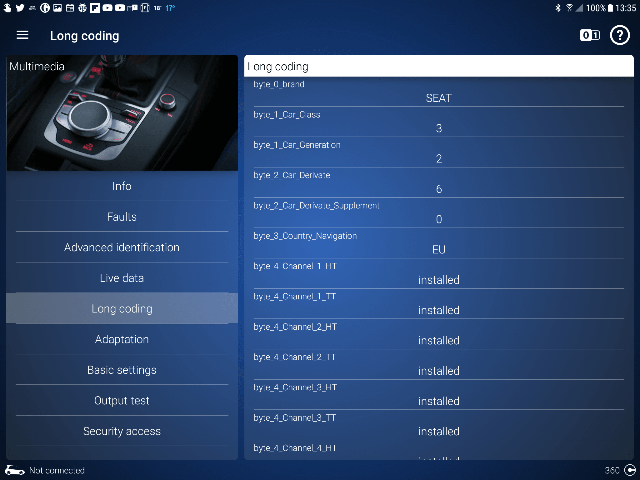

Afraid I don't have the latest VC... only one image on the 5F unit. Tomorrow I will see whether my logo and image changes based on what I edited in on post 14. I have 2018 or 2019 firmware in it so expect to see different models perhaps. My value is currently set at zero, e.g. a standard Ateca. Boyracer's value is the key. If he's not got a 2 or 0 or something else then we are looking at another field. I do trust the competence of the Spanish Ateca board to publish the right field:)... I've just never tried altering it since I have the car to match the image :). May be the image was never published in my firmware. 1338.

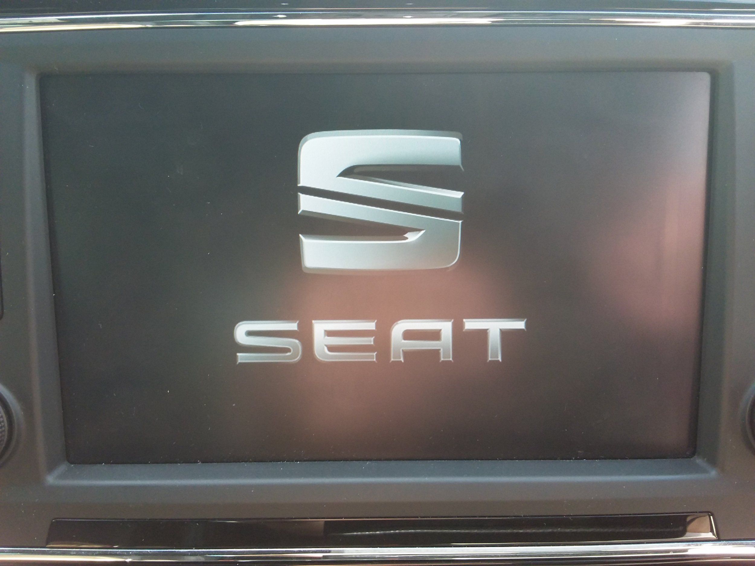

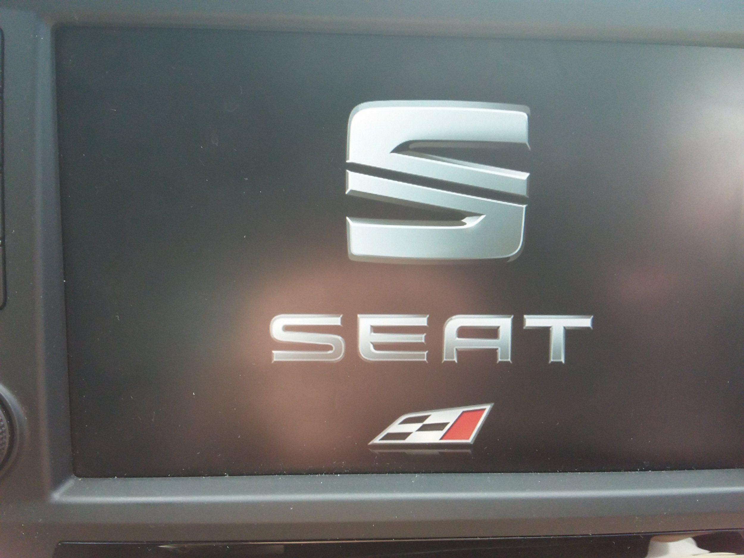

Ok I changed that value, first image 0, second image 2 on the boot screen of the unit. Didn't notice a big change in the cars image. Ofcourse we don't know whether production Ateca Cupra use the value of 2 and my firmware probably is pre Ateca Cupra... this is a carry over from the Seat model range. Mines a hight unit with the firmware mentioned above. So I get that graphic in the second image with a supposed Ateca Cupra on the carry over coding from the model range. Wonder if its anything like Boyracers ?. Need his codes to resolve for you people with issues with the standard unit.
I guess the standard unit Ateca Cupras need something other than a zero in byte 18 :). Set mine back to 0.:). If you got a zero then yes that isn't right for a Cupra.
The other avenue to explore is to find the long coding for the infotainment unit of a Seat Ateca posted online.
Related post below, see post 8, points to bytes 1 to 2 as well. I have added my screen on that. We need Boyracer or anyone with a correct working graphics. My screen is the defacto non Cupra Ateca with a high unit. That the contents. I'd expect an Ateca Cupra to have different values.
You need to explore these against an Ateca Cupra's to resolve the image as well. A bit loath to change what I have working in bytes 1 and 2
. So I reckon byte 18, byte 1 and 2 are the ones to concentrate on for comparison.

Hi Tell, Byte 18 is only changing the boot logo of the infotainment. Byte 0-5 are the ones that responsible for the car image.
As I have mentioned in one of my previous posts, I have tried every possible combination to no avail.
The image just seems to be missing in this firmware or the image is hidden with somekind of not listed value like I have in Byte 18.
