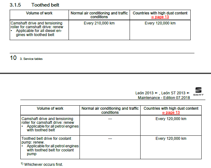

Our 1.4 EcoTsi 150 FR has a CZEA engine with toothed belt and we were told by Marshall SEAT Leicester service department that the belt is 5 years and 120k miles whichever came first. Not long after being told this the parts department phoned me and said there wasn't a schedules belt change for our car and as such he tried telling me it would be advisable to get it done at 3 years as ours has just passed 60k miles.
The SEAT workshop maintenance file is blank for petrols in regards to toothed belt in normal conditions but stated 80k miles for countries with high dust conditions. Strangely enough they seem capable of putting a schedule of 130k miles for all diesel engines with toothed belt in normal conditions. I cannot see why their would be any difference in normal conditions for petrol cars with toothed belt considering they have put the same schdule for petrol and diesel (80k miles) for countries with high dust condition schedule.
It seems to me that SEAT are wanting you to believe that the belt needs changing at 3 years, they then give you a 5 year warranty for the exact same belt when they replace it.
