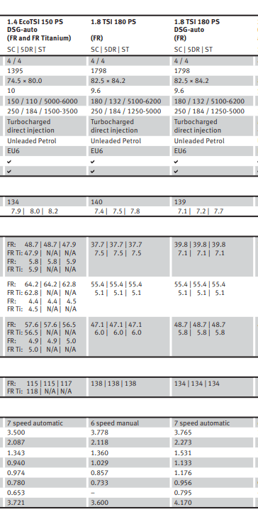

I think the brochures, or price list, around 2016 showed speeds in each gear so you can compare the 1.4 DSG to the 1.8. DSG. I seem to remember that gearing was the same.

different gearing:

I've seen this before, and was quite sure it was a different gearing. The Garages and VAG specialist I spoke too seemed to thing it was the same, but couldn't say for certain.
