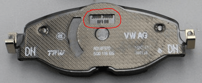

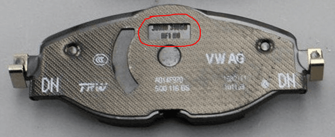

You don't need to/shouldn't apply grease to the back of any pads which have rubber composite shims.
Only need to lightly grease metal on metal contact points on the edges of these pads.
TRW are the OEM brake caliper manufacture for the 288/312mm brake - but they don't make any OEM pads - you can see the OEM pad manufacturer in this example is Jurid.
TRW pads sold in the red boxes are purely aftermarket pads.
Same applies to the other big brake system/caliper brands, Brembo, Conti, Bosch etc..

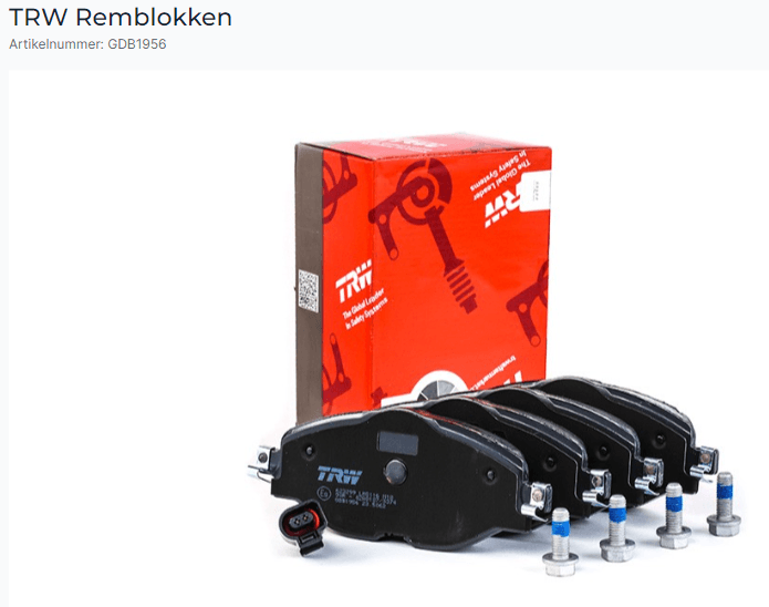

You're absolutely correct. I didn't actually mean that my replacement pads from TRW are OEM, rather they are replacements for OEM. Misleading wording most likely.
I've got these on the rear:
And these on the front:
They perform as good as OEM pads, but they stink when they're very hot. But I couldn't care less about that.
