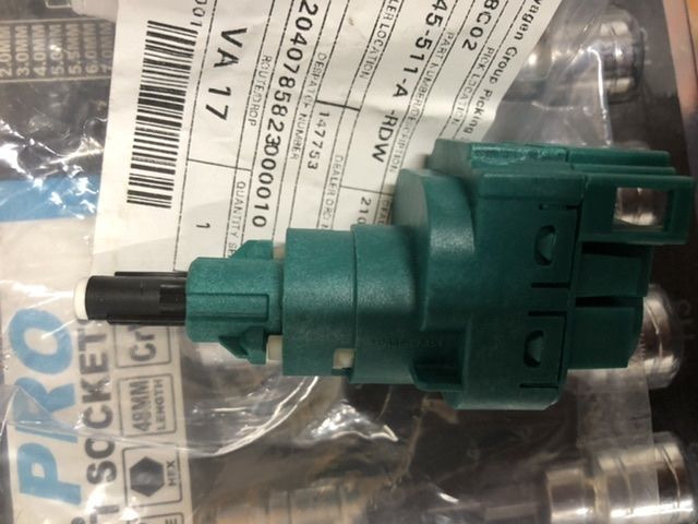

Aug 31, 2020
Hi any chance you can share the full part number for the switch? I've an error code 057100 - Cruise/Brake Switch (A) Circ Malfunction and so want to replace mine.
Thanks!
