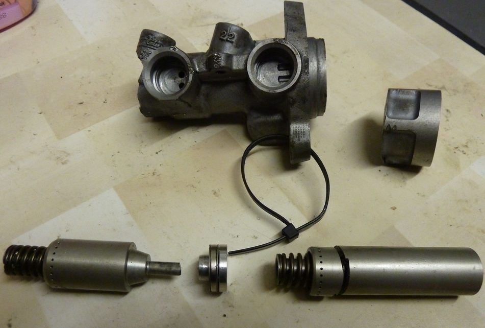

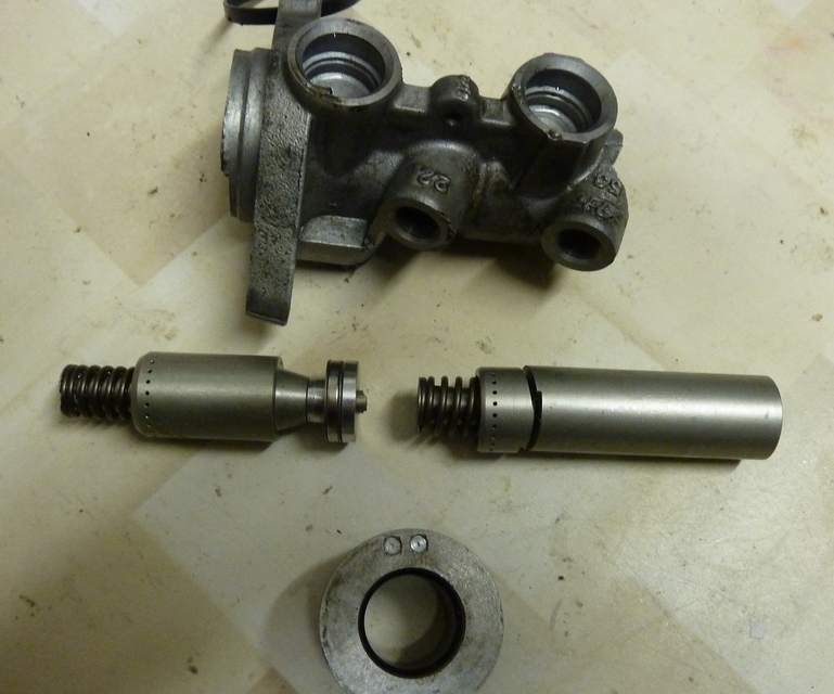

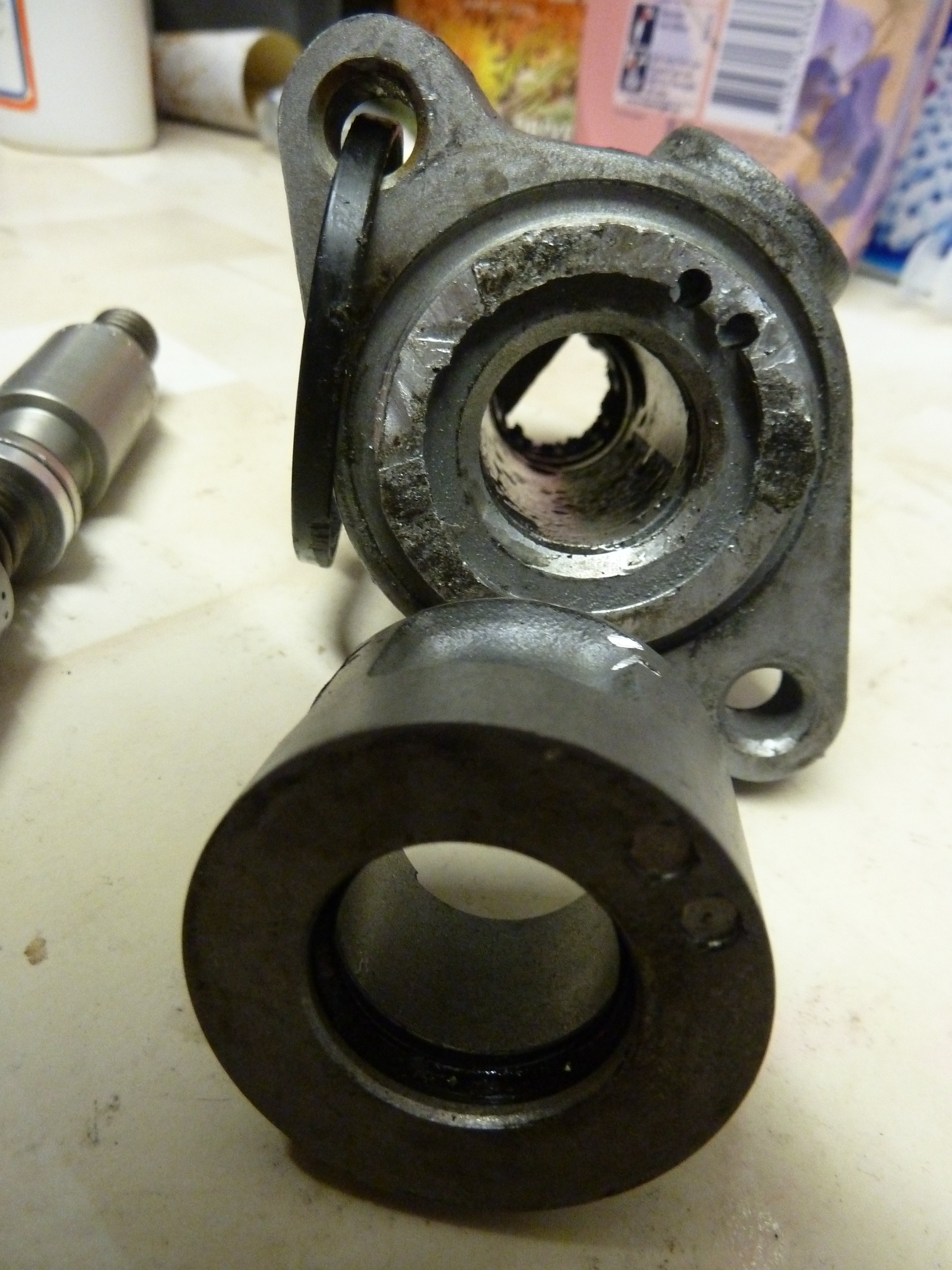

new master cylinder fitted everything working ok now have stripped the old one down and the magnet is round the first piston when i say stripped down i mean hacksawed to get the piston out no circlip just two pins
Hum, sounds like the plan is after these master cylinders are built they don't expect/allow for them to get refurbed or sorted!
Ah well for once, someone, ie you have confirmed that brake lights stuck on can mean, or probably means new master cylinder required.

heres a few pictures of the master cylinder after id stripped it down
