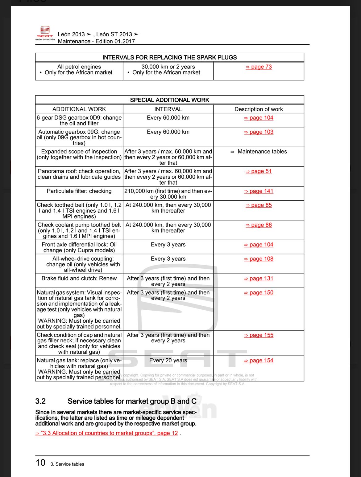

Am I right in saying the diff of the manual car should have its oil changed every three years? Car's at 61k and no record of it being done.

Are you referring to the diff or 4drive Haldex coupling?
The Haldex coupling oil should be changed every 3 years, but the diffs should be sealed for life (but oil can be replaced).
If the car has been tuned or driven hard, the specialists recommend changing the Haldex oil every 20k miles and removing pump/cleaning strainer (not part of the VAG service).

No, The Cupra has a front diff which I gather is the same as the diffs in the 4drive system. I've seen conflicting advice but most sources say that the diff oil should be changed every 30k miles.

You said that you have the 300 ST - I was under the impression that these only came with 4drive; if so no front diff like 5dr FWD Cupras.
Is it a 7 speed DSG? If so, no resonator as it has the GPF (twin can version) just after the downpipe.
Service schedule is below (note not updated for 7spd DQ381 box):
Cupra is either or depending if FWD or 4WD.
No, it's a front-wheel drive and manual. I've looked at pictures in line and it looks like standard cars have a toblerone in the middle of the exhaust. I don't. I've got a straight pipe which does not look stock.

Ok, in which case, for FWD service is 3 years, but uses a similar Haldex system to lock front diff electronically. There were some posts on here recently for this. Probably at the bottom of this thread...
