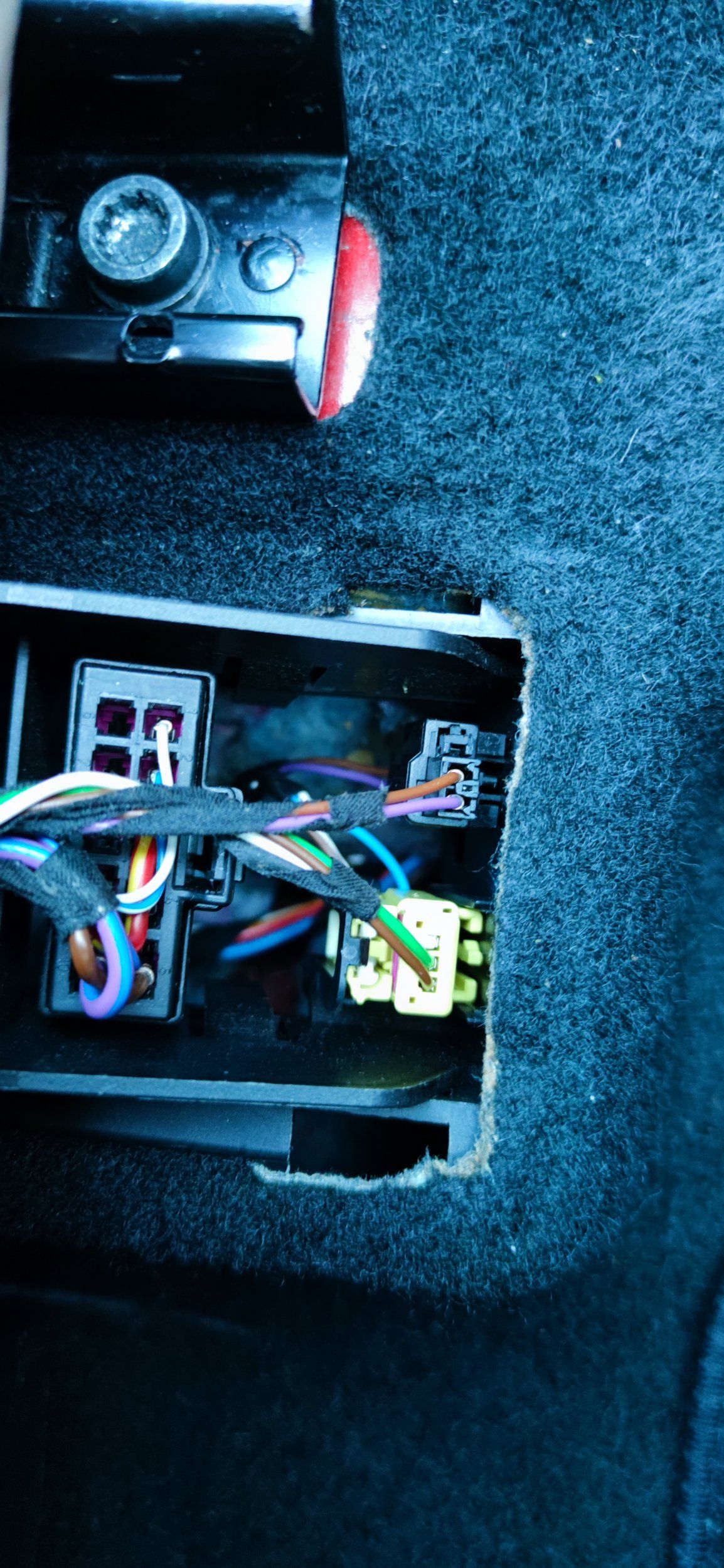

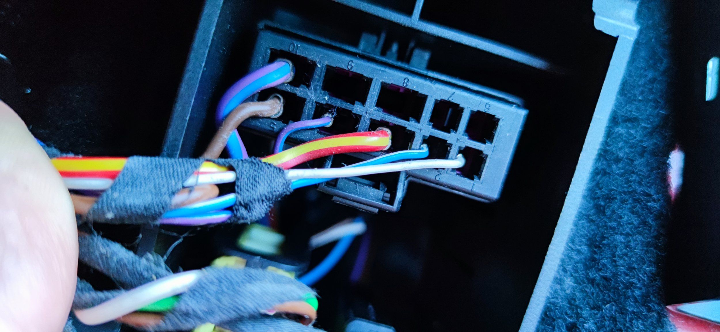

thanks for the answer. Good idea, I can try either that way or check the voltage after switching the seats heating on. Would anyone please be able to advise which exactly wires do I need to check, so I don't have to take the seats out? I know the yellow connector is definitely airbag. Please see photos attached. thank you

It’s the big plug the smaller two plugs are like you said air bag and seat belt pre tensioner you definitely don’t want to mess with those as adding 12v to that will end up causing a major ejecto seat situation.
Use a multi meter on each of the wires one at a time with the Ignition off and on to see if it’s 12v is there when the key is on. But this might not work if the actual fault is a relay or feed issue.

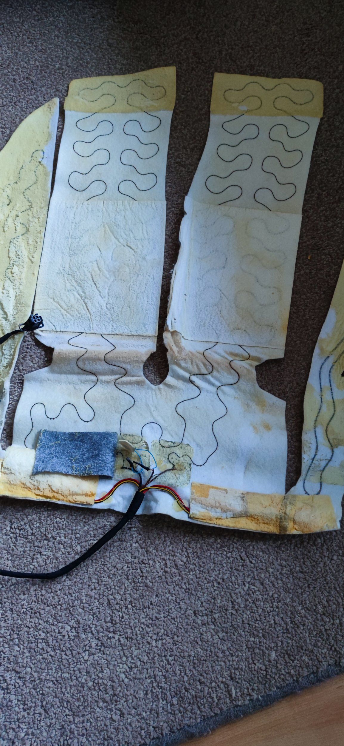

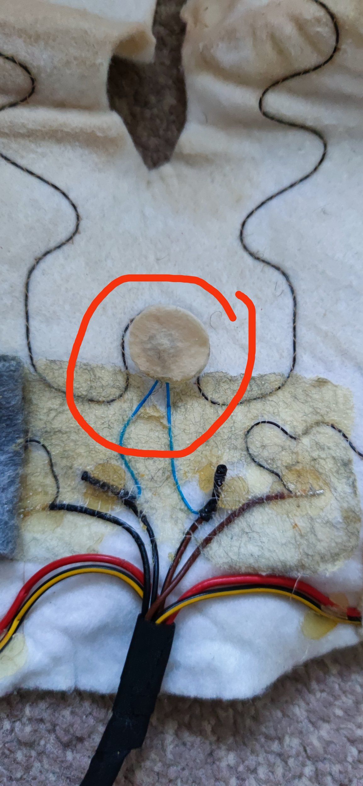

Checked it today and looks like power goes to the seat when switching the seat heating on, so I took passenger seat out and dismantled it. It's much more complicated then I thought. There are many wires going from the plug. some of them go to the side of the seat, some go to suport heat (and that's another surprise as I didn't know the all the support is heated not just the bottom part). After checking the circuits it looks like: support mat is ok, base side mats are ok. Base centre matt is not ok, but the wires are ok, there is a small part ( no idea what is is) - in red circle on the picture, that seems to be knackered. Another thing with no circuit is a tape - seat occupy sensor. As the wires are all good, I would rather replace the broken elements (if possible). Has anyone got any idea of what these not working parts are, and where can I get them? The other good thing about today is I managed to wash the covers properly and they look like new now :)

The bit circled in red is probably a thermistor to monitor the actual temperature.
thank you. Can I connect the matt to 12v without thermistor (connecting 2 blue wires) just for 1 min to check if the matt is heating? Or would it damage the matt?

Don't think it would cause any issues for a minute. It would just apply the usual amount of heat but without any control.

Thanks. Managed to repair both seats. It was faulty thermistor in passenger's seat and burned matt wire on a driver's seat. I repaired them, put everything back and tested and all worked perfect. This cold morning I was excited going to work and finally enjoy the heated seats again and... it doesn't work again. I don't get it. What could go wrong this time? It worked yesterday evening...
