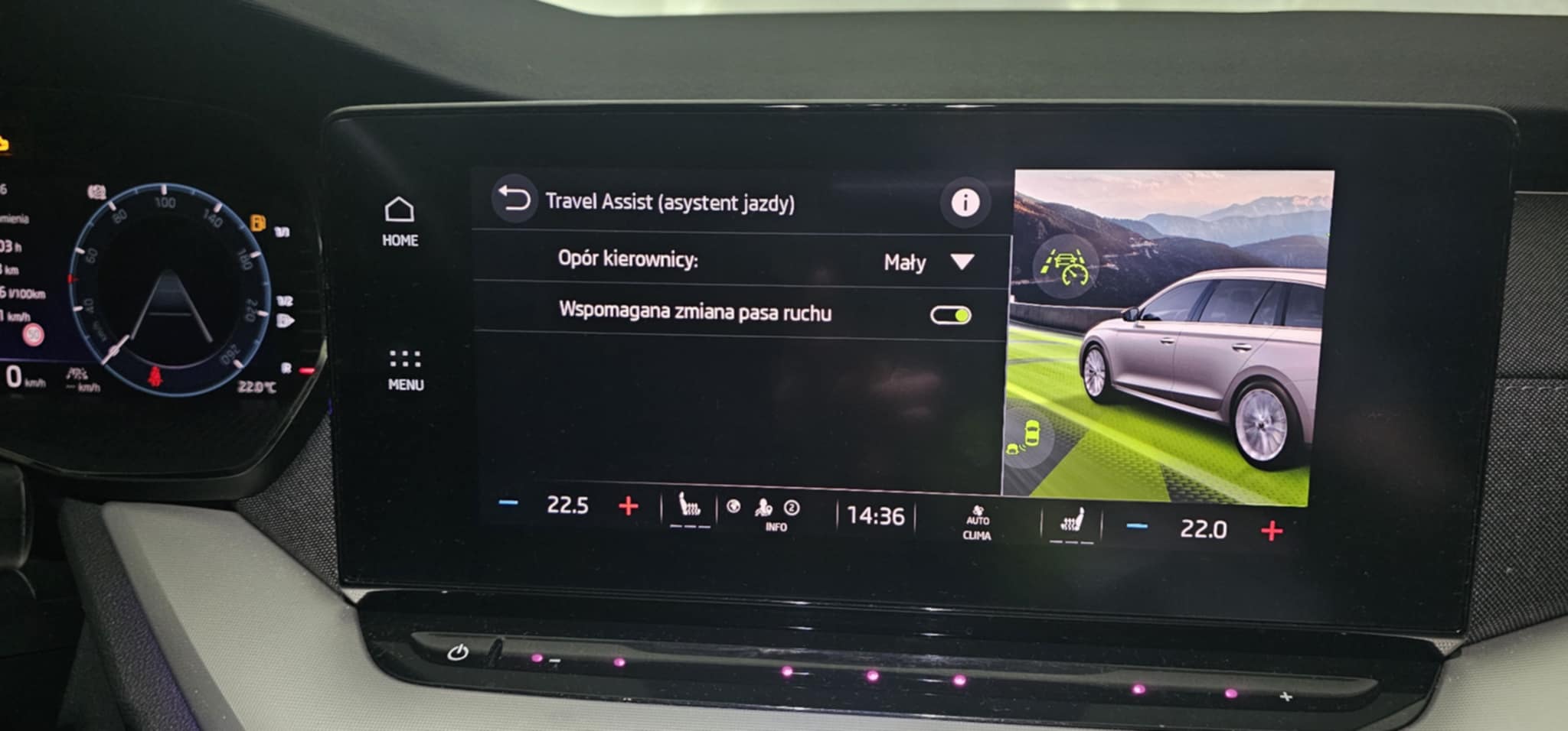

djmartzian Active Member Apr 25, 2023 46 8 May 1, 2025 #131 @cairus, Same result "Function not available!" after CAN bus rest.
cairus Active Member Jun 4, 2024 1,411 510 May 1, 2025 #132 The function is present in the assistant menu but is grayed out?
djmartzian Active Member Apr 25, 2023 46 8 May 1, 2025 #133 Yes, the toggle button is present in Assistants Menu, but can't be enabled. When swipe it, "Function is unavailable" message is displayed
