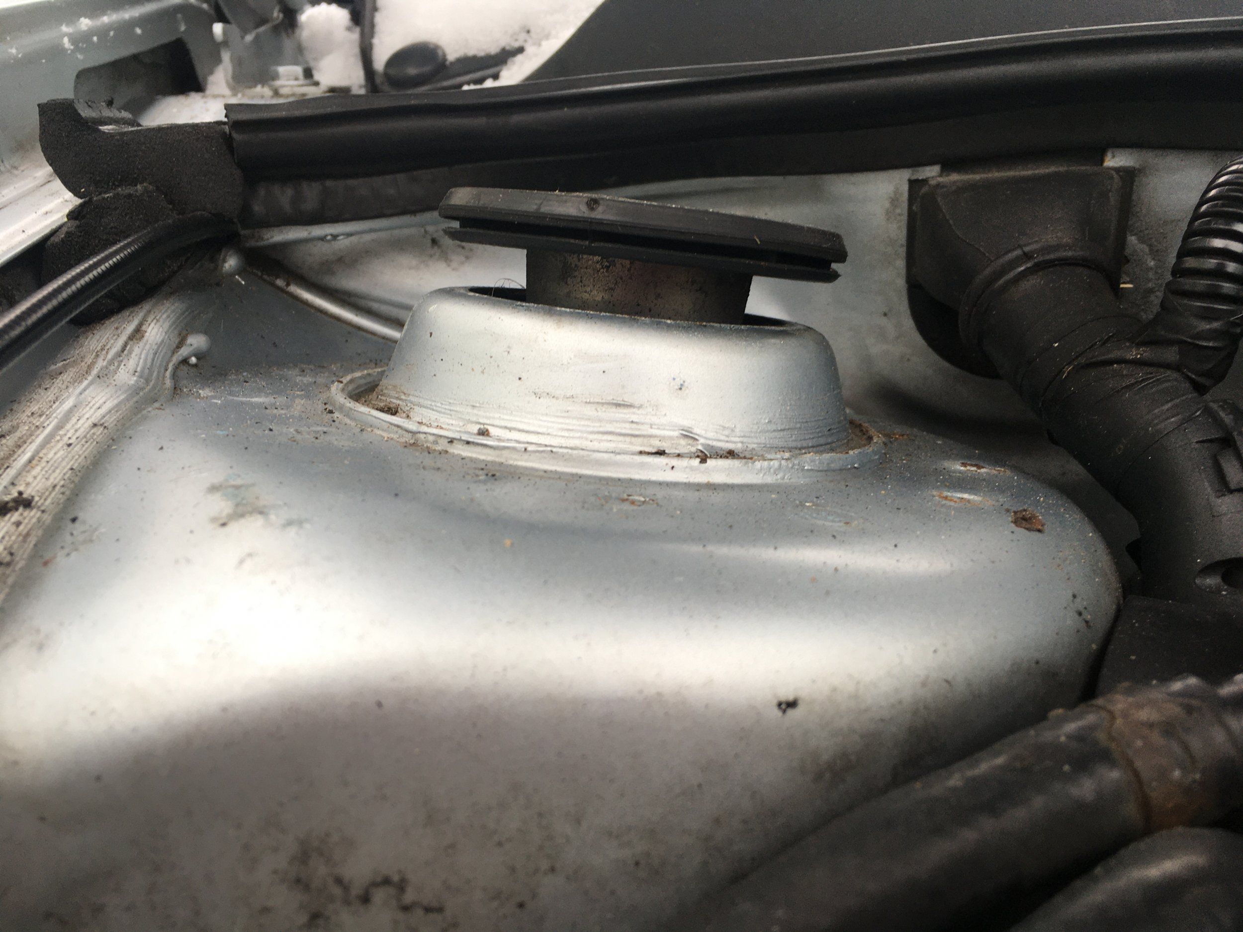

So last night I found out that this might be a sign my top mount bushes and bearings might need replacing.
I can't comment on any difference in the ride, given that it just generally feels 'shagged' but if anyone has any recommendations on replacements, they'd be gratefully received... From this thread alone, OEM seems to be the way, but if there's any particular brand I should look out for (or avoid), that'd be great.

I replaced mine a while ago.
Symptoms were lack rigidity on cornering.
I jacked mine up so wheels were hanging down.
Grabbed the wheel at 9 and 3 oclock and shook it.
Loads of play at top of legs.
ThaiW i think reccomended OE items. So thats what I fitted.
Glad i did. Im sure they will last another 15 years.
Car feels perfect.
Rich

Awesome - thanks. They're the originals, with 160k on them, so they could do with a change and they're cheap enough. Did you just get the bushes or did you get other bits and pieces as well? I'm looking on parts sites and it's not altogether clear what I need...
Rich.T
Feb 15, 2020
1,609
932
I bought complete strut top kits from TPS.
I think the oe ones are made from a stronger compound rubber as the cupras are a sportier car.
Id go oe if i were you.
You may buy some off Ebay etc or aftermarket that'll fit but you wouldn't be sure of the rubber quality/compound.
Think the kit is new bush, top bearing, nut n washer.
Was about £100 for the 2 kits if memory serves.
