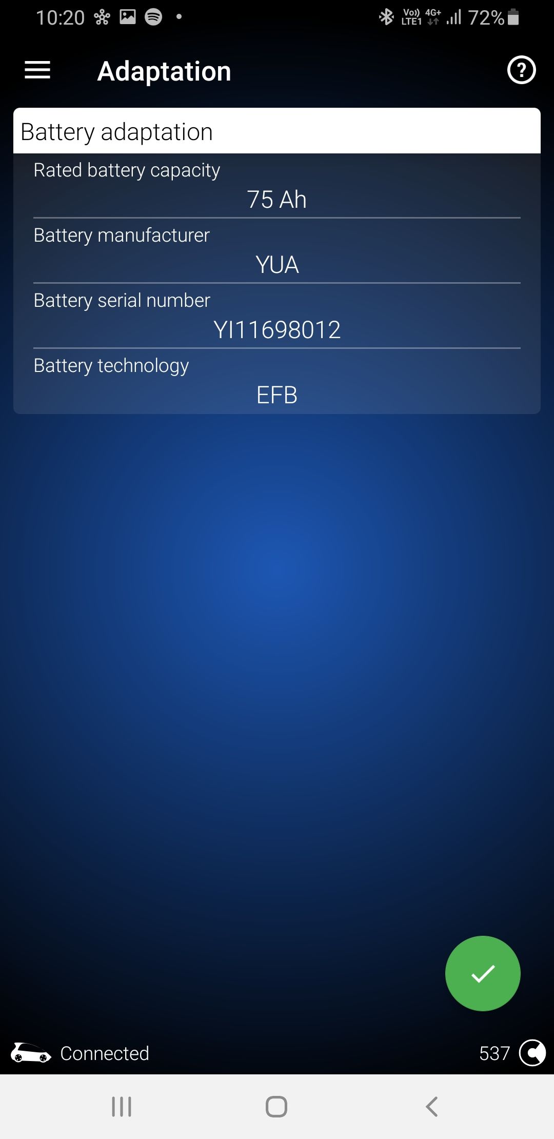

I use Obdeleven. This is how it looks:
Control Unit 19 Gateway - Adaptation – Batteri adaptation
Replaced my battery earlier this year to Yuasa 75 ah
