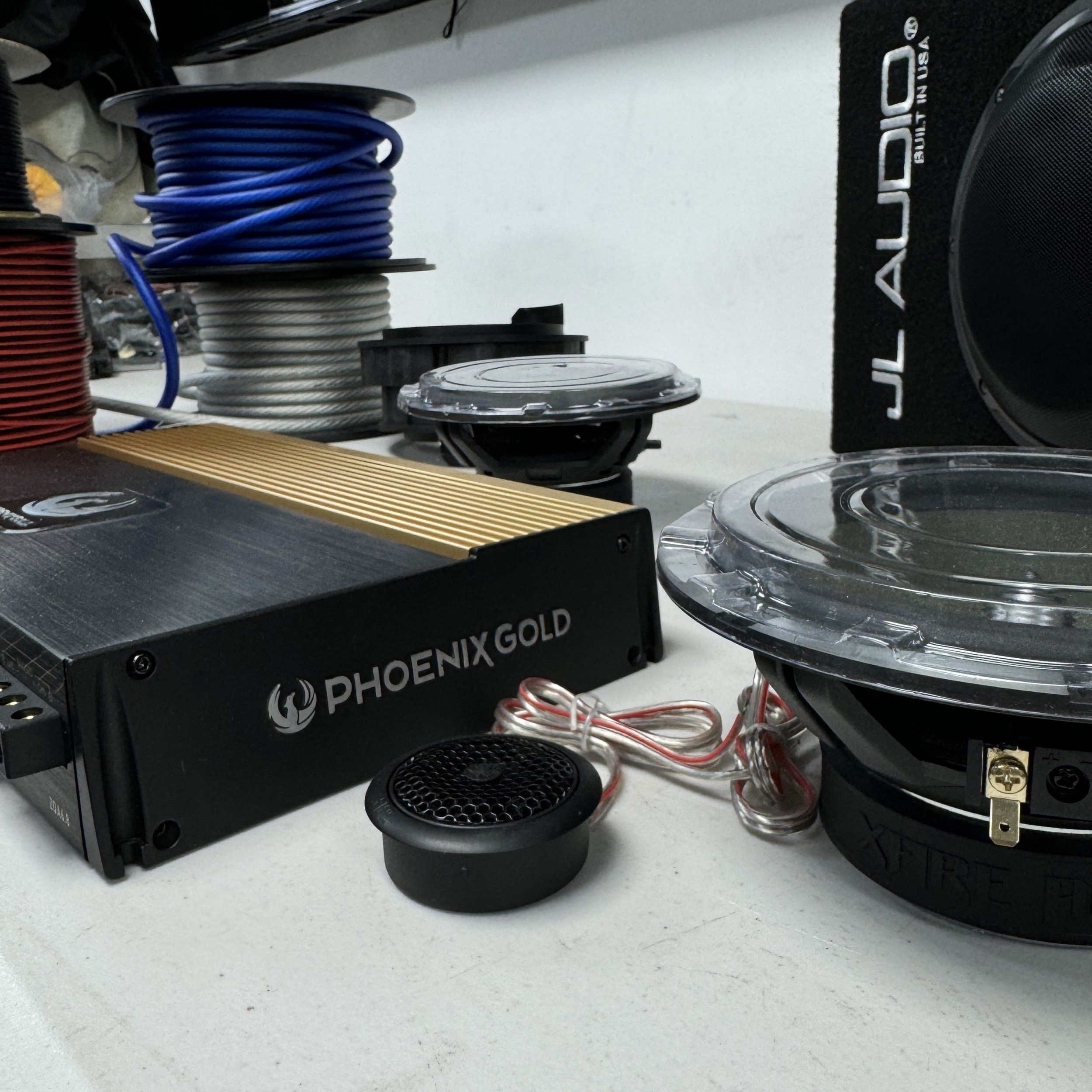

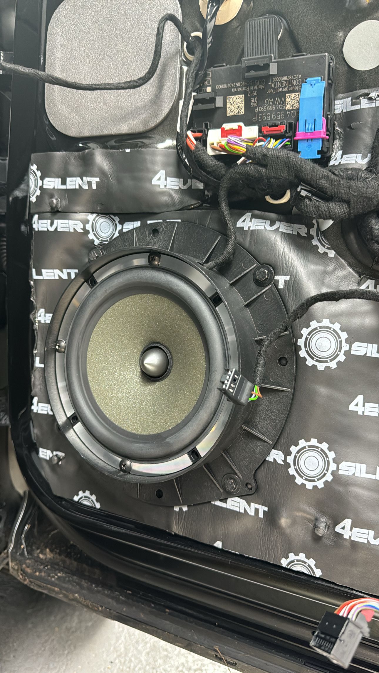

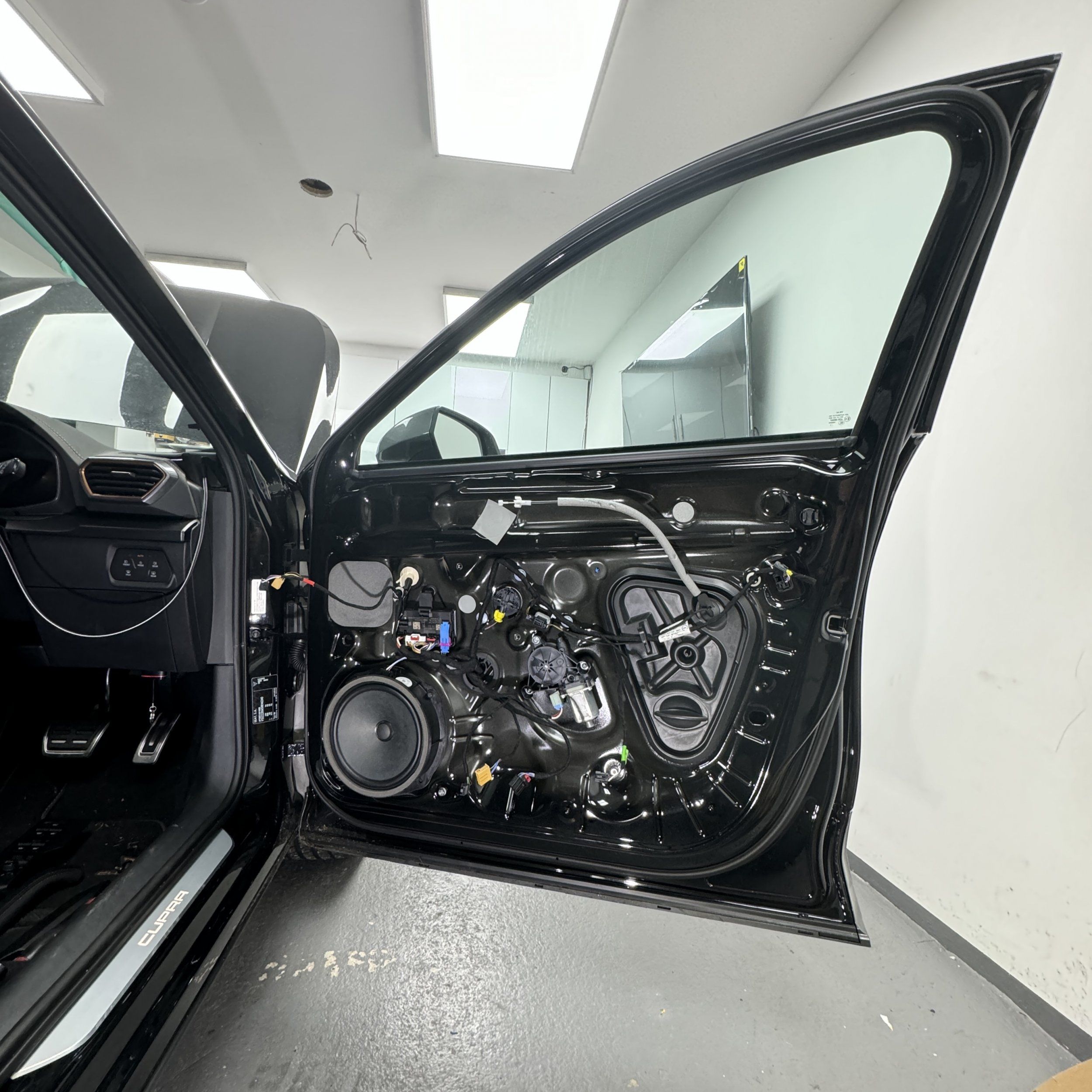

The standard paper cone speakers are always a weak point on any car. I decided to upgrade these to an aftermarket Mids/high package.
I used a relatively unknown brand called X-fire. To be honest I was quite impressed with them. They had demonstrated the JL C3 to me on a car and the a similar car with x-fire. In all honesty, there wasn’t much in it, other than cost.

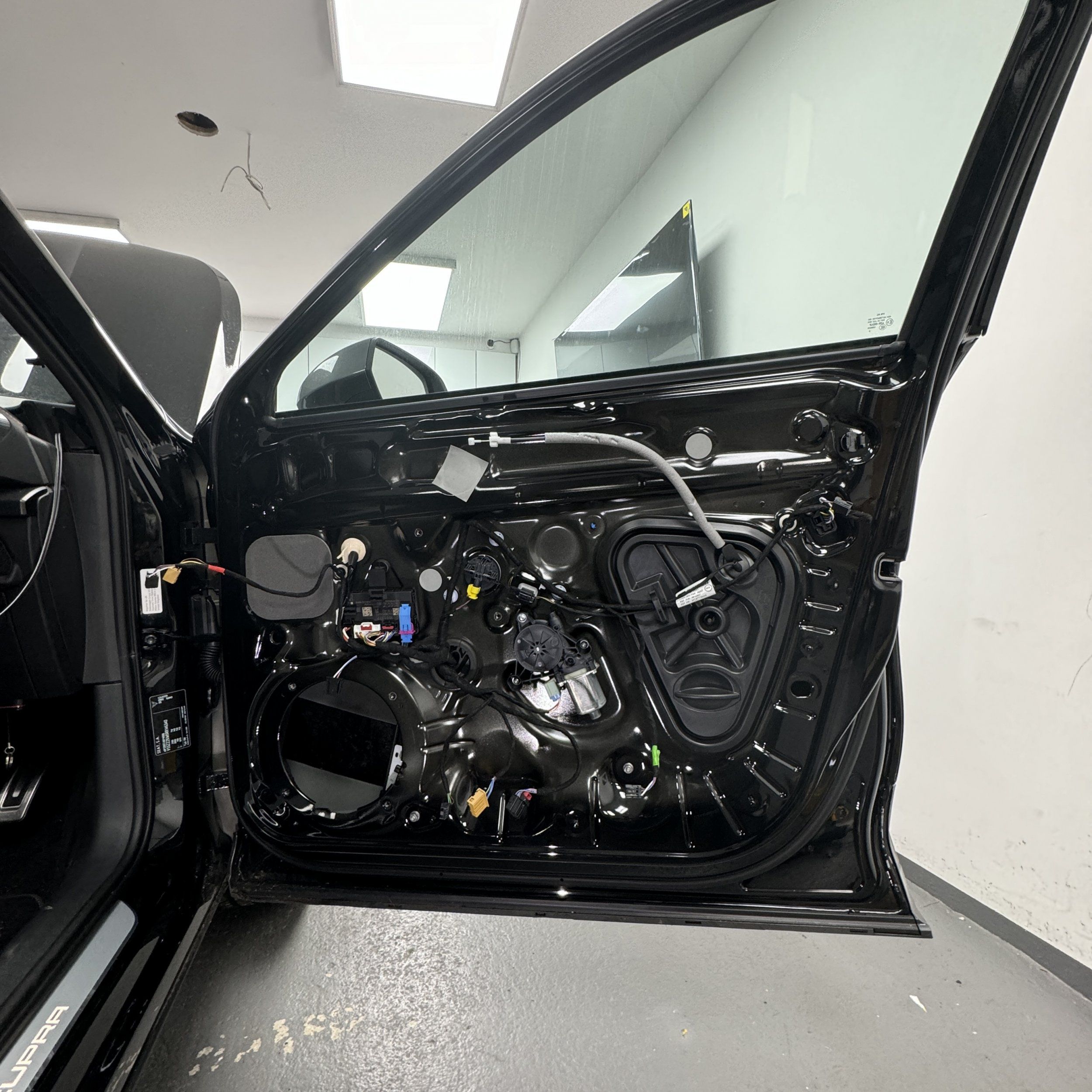

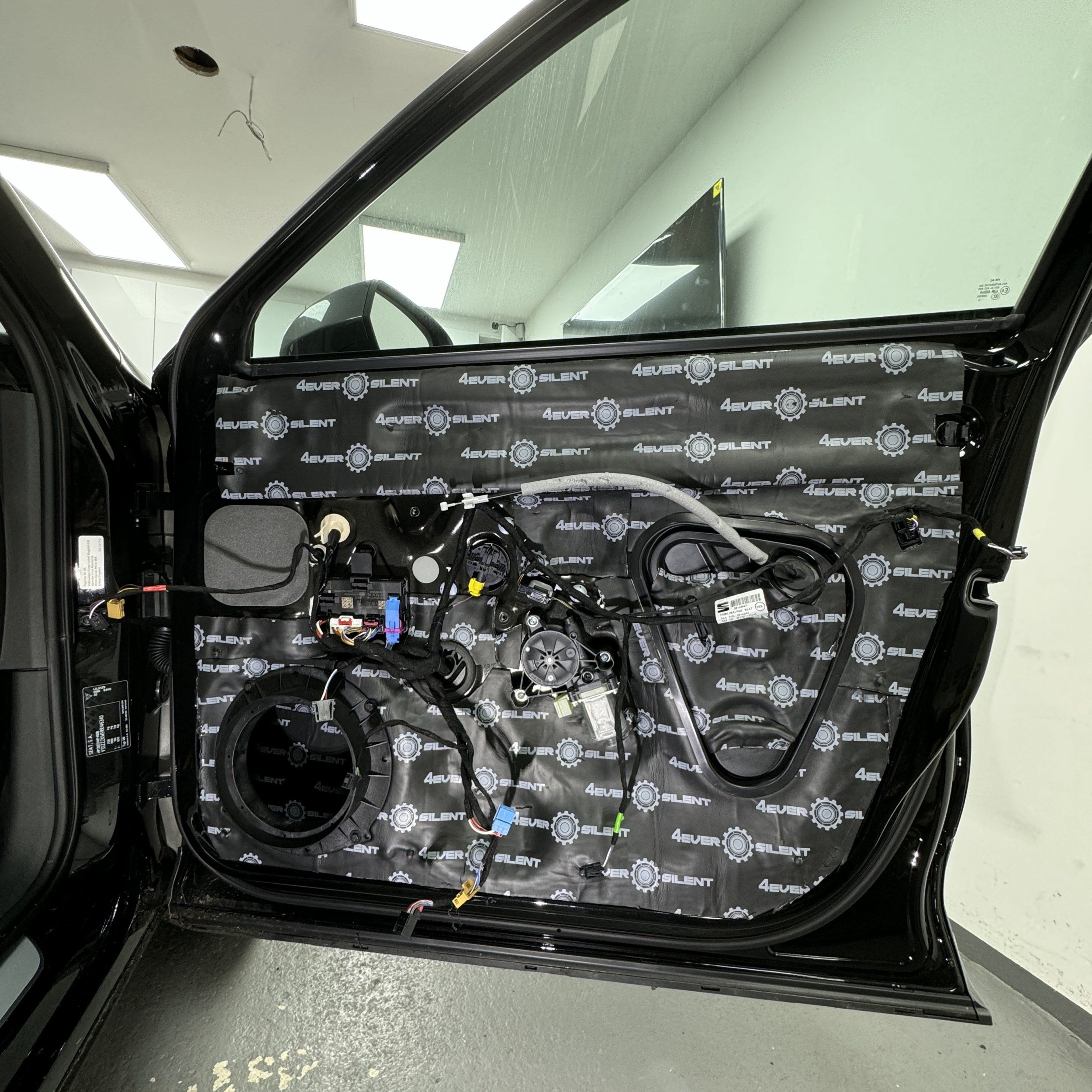

I know that decent soundproofing in the doors will pay dividends. So we did this too.

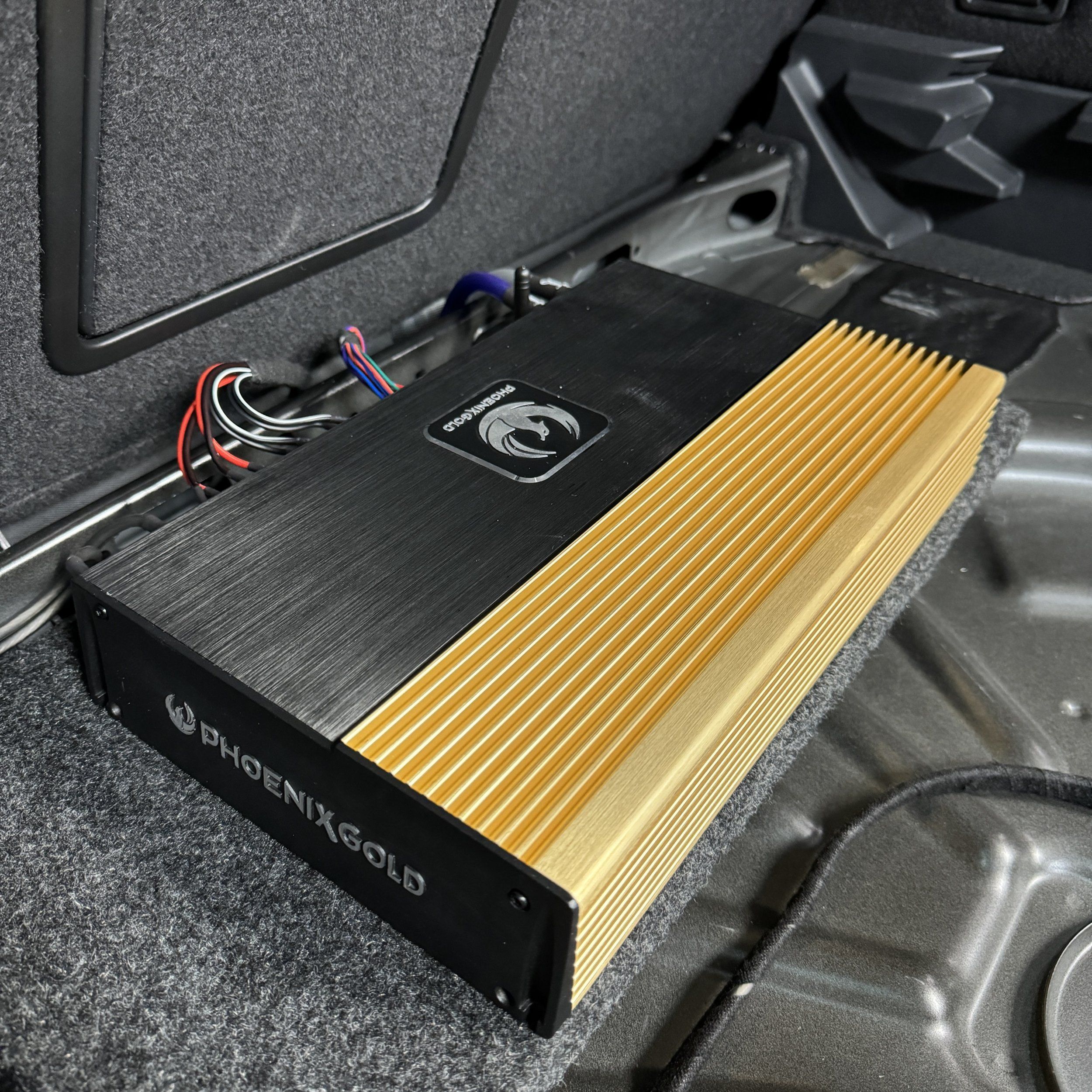

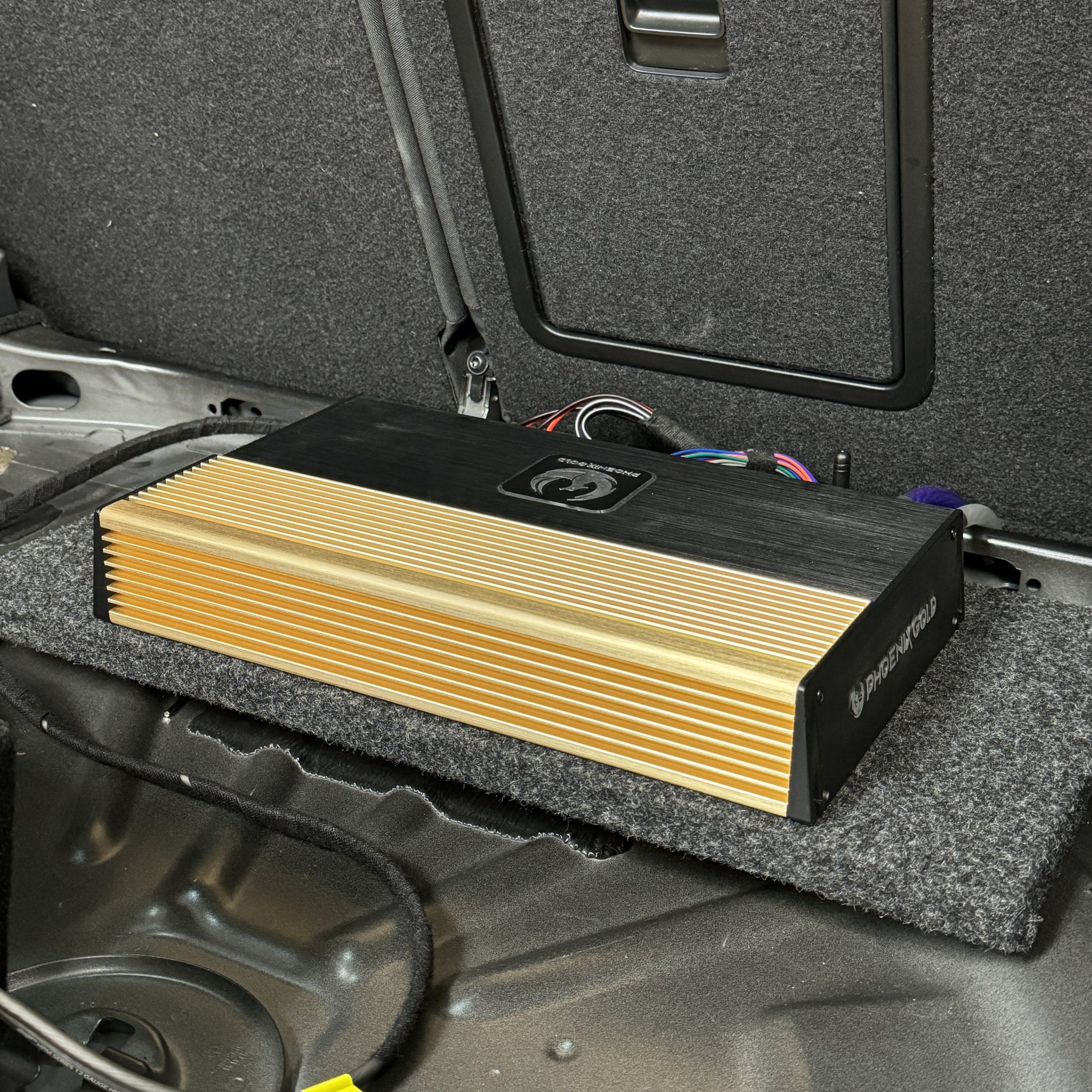

I was going for a Match 5.4 DSP which I would have put under the seat, and run the sub from this amp too. However, my local retailer in London said yes, the Match is a good amp for its size, but with the room we have in the boot, we can do something different. So I went with the Phoenix Gold ZQA6.8 DSP Amplifier. Cost was an extra £75 for the bigger amp. It’s much more powerful too.
ZQA6.8 is a high-end amplifier and Digital Sound Processor offering amazing sound quality and adjustability to give me the sound quality I want.
Amp was placed under the boot cover and sits quite nicely there. There is a basic tune on the DSP, currently running the fronts on the amp and a subwoofer.
