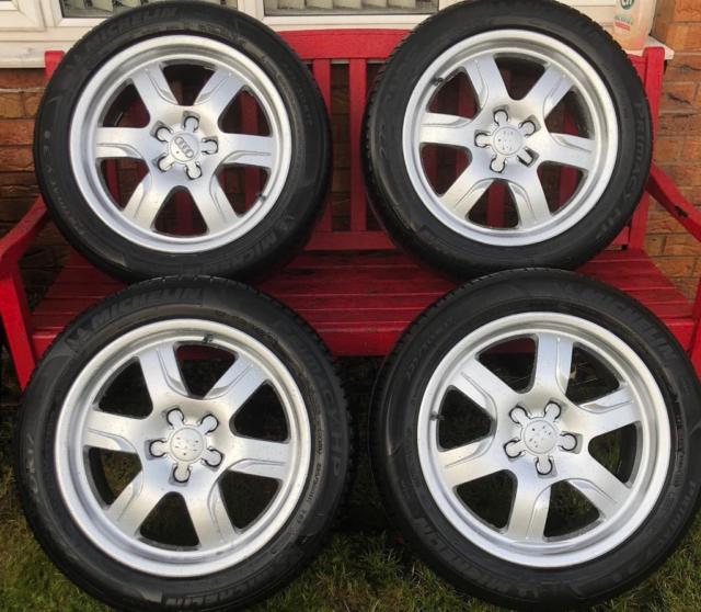

Hi there. Looking at a set of Audi A5 alloys. The seller says they will fit my car but just want to check if anyone on here knows for sure. They are a 17" 6 spoke wheel with a small dished lip on them. Thanks

5 x 112 fitment not sure on the et or offset m8 my pal has Mercedes alloys on his both offsets fit fine hope this helps

Depending on what wheels they are the offset could be as much as 26mm different. The Mk2 Leon runs quite high wheel offsets.
Might work if you fit narrower tyres and stretch them. Not sure whether that would look good or drive well though.

Okay that looks like Audi part 8T0601025B
7.5" ET28
Standard fitment 7.5" wheels for the Mk2 Leon are ET51
So it would be the same as running standard Leon 7.5" alloys with 23 mm spacers. I've never tried it but I'd be very surprised if there's enough space in the arches for that.
