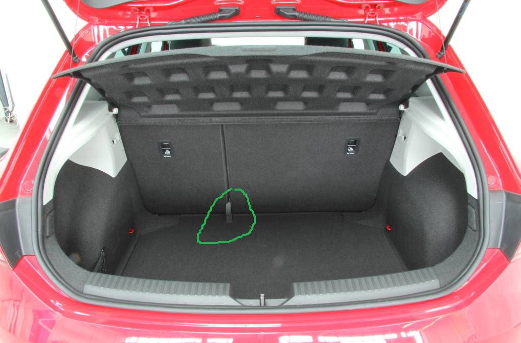

Taped the seat latches. Didn't work :-(
Also thought it was this....as I noticed it was a bit of loose plastic on metal:
I taped it up, drove down the road and cheered as I thought it was fixed...only for the sound to come back moments after! Aaarrgghh!

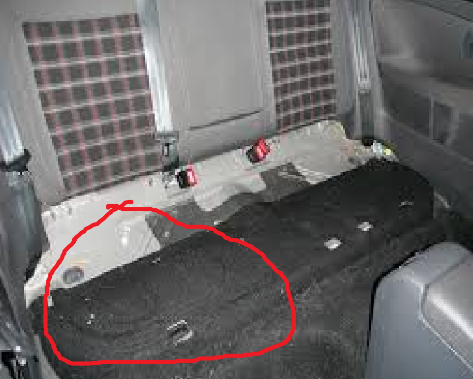

Okay, so I've finally figured out where the noise is coming from! That's the good news. The bad news is that I don't quite know how to get to the actual source as it is coming from under the rear seat bench. I am able to unclip the rear seat base which exposes the metalwork of the car, it's coming from under that!
(This image is from a Golf I know, but it's just to illustrate where the noise is coming from)
This means it could possibly be coming from the underside of the car, this would explain why the noise seems to be less once the car is thoroughly warmed up.
Might need to take it somewhere to get it looked at properly...alternatively I'm wondering if just getting some proper sound deadening might muffle it enough to stop it being so audible inside the car?
