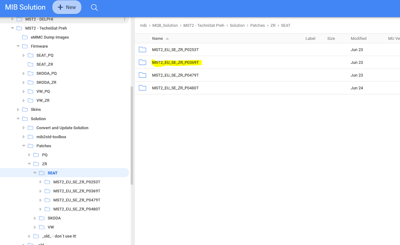

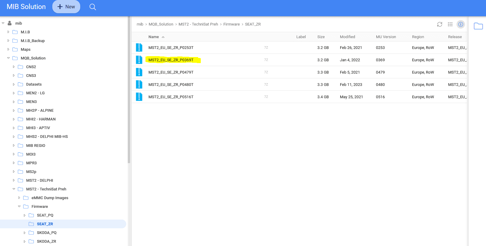

The miracle solution requires firmware 0369. You have to install it yourself.

you have to update the firmware so that you can install a patch. It couldn't be easier, sorry

Some info for you - all at your own risk of course:
You need this firmware, then follow the instructions in my post if you want to try it.. like I said there's a risk you may lose settings so again at your own risk (but it worked for me in the end however I am quite technically minded!)
Then the patch:
