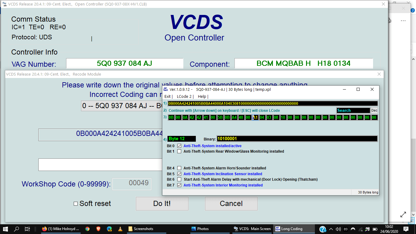

OK had another good search, and found a YouTube video where someone had done this to his Golf 7. So had a play.... and found all the settings he said were already active........that was looking at the adaptations in the 09 Central Electronics.
Having a look through the basic coding, without going through the security access for the central electronics, found one entry Anti-theft system alarm horn/sounder installed on a tick box. Switch this off, and the alarm chirps through the car horn.
Might have to go back to the siren though, horn might be a wee bit too loud!
