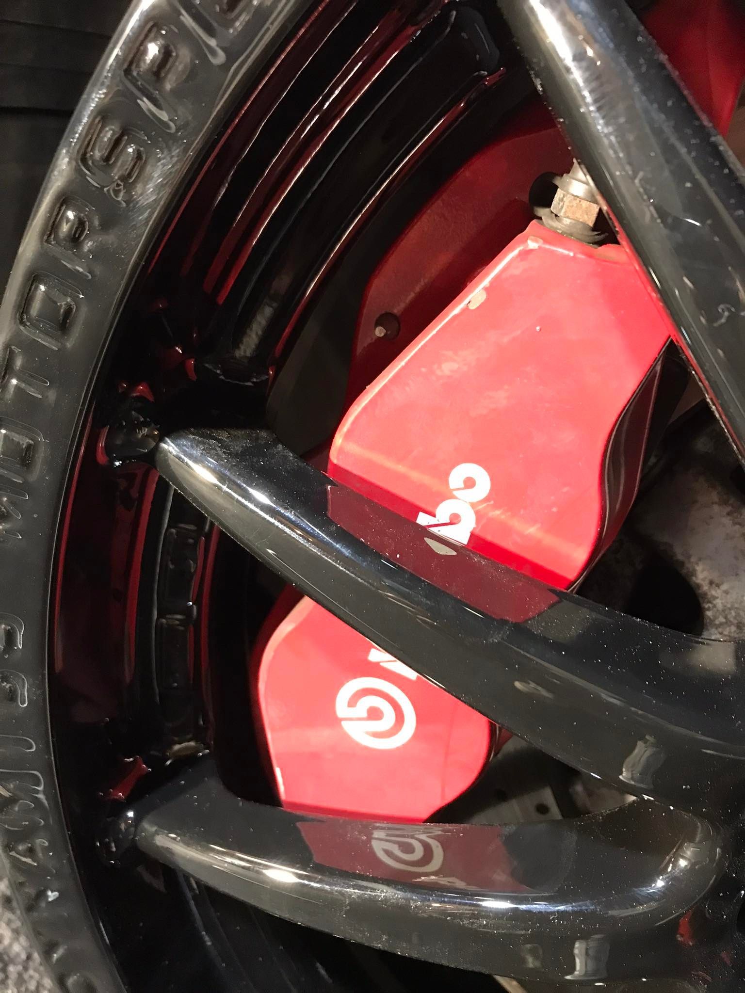

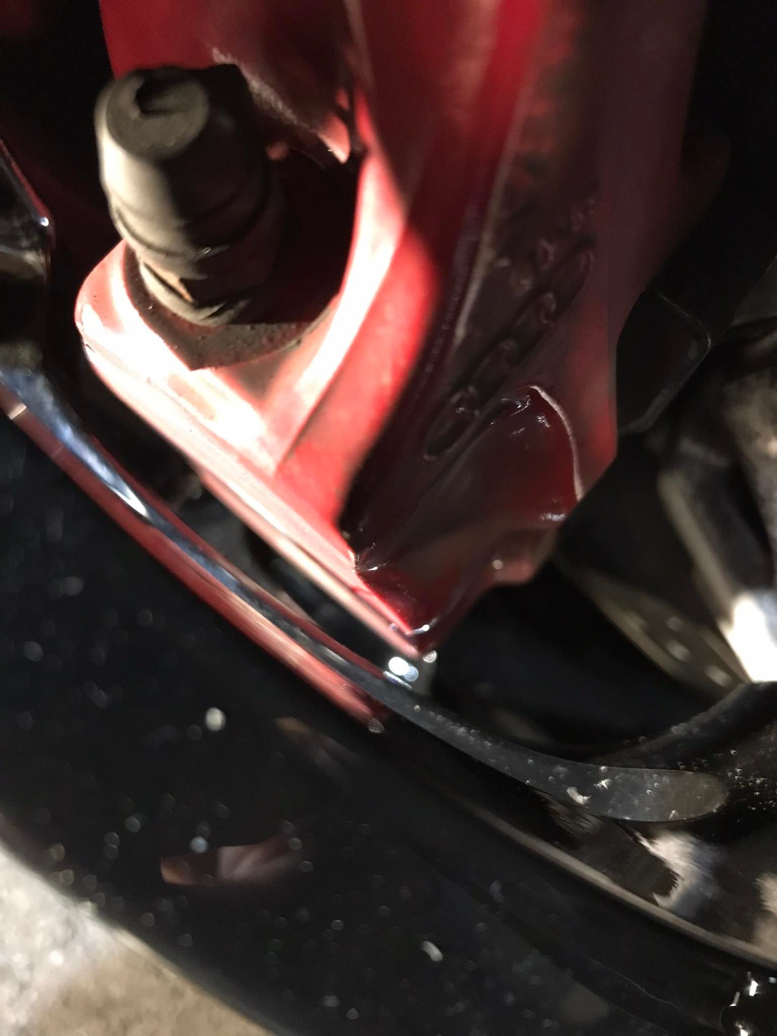

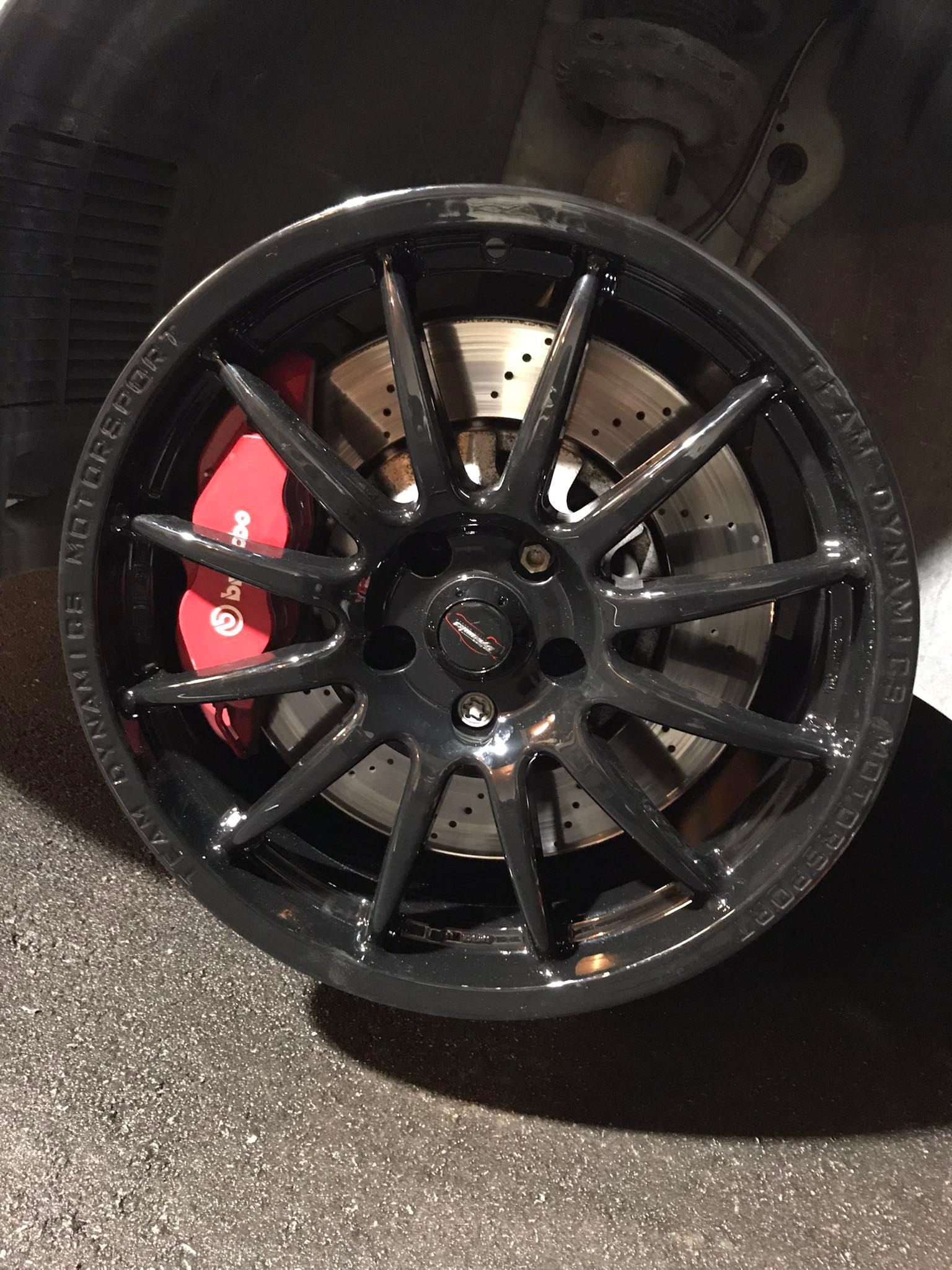

Tidying up today I found a note of the minimum internal dimensions of the Team Dynamics ProRace 1.2 in 18". Diameter of 416mm (which fits) is easier to compare with other wheels than guessing where the dead centre is. These came from reference to technical info at Rimstock (manufacturer).
My contrast my other 18" TD wheels are too small at only 404mm int dia.
Mrkun
Nov 3, 2021
Some photos of 18" Team Dynamics ProRace 1.2 8x18 ET40, just got them today and did a quick test fit:
