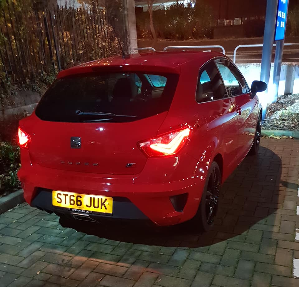

Nice motor! I am a fan of red and black!
Got any plans for it?
May I recommend blanking out your number plates in the pictures as people have had issues before with plates being used on other cars.

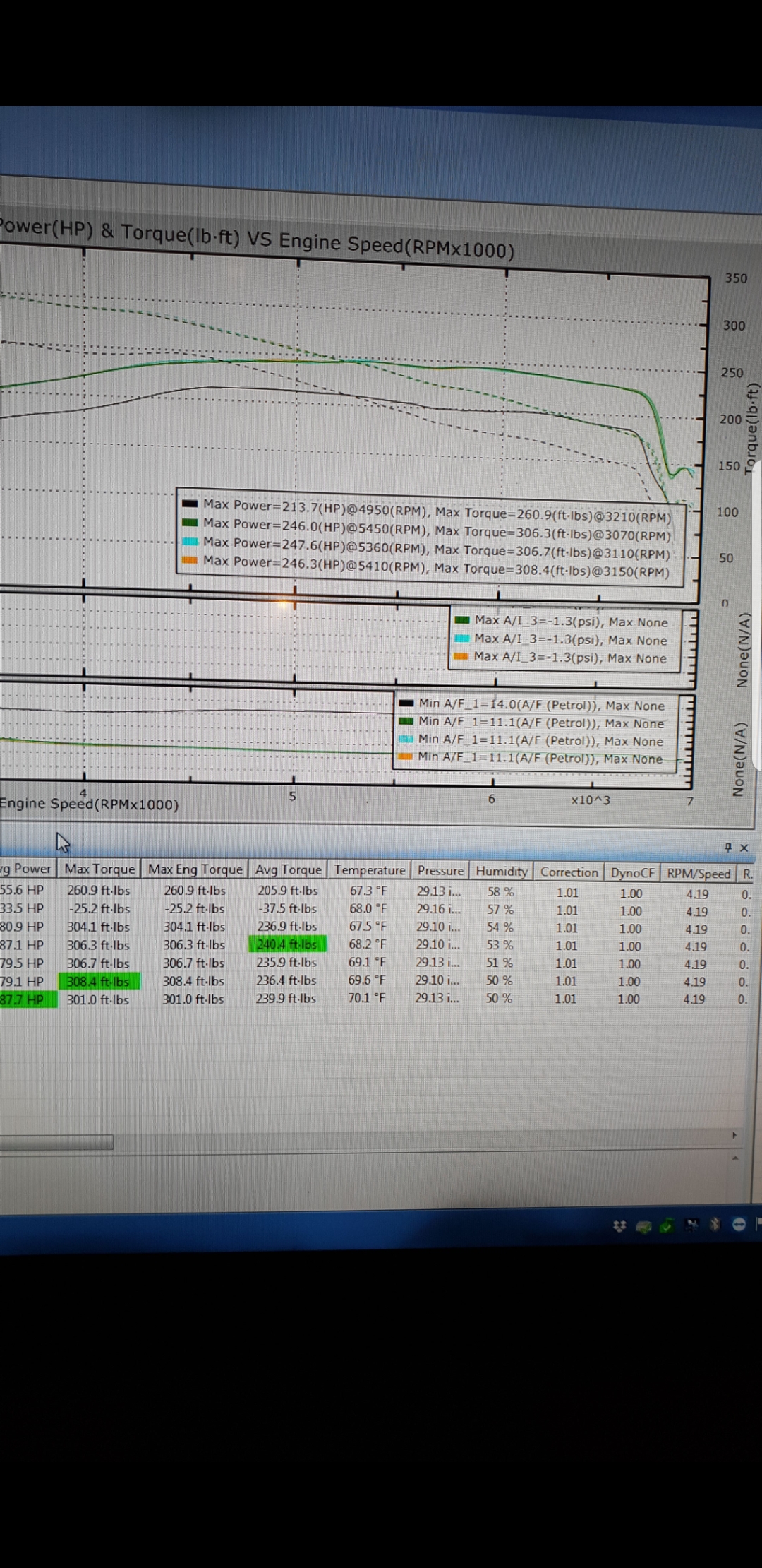

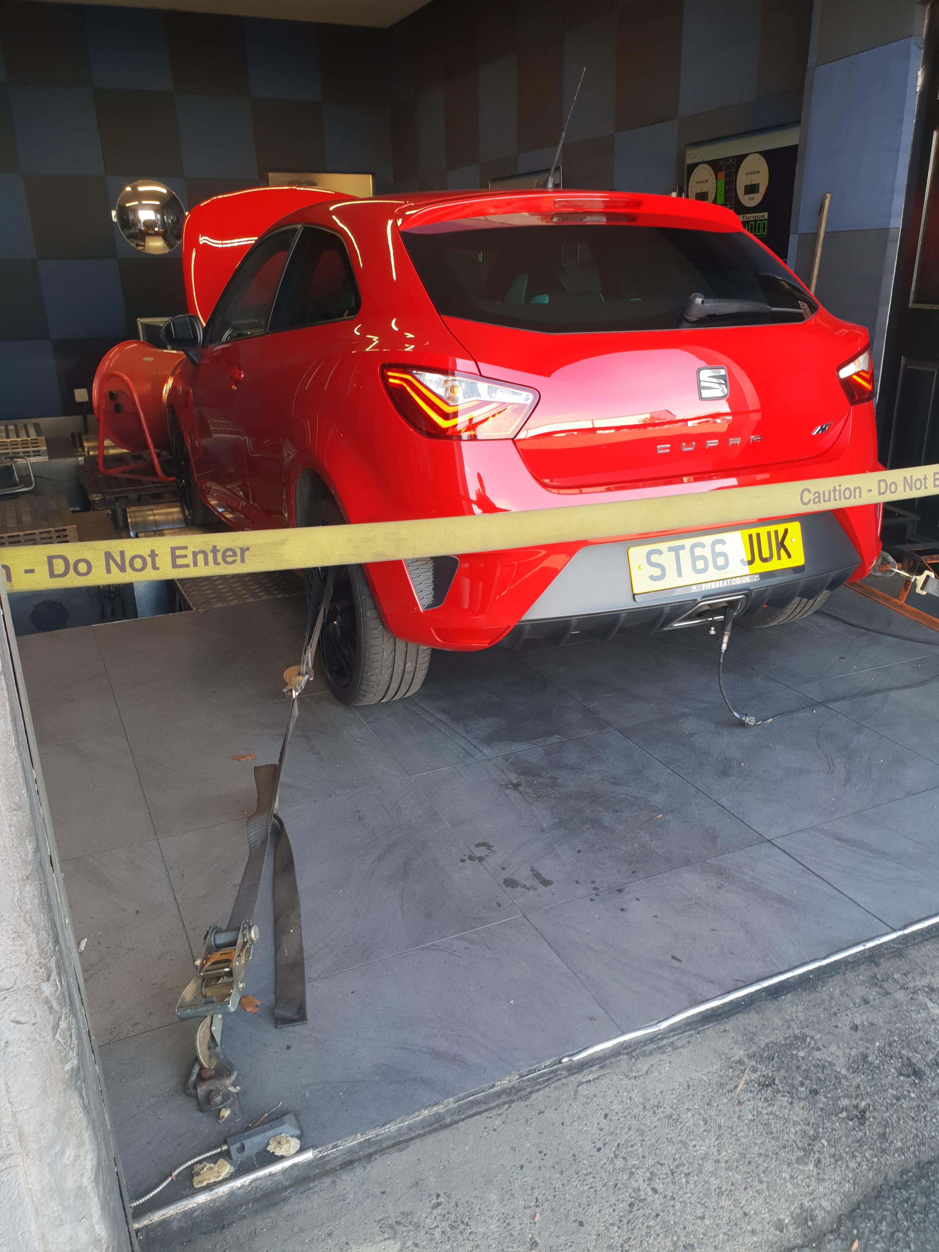

Had the car mapped last week using APR software. I can confirm the EA888 gen 3 engine puts out a lot more power than 192, I've heard quite a few people say they make around 210 standard, with just a Pipercross panel filter and on V Power it made 212. With the new software it's running 247bhp and 306ft-lbs/415nm.
Very happy with the results and feels like the car should always have had this power. The standard exhaust is very quiet so I'll get a resonator delete or a custom system fitted soon.
