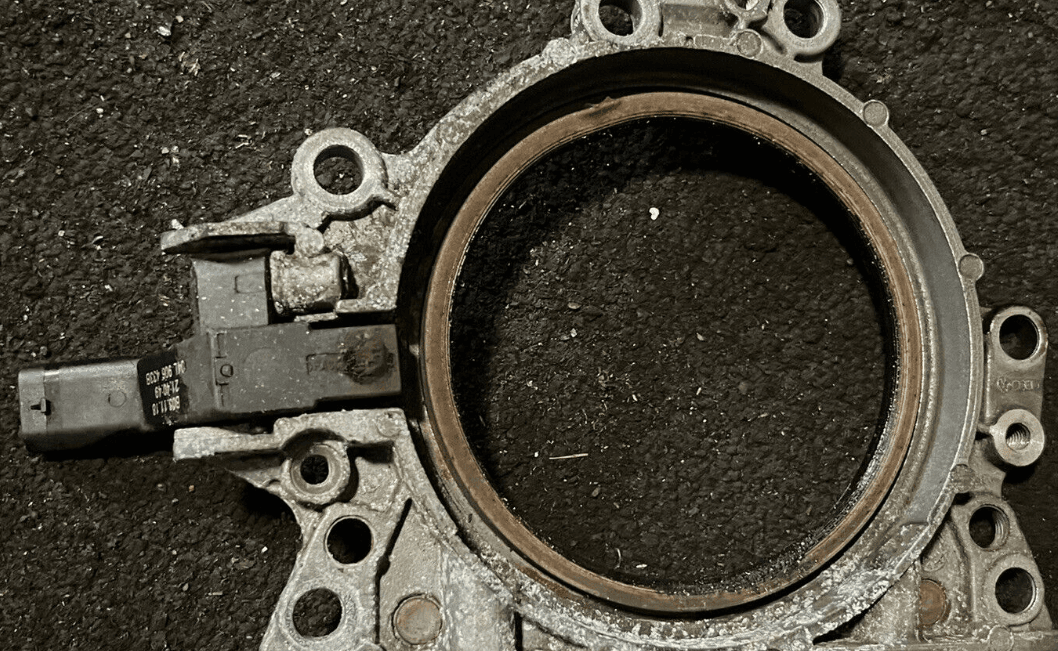

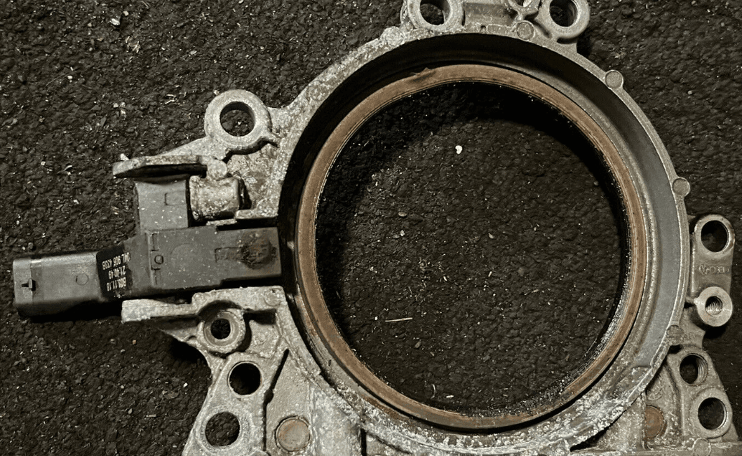

An update on this from my situation I have replaced my old crankshaft sensor today. It a bit of a pain to get it out and back in securely and I had to remove the oil filter housing to get to it so did an oil change too. The old and new sensor side by side in pictures. I took the car out for a drive and seems slightly better to pick up on acceleration and didn’t encounter the power cut at all. Hoping that this has solved it but if it hasn’t at least I know the other sensors are easier to get too ! 😂
Can confirm all fixed and was crank sensor 👍🏼

Car just would cut all engine power for about a second on acceleration then continue as normal and jerk the car - it didn’t show any other symptoms but was running abit rough post changing I noticed it’s much smoother.
no I didn’t take the whole housing off, I just took the cap off for the oil filter and replaced the rubber seals when I changed over the filter. They come in the box. I don’t think you need to do an oil change you can just put a new one in and top up the oil if you wanted.

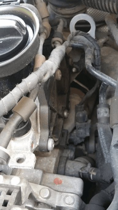

ah, so you managed to change the crank shaft sensor with only removing the filter & filter cover? and not removing the whole oil filter housing/bracket - any advice as I looked at doing this but struggled with access.
Yes it’s very tight I had to use my phone camera to see what I was doing. I bought a set of long hex attachments 3/8” drive from Wilco to get to the 4 mm hex screw.
you want to be able to stand under the car as laying down under the car will just make it even more difficult.
nice, thanks, i'll try again! See if I can use the 2 poster at work - rather than on my back at a jaunty angle on my drive!

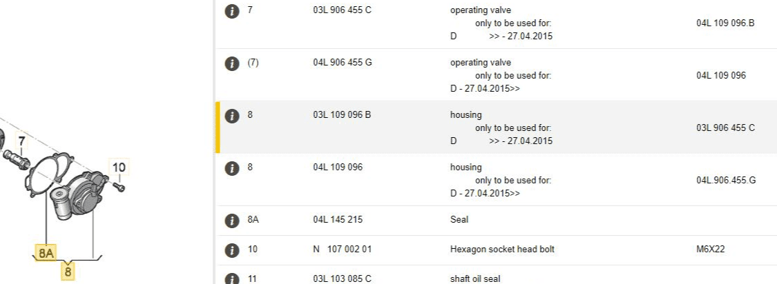

There are a few different parts numbers depending on your engine/year.
My impulse crank sensor for example, on my 2015 184 CUPA engine is 04L906433B
