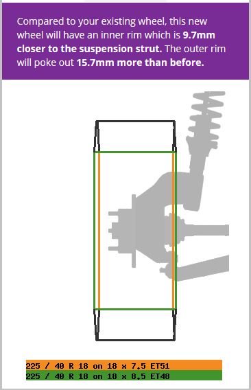

I would take the advice above with a pinch of salt...
The Standard Leon 18" wheels are offset 51 and 7.5 J wide, so the wheels you are proposing will stick out more, and also the inner edge will be closer to the strut. whether you get rubbing issue or not I'm not sure
Personally putting 225/40 on an 8.5J rim will look stretched and, well, ****....

The offset (ET number) will determine how much more or less your wheels are tucked under your wheel arches or protrude outwards. The lower the ET number, the further the wheels will extend outwards. If the offset is too aggressive (a low ET number), you run the risk of your tyres rubbing the wheel arch edge.
So, if the standard wheels on your Leon are 18” diameter, 7.5” wide with an offset of 51 (i.e they are 18 x 7.5j ET51), and you were to fit, say 18 x 7.5j ET 45 wheels and keep the same size tyres, you would have 6mm more clearance between the suspension strut and the inner face of the wheel and the outer face would ‘poke’ out 6mm more than your original wheels.
There’s a very handy offset calculator on ‘will they fit.com’ (https://www.willtheyfit.com/). If you input the tyre and wheel specs for both your existing and new wheels and tyres, it’ll calculate the impact on clearance between the inner wheel face and suspension strut and any increase/decrease in ‘poke’ of the outer face.

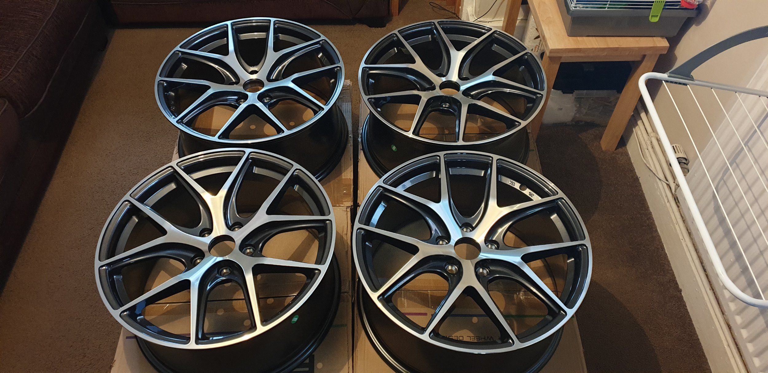

Can some help with some info needed I have just bought these wheels , I ordered 8.0 J but got sent 8.5J would i be OK with no rubbing issues going to put 225 40 18s on them they will be going on my mk2 seat leon not been lowered and wont be getting lowered will this set up be OK, any of you guys running this set up 18s 8.5J et45 with 225 40 18 tyres
