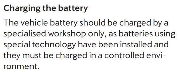

Did you know, that user manual forbids car owner to charge vehicle 12V battery? This was new to me and what direction we are going. When my car battery voltage low or battery is flat I need to tow the car to dealer and use tow trucks for that... what?
Page 336 in owners manual:

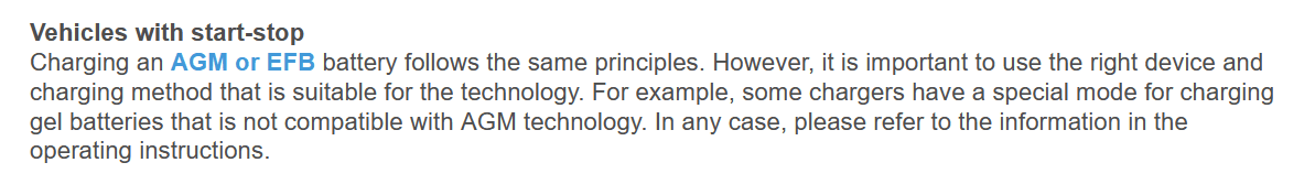

This "special" technology is EFB battery, the charging program is the same as AGM battery which is used for many years. I've have had CTEK smart charger for many years and charged premium car brand batteries with no problem. Old Mercedes AGM battery lasted 11 years, newer Mercedes battery lasted 3 years. Now Cupra battery is almost flat in less than a week after the delivery?? CTEK lists EFB chargers as special new chargers and filters out AGM chargers from the EFB list. So buy a new charger. :D

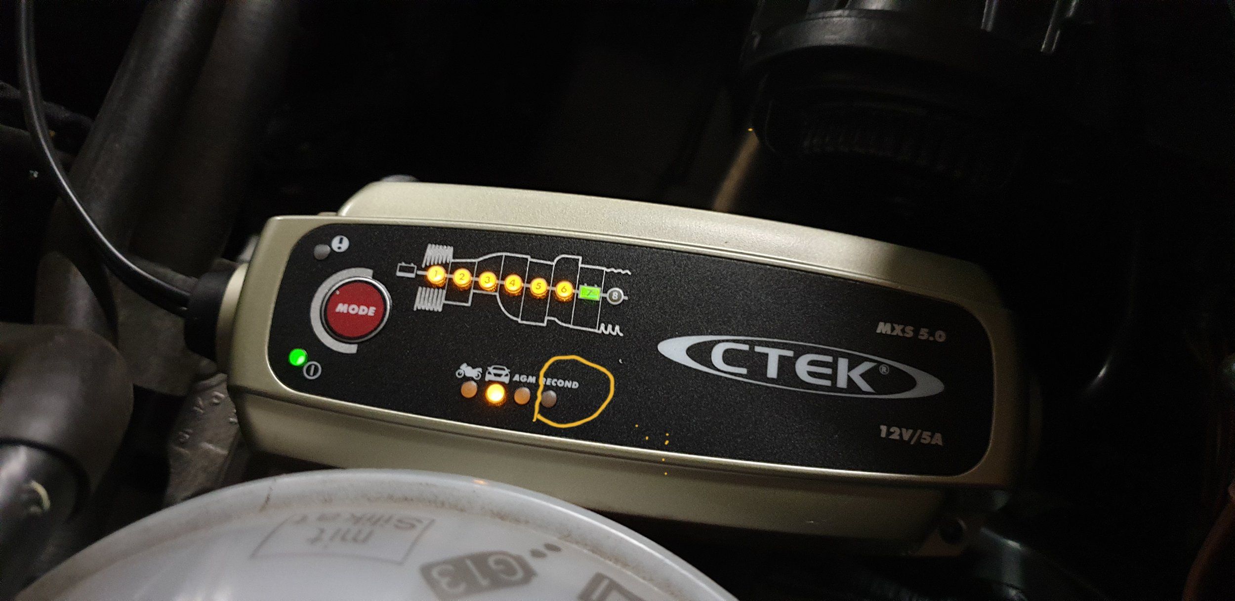

@andylong -Yes I understand what you mean. There are risks if you do it with wrong mode active.
If you disconnect the battery without a backup (parallel connected) battery you get error codes which some are not possible to get rid of without resetting them with tools like OBDeleven / VCDS.
Some settings need to be reseted as date/clock values.
No big deal but as I have written it should not cause you any problem if you do it the right way according to Ctek instruction. Then I mean ordinary charge NOT the RECOND mode!
I have never used RECOND mode so I can’t say anything about what happens then.
If I will do it in the future I will remove the battery from the engine bay, a couple of meters from the car ;).
RECOND mode in yellow circle:
