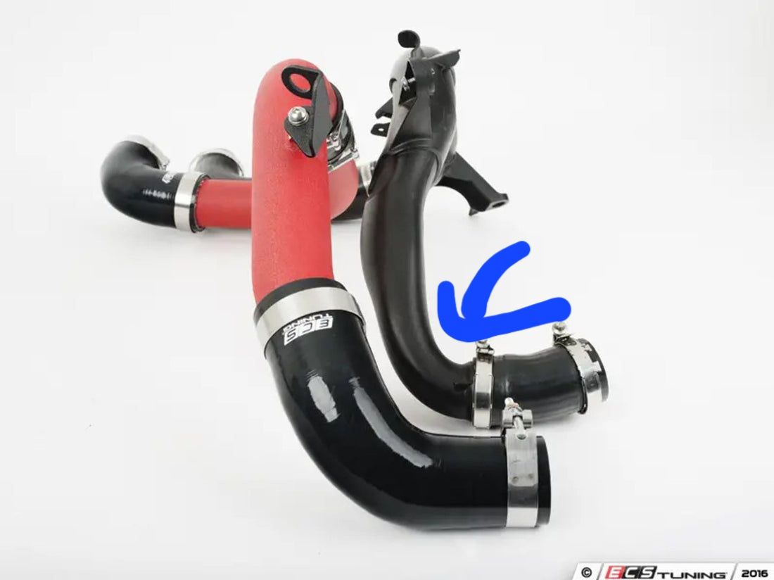

Thers a intercooler pipe that goes over the gear box down into the intercooler comes from the turbo were u do the muffler delete look how resistive that pipe is most ppl over look that pipe change that if its in ur budget ecs tunnig did a video on it

Thers u bottle neck right ther think ecs got nearly 15bhp off changing that one pipe sure it was 15 best watching the video

Thats the creation kit cheapest option the ecs kit is twice the privmce from awsome but if u go on ecs tunnings website u can buy that one pipe for around same price as the full kit from creation

My mates would if defo seen 400+ with that pipe i told him he bought an inlet manifold instead rtech wouldn't put it on haha 350£ wasted
