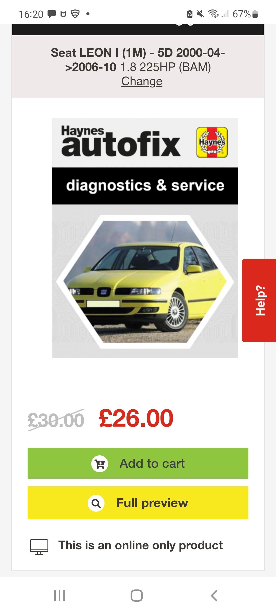

Cheers all, been watching the Decimal Tenth videos but what I will need is a Haynes type manual for all torque values and tolerances etc.
I know they never did a Leon specific but assume the golf mk4 would be the best match?
Dazzalcr
Aug 10, 2019
298
279
Lancashire
Hi bud, they do a digital online version you can buy, don't know if that's of any help
