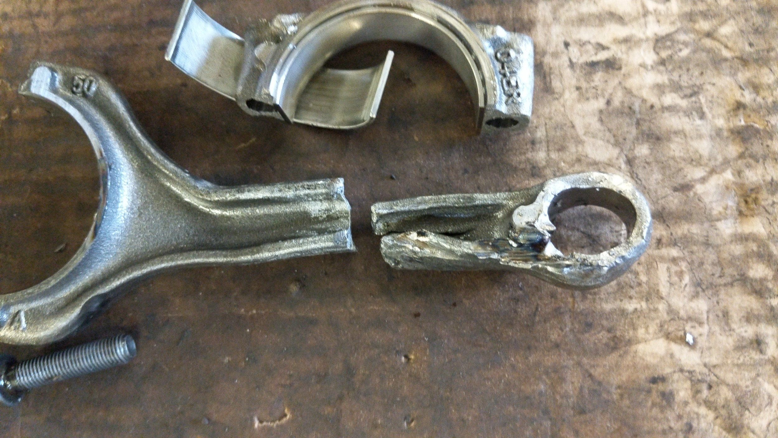

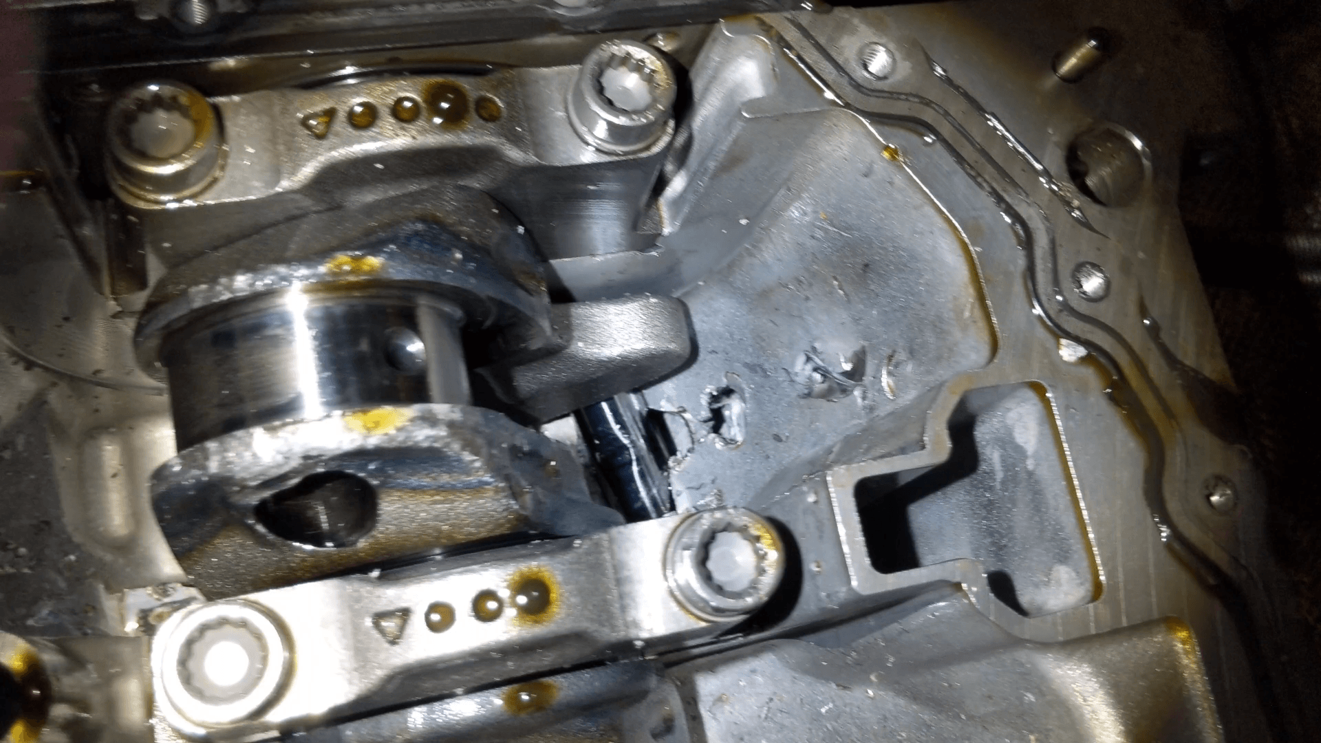

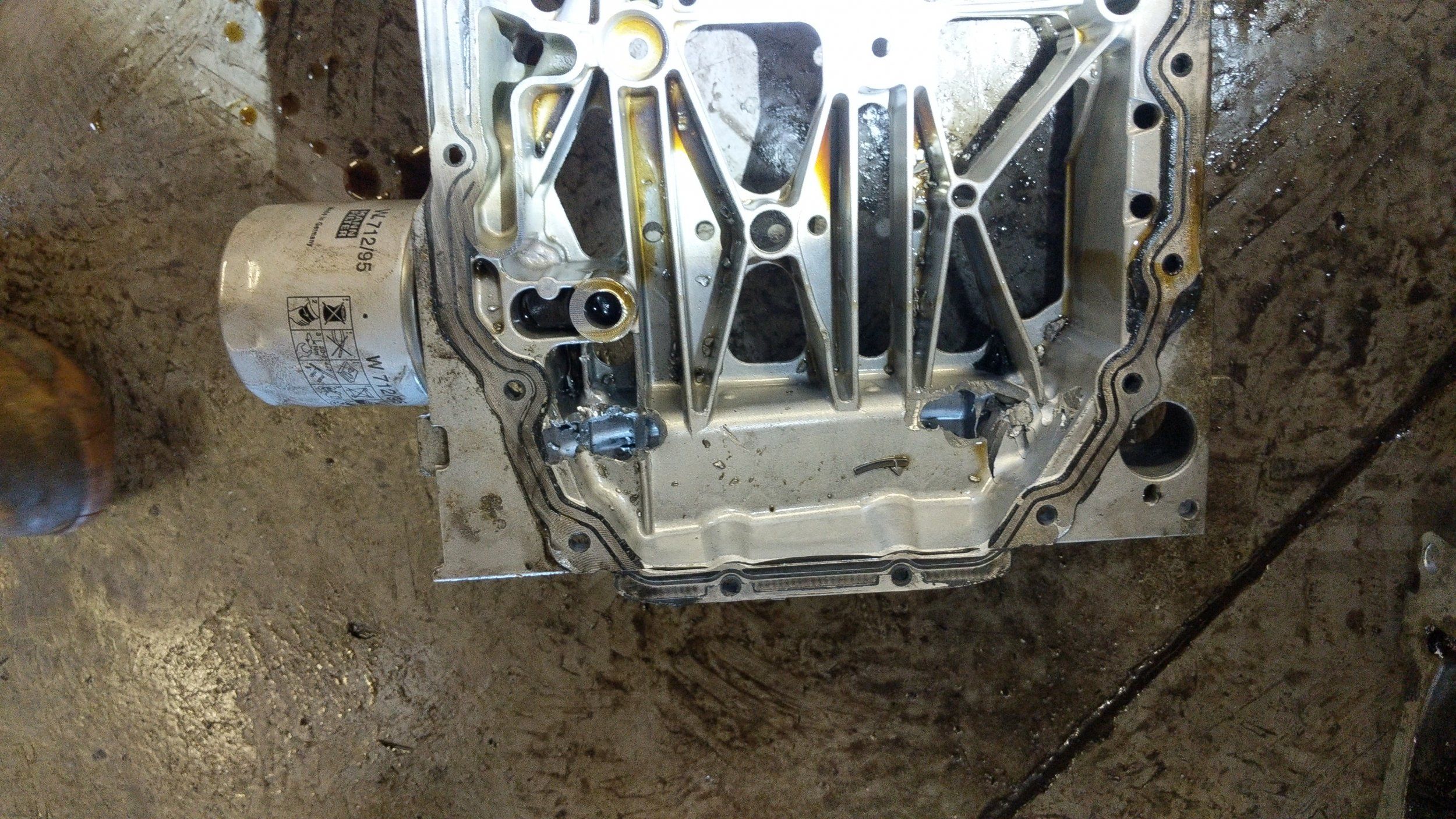

Back from holiday today in one of Enterprise's finest Insignias. Here's your Friday evening update on my engine damage.
Today I learned what a Gudgeon Pin is. Mine is stuck in the engine block (shiny bit on second picture). Bits of rod excited from many points, mostly via sump, but some nice chunks from elsewhere Good news, erm... Head ok. Gearbox ok. So "just" new engine block and sump needed...
No cause known yet.

Well, that's certainly an impressive failure!!
Very interested to know what caused it. Haven't seen a snapped rod for a while myself!
Incorrect timing could have put excess strain on the rod (igniting while the piston is still on the way up) but you should have noticed a lack of power, and an annoying noise, if that was the case.
The oil loss may have been a red herring and only come out of the holes after the rod snapped. Airflow around engine bays blows it in weird places.

I also had a rod fail on a Peugeot 18 years ago, ended up having to replace the engine at my cost. Which is why I switched to Seat when I finally replaced the car. Hope things turn out better for you, at least you have a single garage to deal with my only option was going direct to Peugeot.
I’m no mechanical engineer but it doesn’t look like a lack of oil was the problem. The bearings on the crank seem in good condition, looks like the rod failed under load. That can happen when the rod has a fault during manufacturing (which was my problem) or if its been stressed – say for example by incorrect timing. Only the garage that did work would know how long the engine ran with incorrect timing while the problem was worked on.. Also if the timing was correct or just close enough not to throw a fault code when it was returned to you.

Thanks for replies!
I'd agree it doesn't appear to be a lack of oil, damage limited to one cylinder and others seem to have no marking.
Timing is apparently still correct.

The sequence of events is unfortunately a familiar one. Problems with the initial install of the timing belt resulting in piston damage, most probably in the form of severe indentation or cracking, the piston is a fairly lightweight design and under load can easily fail and then the connecting rod and gudgeon pin become a metal flail causing damage like in your images. If I am seeing right is that the gudgeon pin I can see laid there? Where is the piston or the remains of it? As already mentioned I think you need to get some legal advice if you need to get tough. Bear in mind that the standard of proof in Civil cases is based on the balance of probabilities, and I think we are all on the same page with this one!
