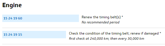

I get a similar schedule info on the 110kW 1.4:
So check timing belt condition at 150,000 miles.
The problem with 'checking' the timing belt - I believe to check properly you might as well change it!

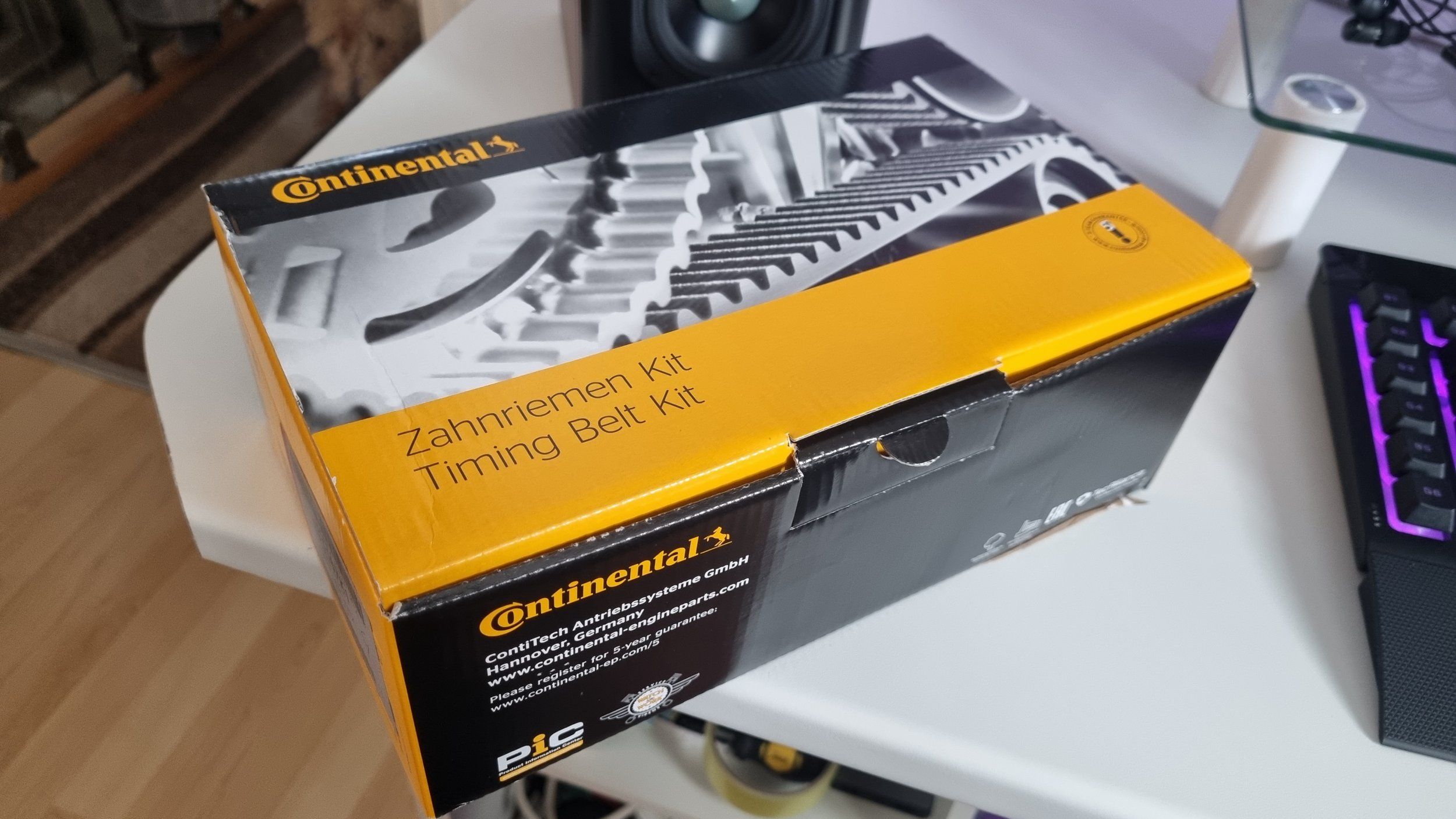

I have just had my continental cam belt kit delivered this morning, and bit undecided about when to install it now.
How hard can it be for a straight answer from SEAT

There is no 'TIME' dependent requirement for replacing the timing belt from Seat. That is quite clear.
There is a 'check condition' requirement at 150k miles.

I am certainly not trying to avoid doing it and am fairly cautious myself. I had the below delivered from Autodoc in Germany this morning.
Just annoys me how you cant get a straight answer and how one garage will say the other one doesn't know what they are talking about
