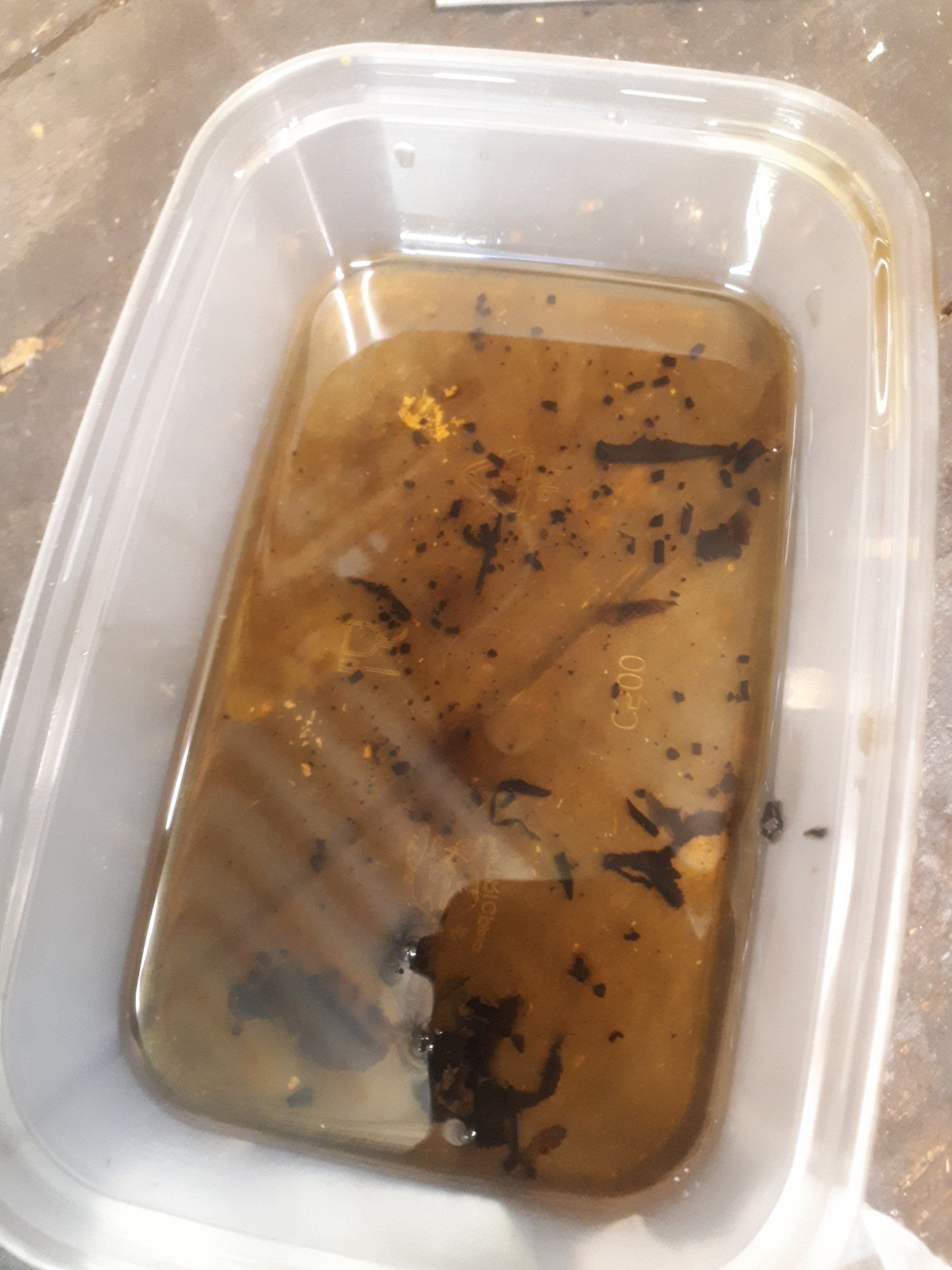

Someone was enthusiastic with the sealing goo on the sump at some point in the past, most of it appears to be in the oil pump pickup gauze.

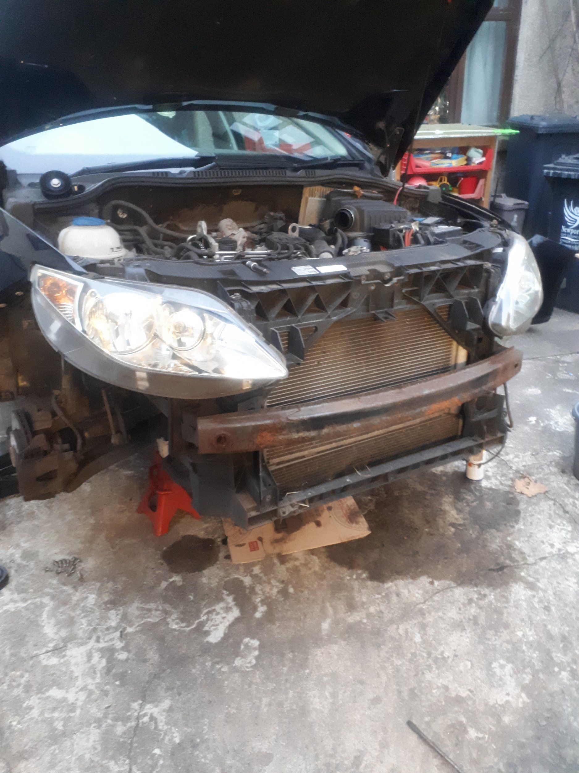

Bumper didn't need to come off in the end, but it was a bit easier to see the timing end of the engine from different angles with it gone.
All this old RTV sealant came out of the oil strainer pickup tube (the fluid is diesel):

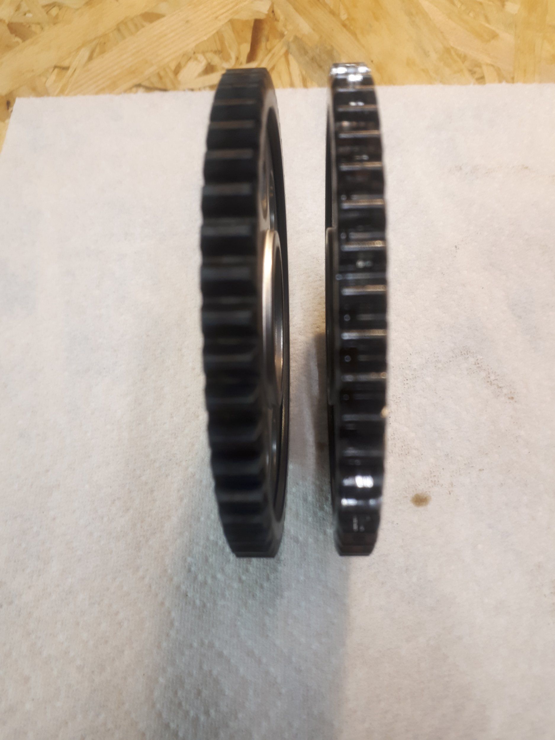

New (rev G) & Old (rev D) crank sprocket, new one is about 1mm thicker on the timing chain side
New (rev F) & old (rev C) cam sprocket, again new one is about 1mm thicker.

Pressing new sprocket onto crank shaft, bake at gas mk6 for 20 minutes before hand, and work quickly, using old crank pulley bolt to press it on with a short length of tube.

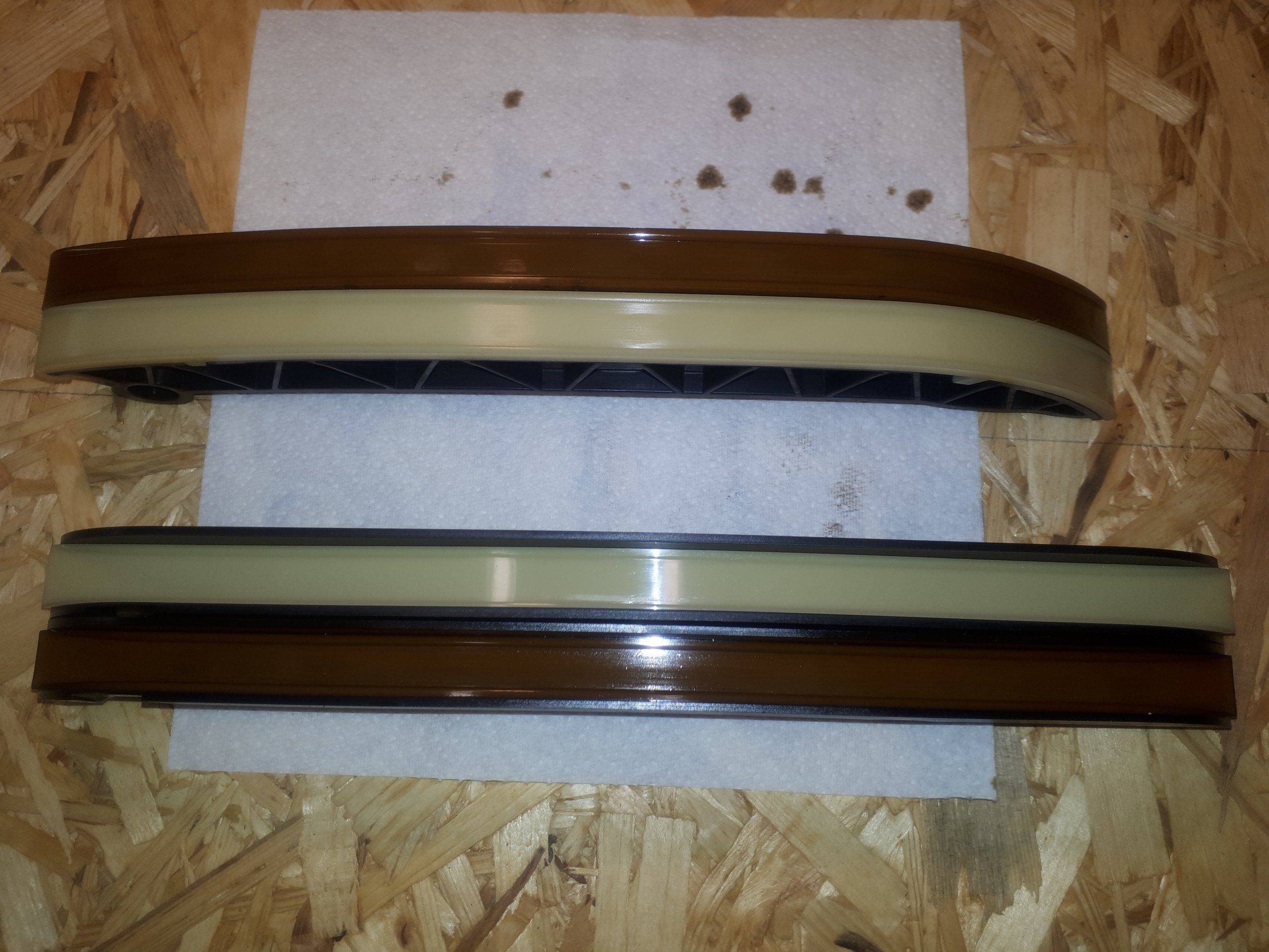

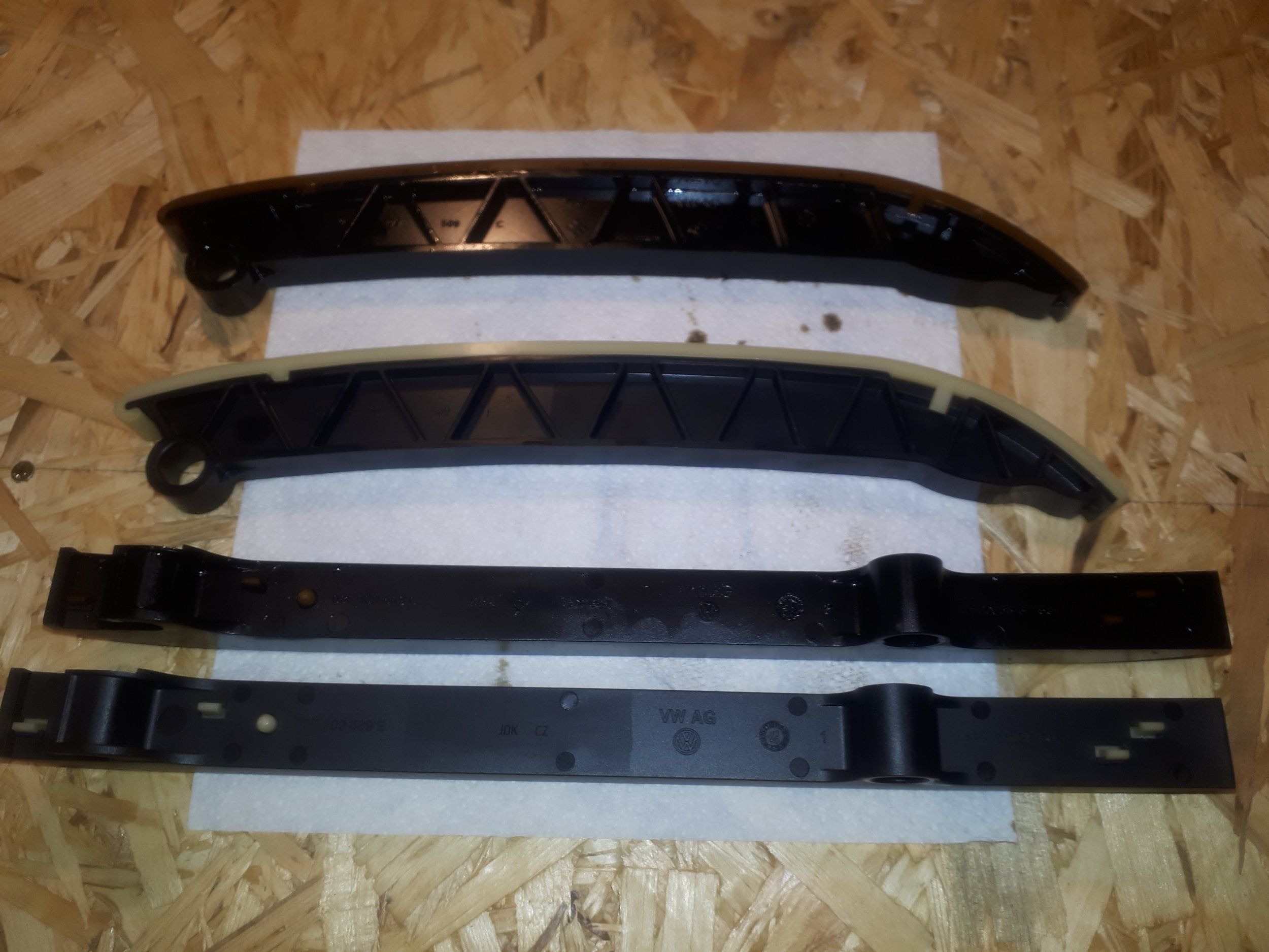

New (rev C) and old (ref E and F) chain guides, no difference to the depth or general shape
Width of new guide rails is a bit wider by 1mm or so.
Next task is to put the front bumper back on, and when the oil pump chain shows up fit that, the revised sprocket and then put it all back together. I'm also waiting on a spark lead puller so I can turn the engine over on the starter to prime the oil system before firing it up properly.

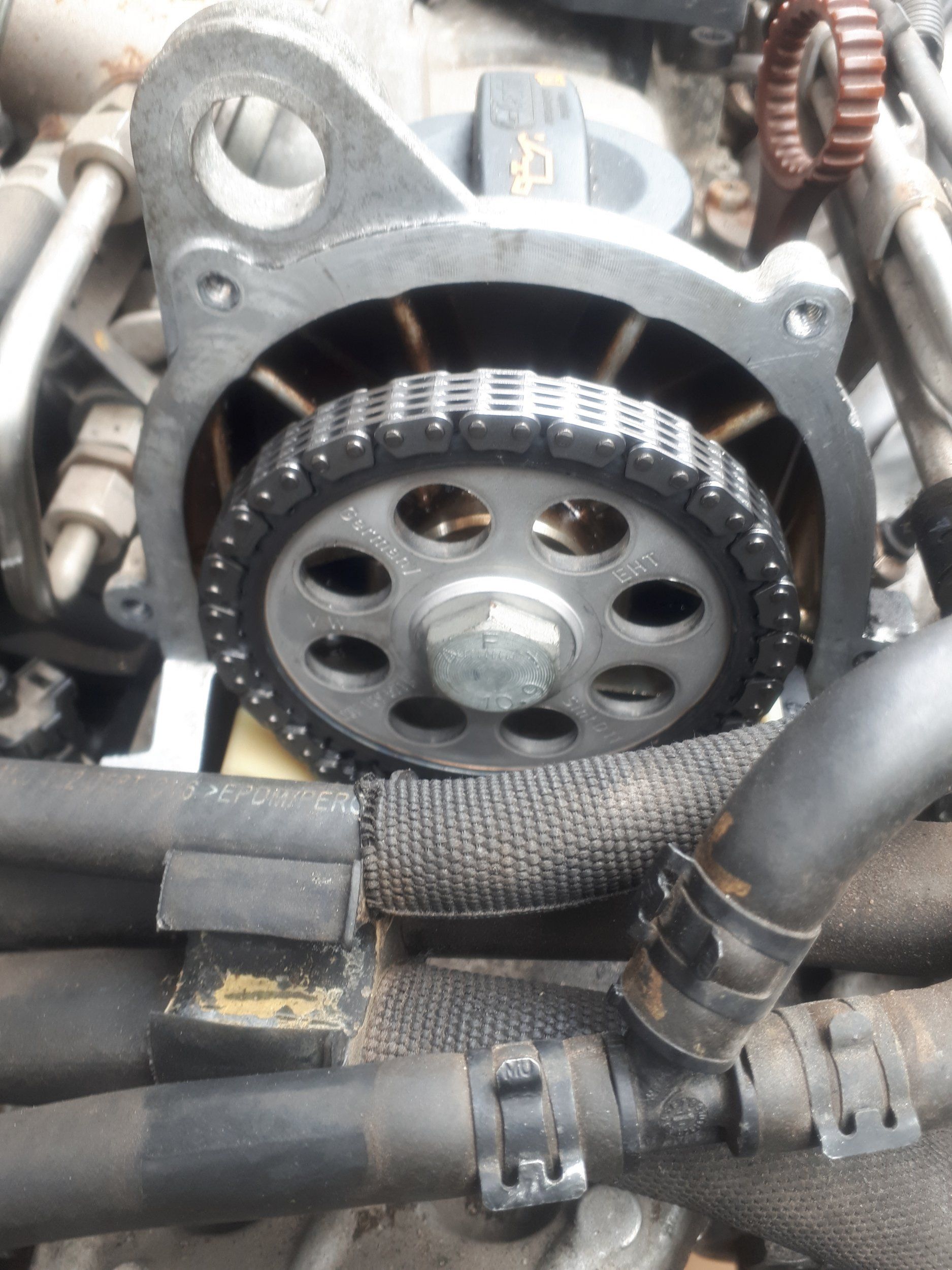

New oil pump chain and sprocket fitted

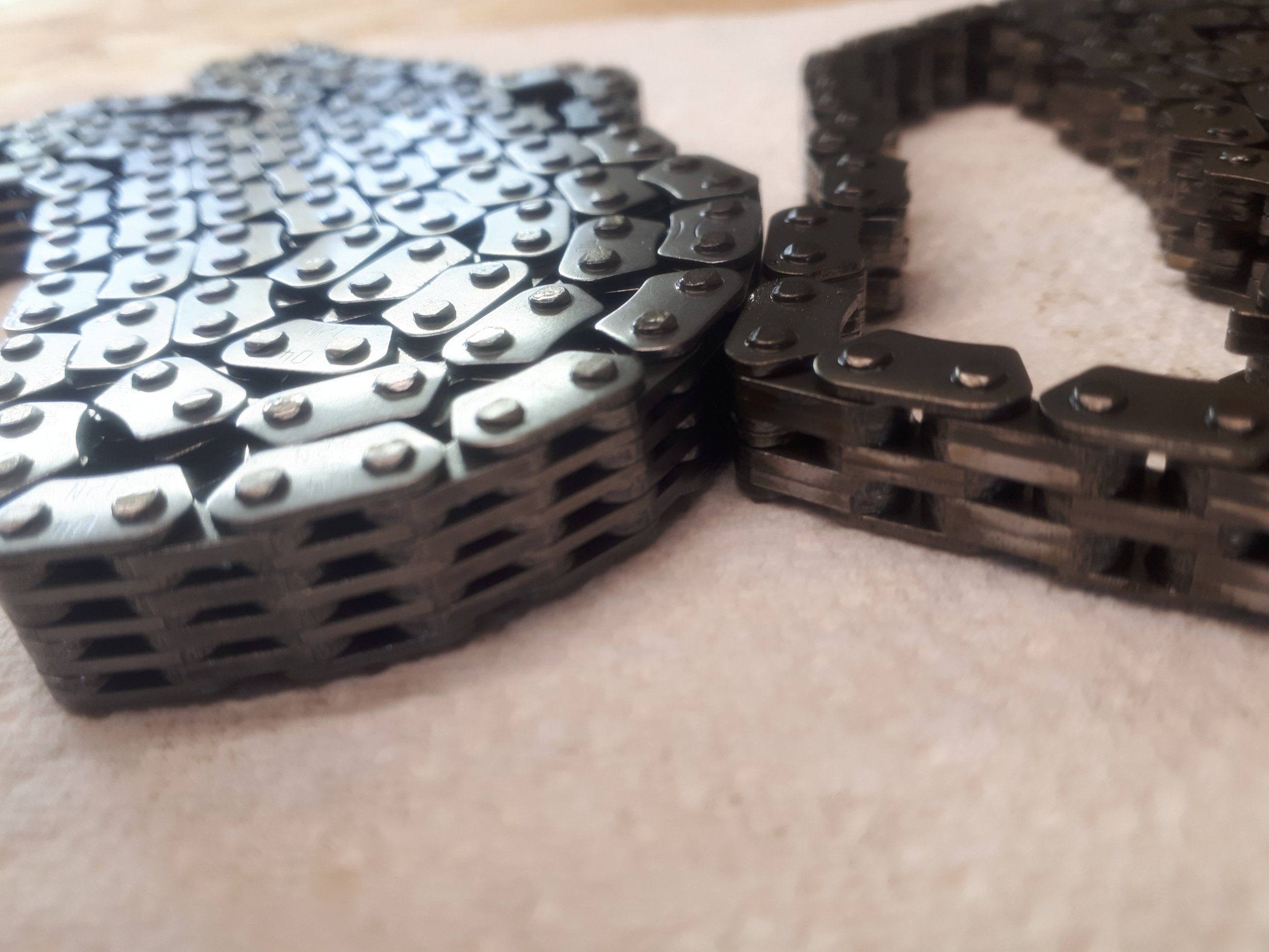

New (left) and old timing chain
Fitted and timed up
