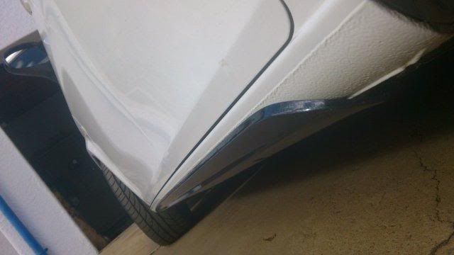

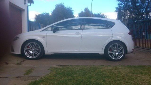

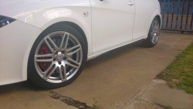

Not too difficult to guess what car these are off :p
I made myself a template of the Leon side sill curvature and depth to the support seam. I then used the template to check the donor car's side sill profile. It was an exact match. Ill be removing the fake carbon fibre and have them sprayed gloss black to match the rest of the Cupra gloss black goodies.
Im liking the look, its really subtle but does a good job of giving some added appeal to the side view of the car. Excuse the rubbish cellphone pics.

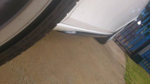

Before:

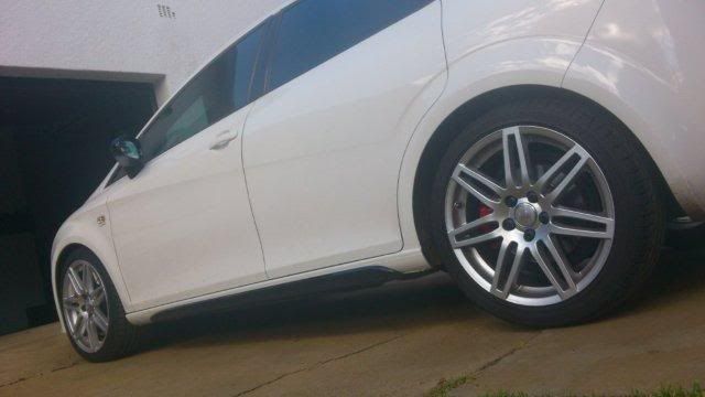

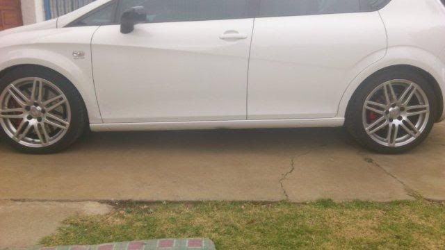

After:

Well done Hubbly, looks very neat and can imagine how much it would have costed from the stealers.
By the way, Hubbly does most of DIY mods for us down here in SA and he is a true master. Where is the mod thread dude, show it off...all of it! Am very proud of you.

Hubbly how did they attach under the car and are the genuine items?. I've seen full carbon versions on ebay. Do you have the part numbers?
hubbly_bubbly
[center][img]http://i374.
Aug 18, 2008
399
Johannesburg, South Africa
Thanks T, appreciate the kind words! There you go, added link to Mod Thread ;)
Allan sorry i dont have the part numbers, i remember seeing them somewhere when searching on google for Golf 6 GTI side skirts.

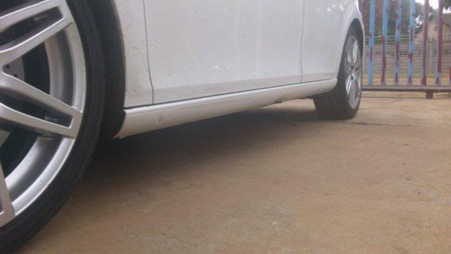

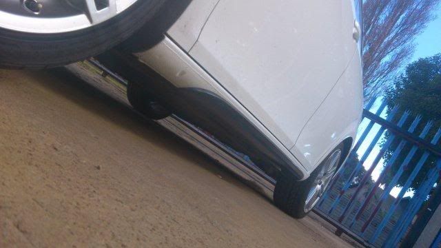

Within the skirt there is a strip like braket that the skirt clips into. That bracket gets screwed onto the side sill and then the skirt clips into the bracket. Under the car there are supposed to be 2 or 3 other brackets which i didnt get as I bought these from someone with a GTI and he needed those brackets for the new side skirts. I just use the holes in the underside of the skirt to cable tie it to the welded support seam (that is used for jacking up the car). Took all of 30mins each side so not a difficult one to do.
