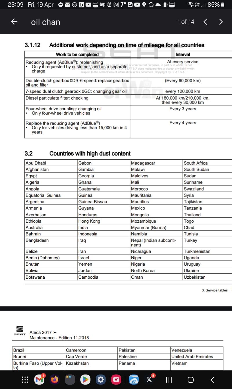

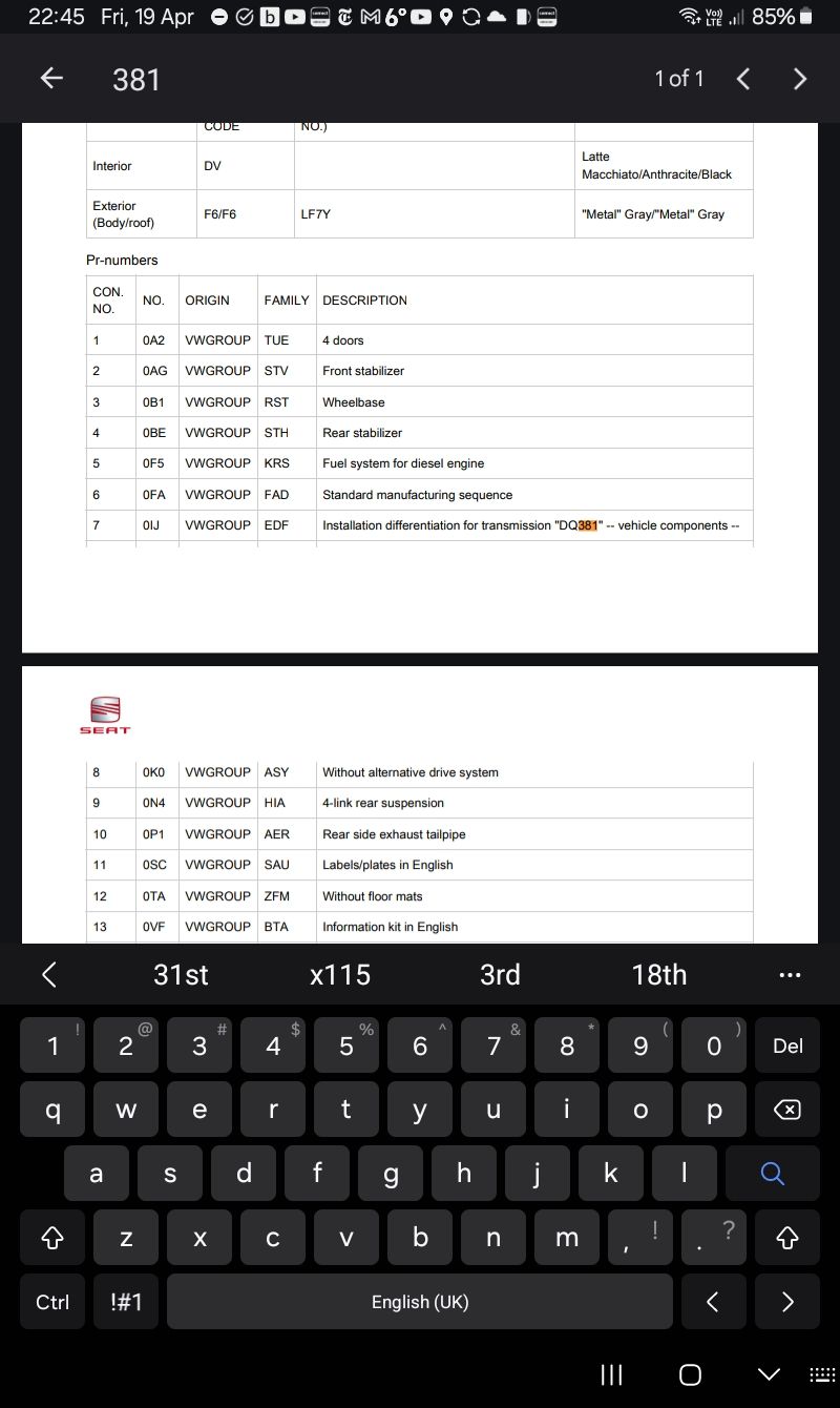

Hi All, I have a 2018 Ateca Xcellence TDI 190 4Drive with a 7 speed DSG, I've been trying to find out when the DSG needs its service but can't find any details in the user manuals. I have spoken with several different dealers giving them my reg and VIN number an have had a different answer from each one, including 40K, 60K 70K 80K & "it's a dry box and never needs a service". I've even contacted SEAT customer services, who asked several irreverent questions before promising to get back to me 2 days later and never did.
As a result I've decides to try and research it without involving a SEAT dealer, but I need to know which gearbox I have as there appears to be several 7 speeds with different requirements:
So how do I know which I have?
Thanks.
