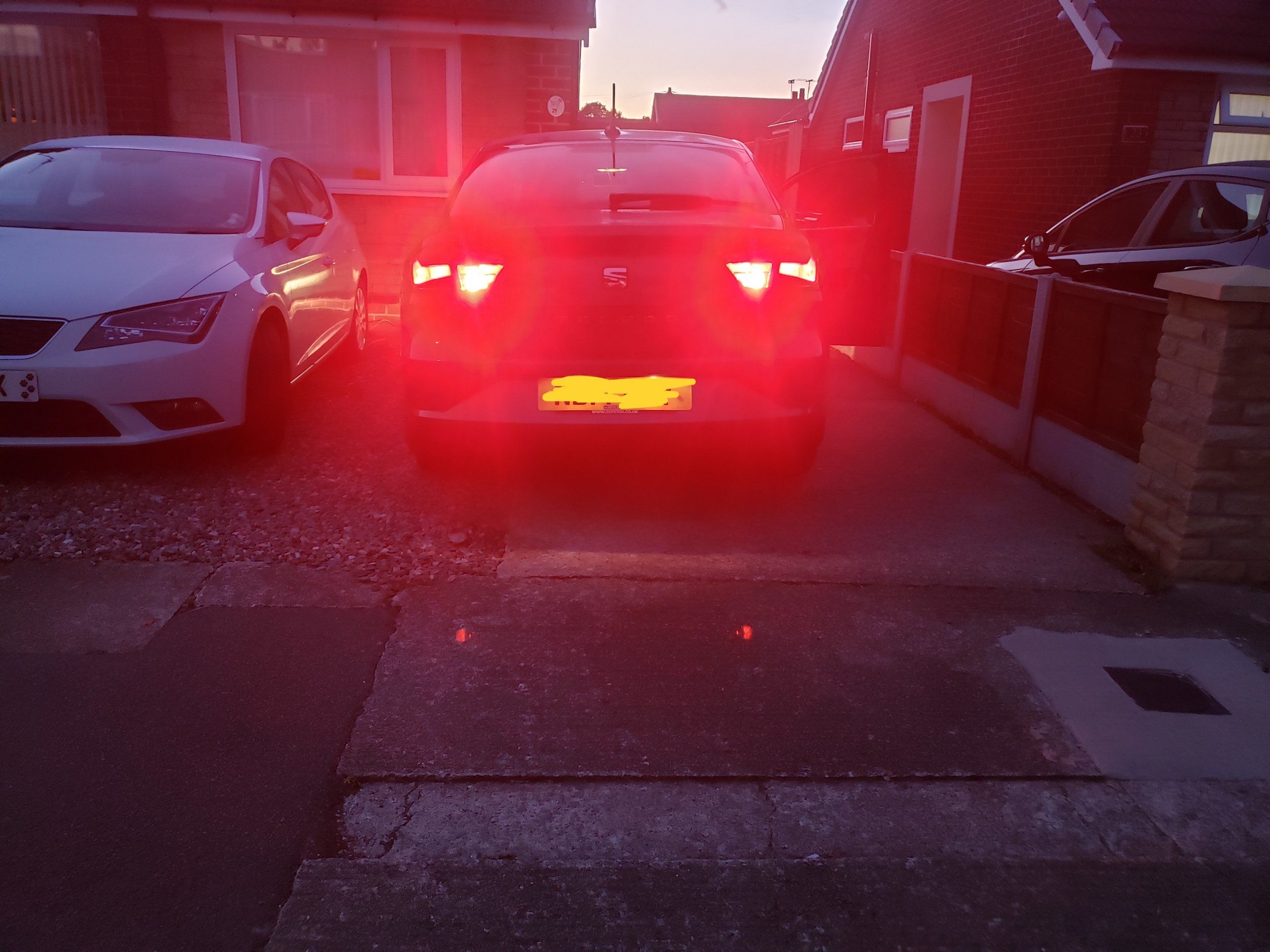

Managed to get the passenger side rear fog light working on the Toledo today. No facility to do it with coding, and had to drill out the light cluster to accept a bulb, but using a transistor relay which switches at less than a milliamp and therefore not affecting the canbus, I've managed to take the power from the constant ignition live of the rear wiper motor. No errors whatsoever, and everything working great
