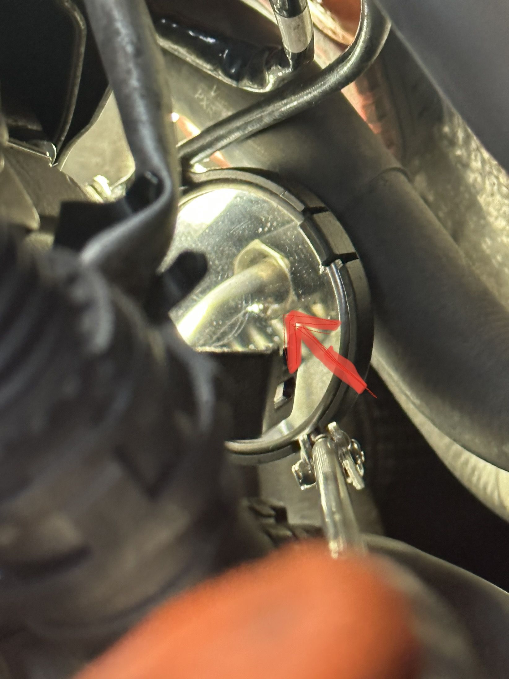

the leak and he seen a few drops come off this area (Flange bolt I believe he said). I have a photo of the area. This is the same area where the copper washer was replaced. In the image I’ve attached were the pipe goes into that socket area. The mechanic that inspected it today seen drops of oil coming from the place I’m marked on the image below. yes I’m just lost with this all and I was wondering if anybody else has had any similar issues ? The car drives fine nothing seems different etc but it’s got a slow drip of oil and it’s definitely seems to be coming from the turbo area.

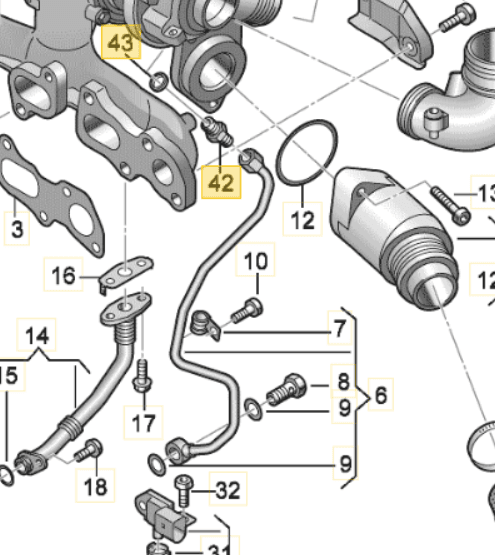

The banjo is the lower joint.
The joint you are looking at in the mirror is the upper threaded pipe joint - number 42 = 059145911A
One end has an copper washer (43) - the other end of the union is a flared seat like you get on brake pipe. Could be either this washer or contamination of the flared seat? or maybe it just wants to be nipped up?

Depends what access is like?
I would probably check it is nipped up first if easy enough access?
But if you have to remove a load of stuff to get to it - then would be safer just getting a new union + washer while you're 'in there' - and check the end of the pipe is clean.
Hi again , do you have the part number for the washer that goes on to number 42 ? We’ve identified the leak is deffo coming from my original image and the mechanic looking at it now said it wasn’t even tight so figures crossed it just needs nipping up.

Ok so we’ve seen a leak coming from the area confirmed seeming the copper washer has failed and when we was watching this on the ramp you could see the oil building around the washer when the engine was running and after a few second drip off. We then changed the washer and tightened the bolt up as the mechanic dealing with this said it wasn’t really on tight.
We then got this back on the ramp with the engine running and watched the same location for a good 5 minutes and nothing seemed to leak through like previously so fingers crossed this solves the issue
