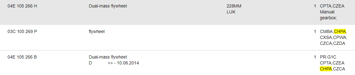

What is your engine and gearbox code? I can check what flywheel fits?

The flywheel for the manual CHPA 140ps part number 03C 105 269 P is solid/NOT dual mass
The automatic and the 150ps version have DMF.
You have springs in your clutch plate so I guess this could rattle/knock if worn.
How many miles has it done? First I would change the oil if this hasn't been done/unknown.
