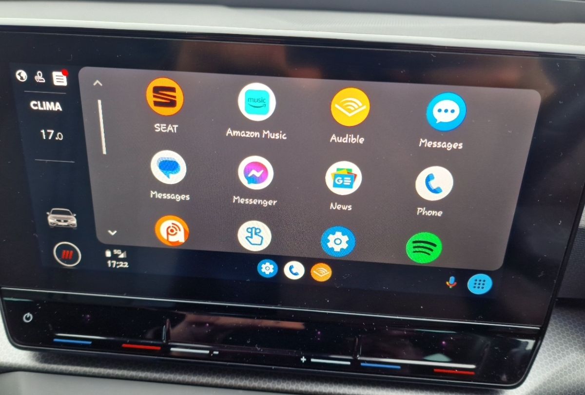

Take a picture of what you do see when you have Android Auto on the screen.
Chromedome
Chromedome
Apr 12, 2023
23

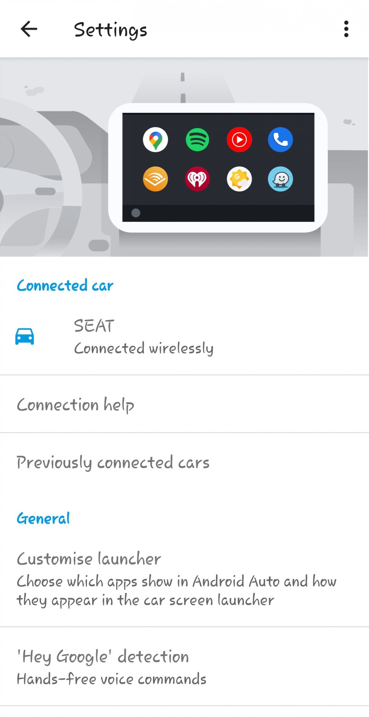

Screen shots of my phone screen and car screen.

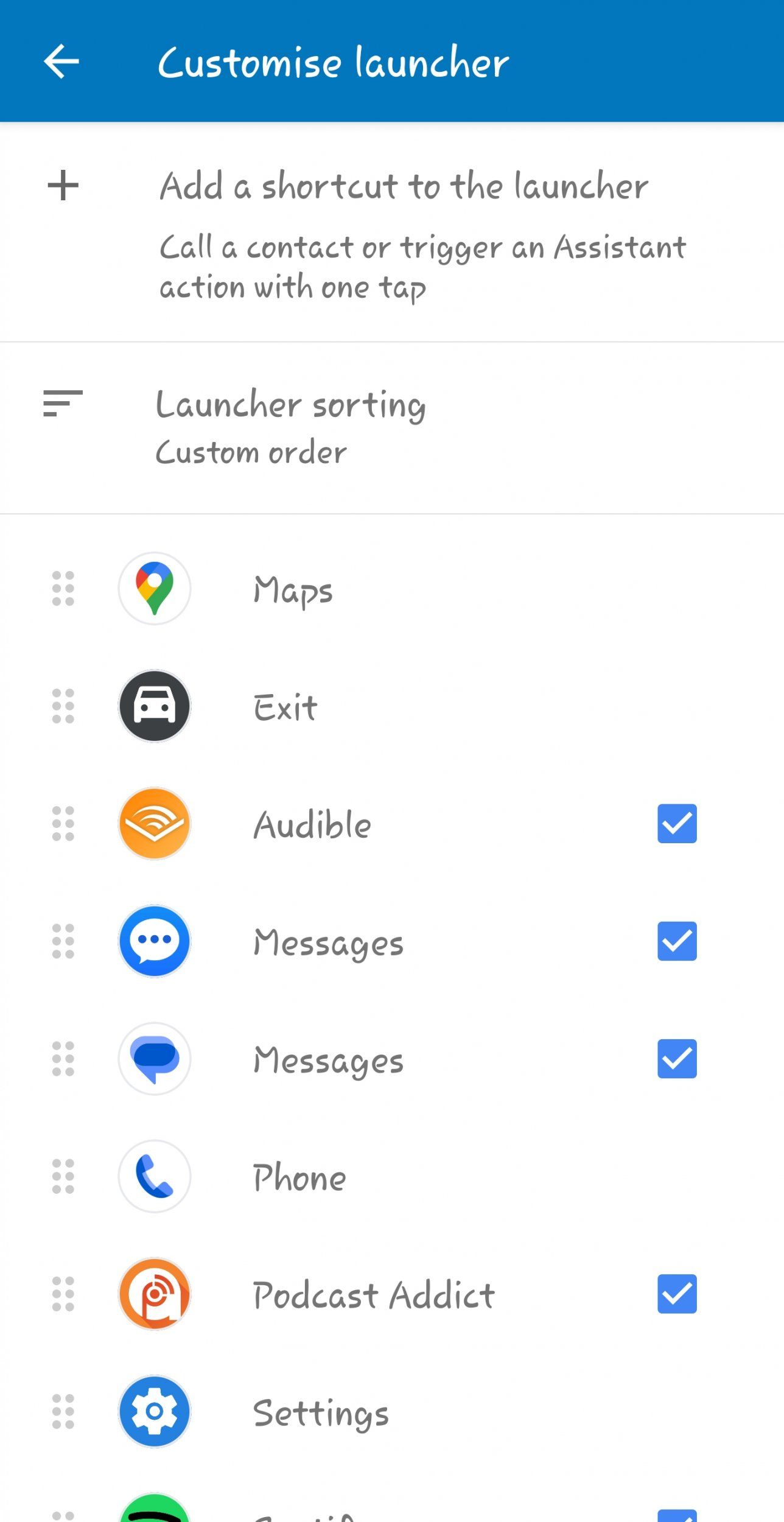

Scroll down. If maps is not there, click on Customise Launcher on your phone (see your phone screenshot) and enable it and move it to the top.
Chromedome
Apr 12, 2023
23
google maps is in customise menu but i can't select it.
