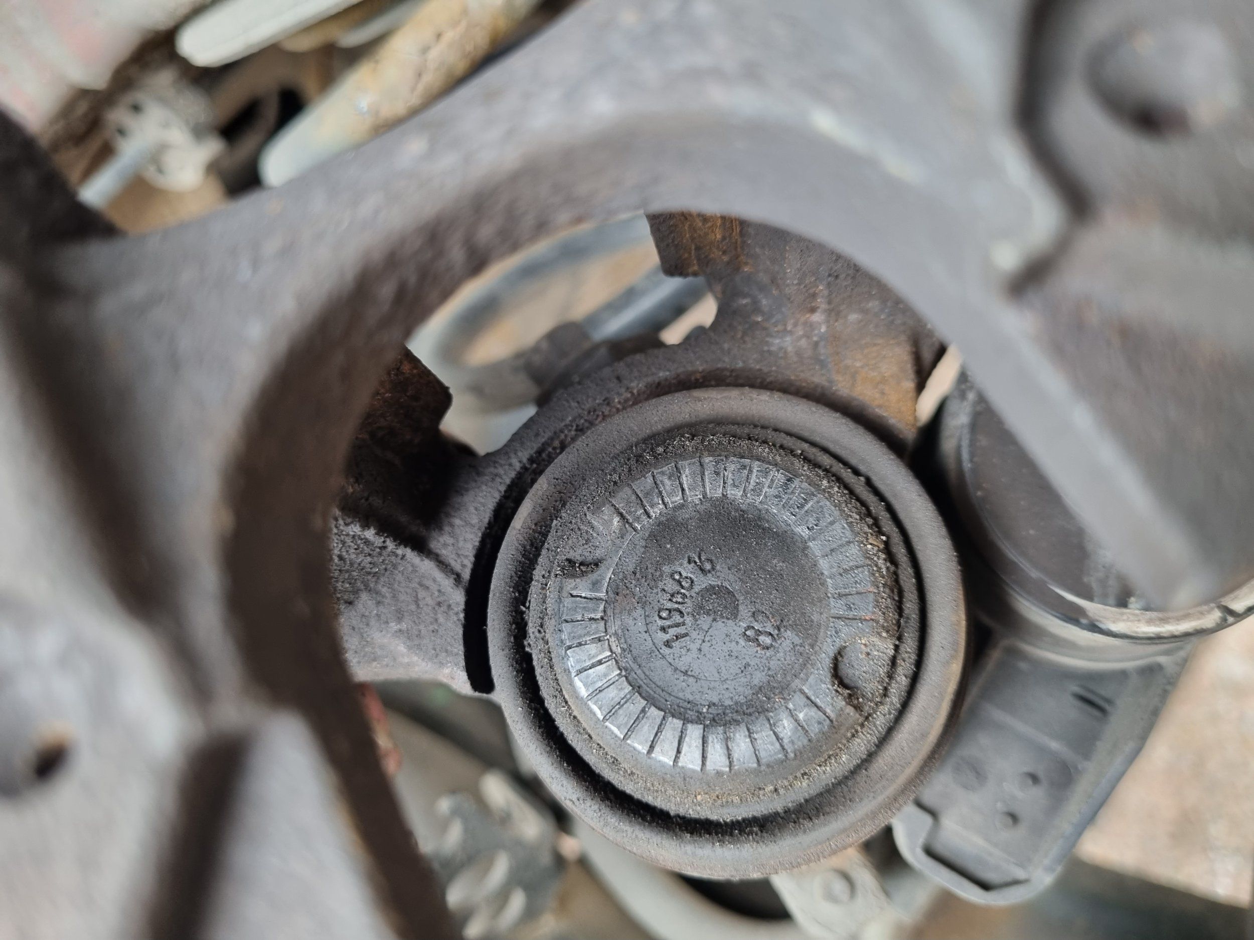

I've only ever done this on a 2011 Audi S4, and I'm sure that VCDS had a dedicated "task" for doing this and so did not create any fault codes.
I'm using an older version of VCDS which may be the issue.
I'm guessing that some levels of Leon with electric handbrakes do not need the pistons rotated while being pressed back, and some do
These ones didn't need to be rotated while being pressed back in, even though they had the marks for the tool as seen in this picture:

Yes, a bit misleading when the ends of the pistons have these 2 rebates to engage a piston retraction tool! I have used a piston retraction tool on lots of my VW Group cars - always with the adaptor side that grips these 2 points, but when I bought my 2011 Audi S4 slightly used, I bought a specific adaptor for later VW Group cars that had another sort of "gripping" arrangement, but after retracting the brakes a couple or so times to clean them up, I got round to considering that no further action was required when fitting new discs and/or pads - but then read that the pistons needed to be properly "zero'd" when fitting new pads - time will tell if on that version of "rear brake calliper with electric handbrake facility" that the 2011 Audi S4 has, needs just pressing in after retracting, or pressing and rotating after retracting. I felt the need to comment on this seeing as it was created as a resource and one that Cupra folk might use, and so adding in a bit of caution wrt to how to achieve the final "zero'ng" of the rear pistons. I'm sure that most people could look up the workshop manual that is on this forum for confirmation wrt the Cupra - I should have before writing this!!

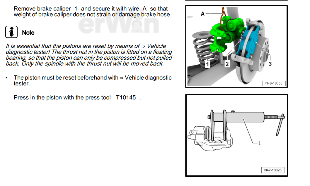

I've just double checked on this as you had me thinking about it again. According to the repair docs, it's the same for multi link/live axle variants. So in either case, the piston just pushes back in without the need for the piston to be rotated at the same time:

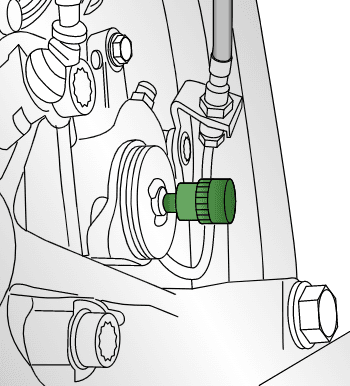

Thanks for clarifying that wrt the Cupra - in the past I have used my piston rewind tool, with a bit of wood between the rotating end and the piston end to retract normal front calliper pistons without forcing the piston to rotate, but I also now have a second simple pad "expander" which might be strong enough to move the Cupra rear piston in after the handbrake motor has been retracted electrically.

No need to rotate the rear piston on either A4/S4 EPB or any Leon with EPB.
The act of plugging in the diagnostic VCI and 'activating the EPB function' and selecting 'open caliper' electrically winds back the internal screw within the rear caliper - leaving the piston free to be pushed back like any front caliper piston. (apart from some Citroen's how had the handbrake on the front caliper :oops:)
Easiest method to push pack the piston is using a large straight screwdriver in the slot in the top of the caliper to lever the old pad against the piston.
Just to note - you can manually wind back the piston screw on the back of the VAG(TRW) EPB in an 'emergency procedure' by disconnecting the EPB connector and using an allen key - but you still need a diagnostic VCI to perform the brake re-set function so this is only useful in an emergancy!
Pushing back any caliper piston shouldn't need much force. You are only pushing the piston back past its seal and pushing the fluid back up the line.
If you need need to strongly push the piston back with quite some effort - I would be suspecting you need a caliper re-build or new caliper.
Note: its good practice to crack the bleed nipple from the caliper and catch the excess fluid when you push a piston back so you're not pushing dirty fluid back up into the brake system.
